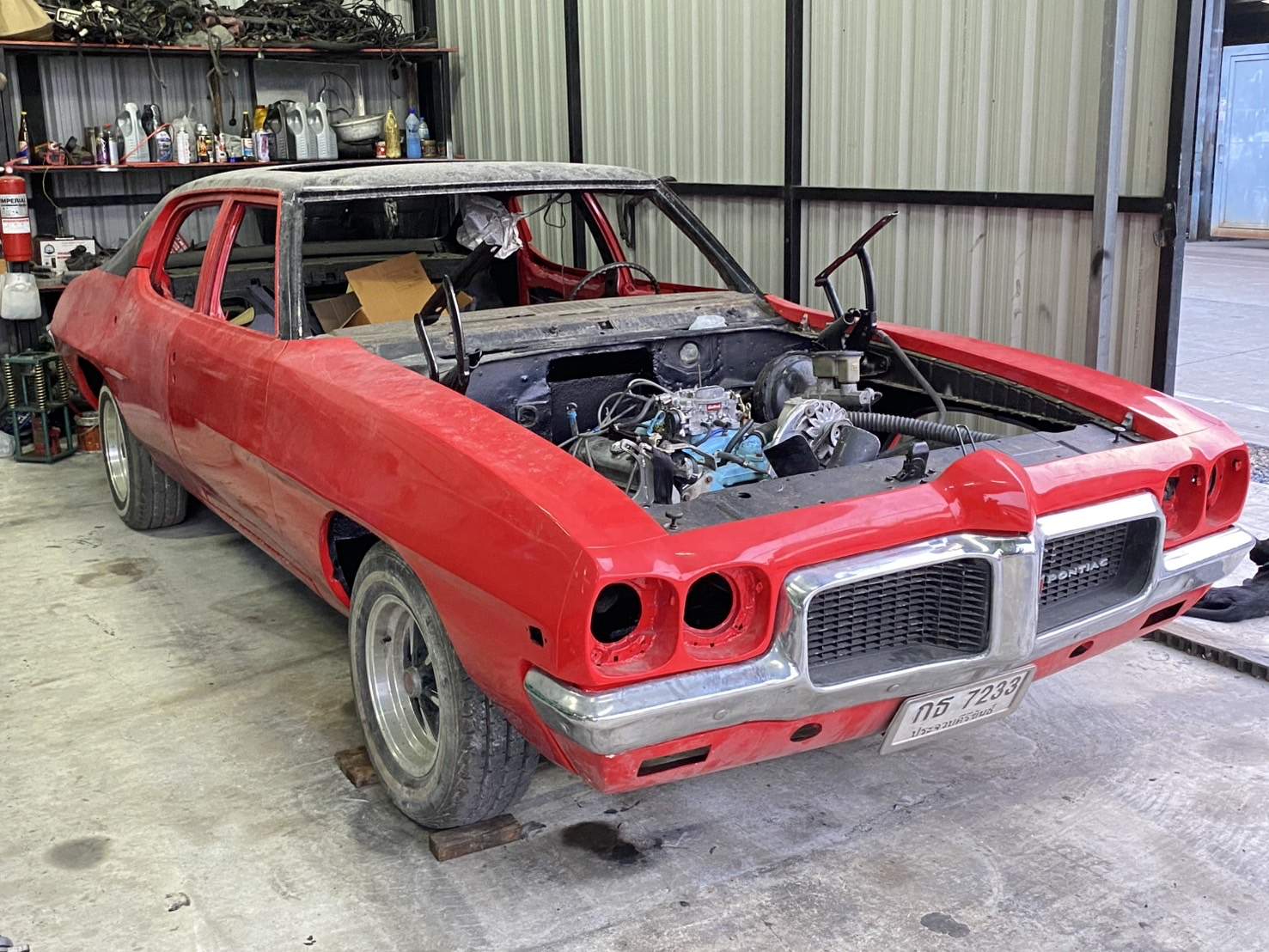

I have a 1970 Pontiac LeMans. The previous owner replaced the engine, but I don't know which Pontiac engine he installed. It's a 5736cc, 400hp engine, engine number 235690-B601630. That's all I know. I bought spark plugs for a 1970 Pontiac engine (R45S), but they don't fit. The diameter is 20mm (0.78 inches). I need 14mm (0.55 inches) spark plugs. The thread is correct, and the length is good. Do you have the correct spark plugs for me?
