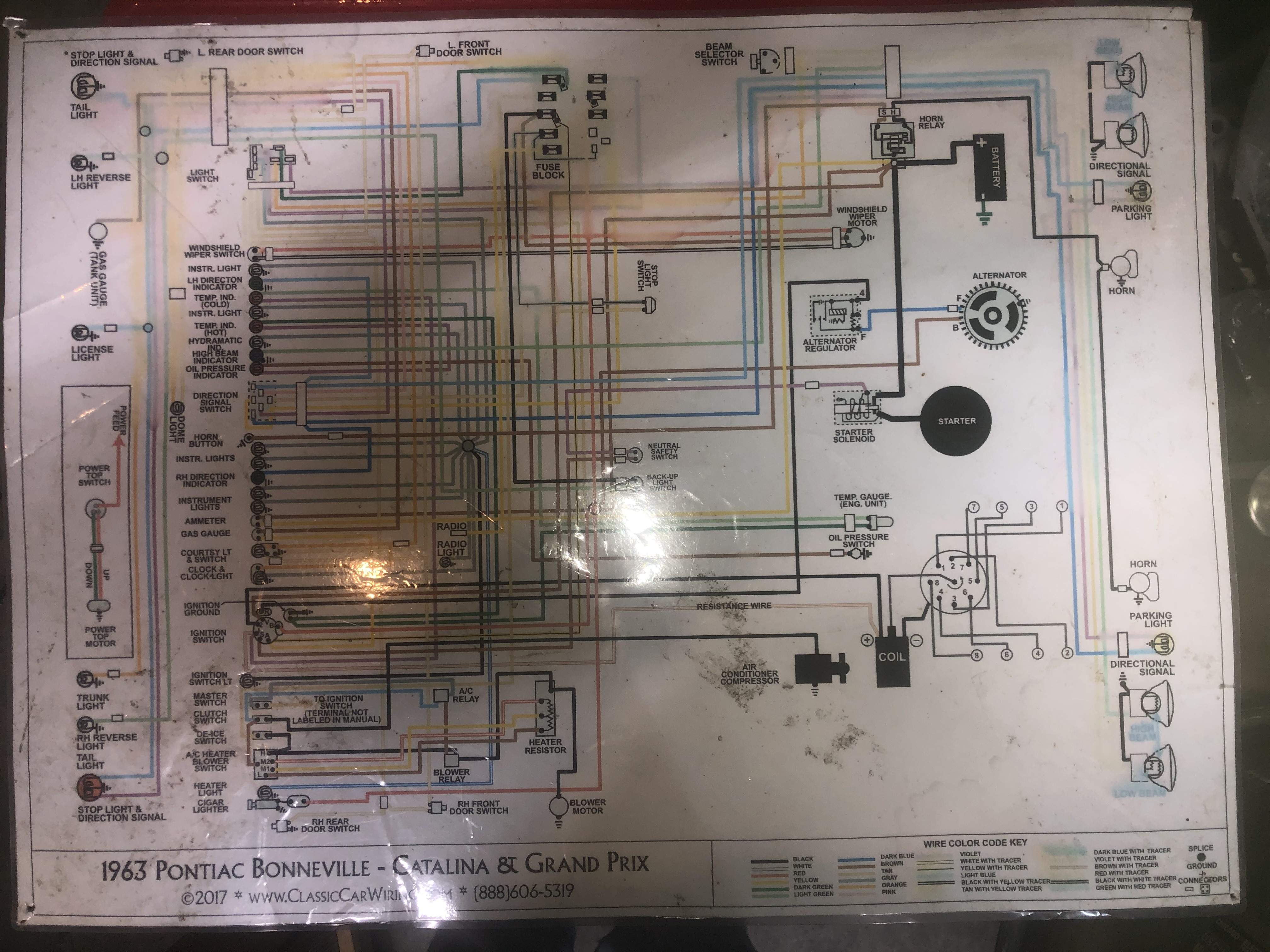

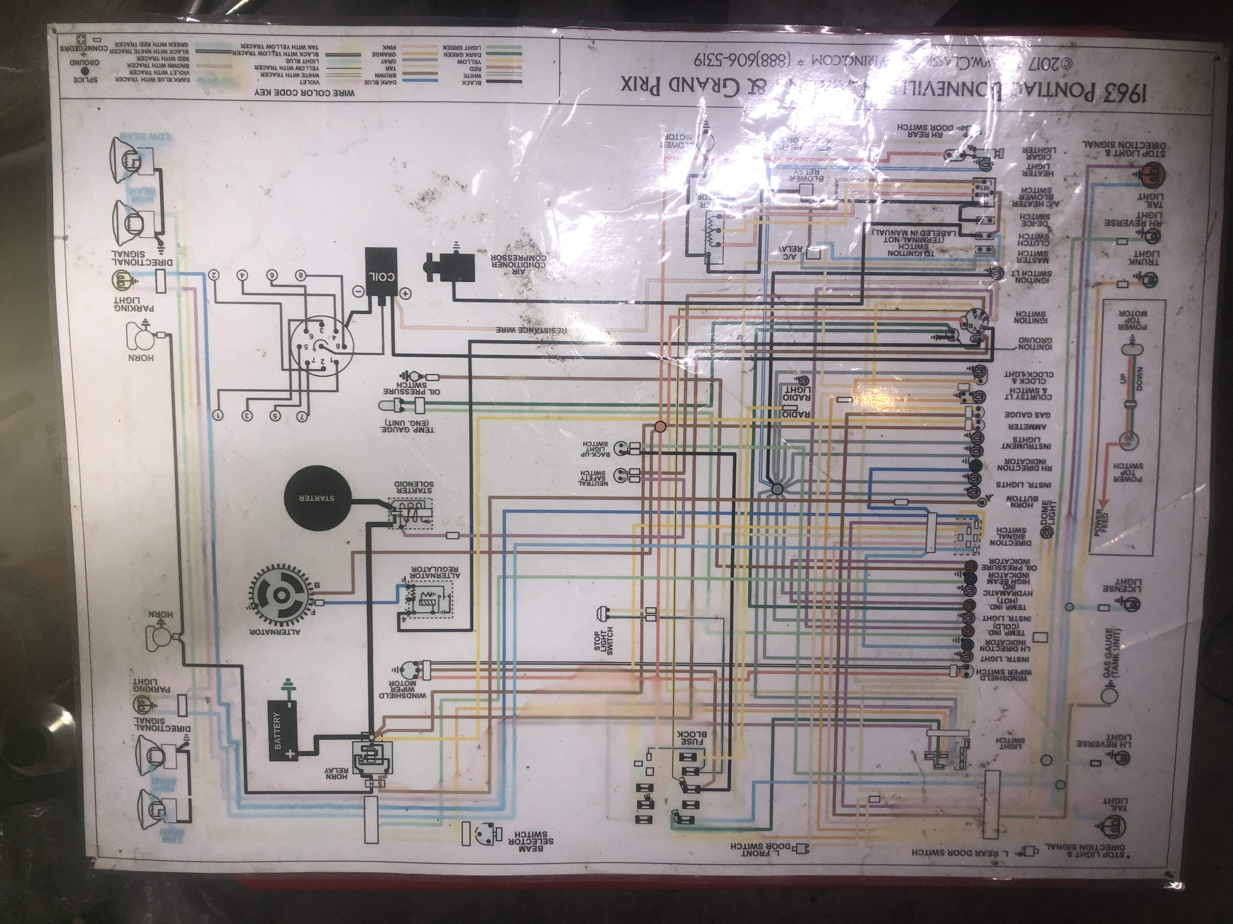

Here's a color schematic, not sure how much good it will do. It is for a 63 Bonniville, Catalina, and Grand Prix. Let me know if you need a close up of anything.
