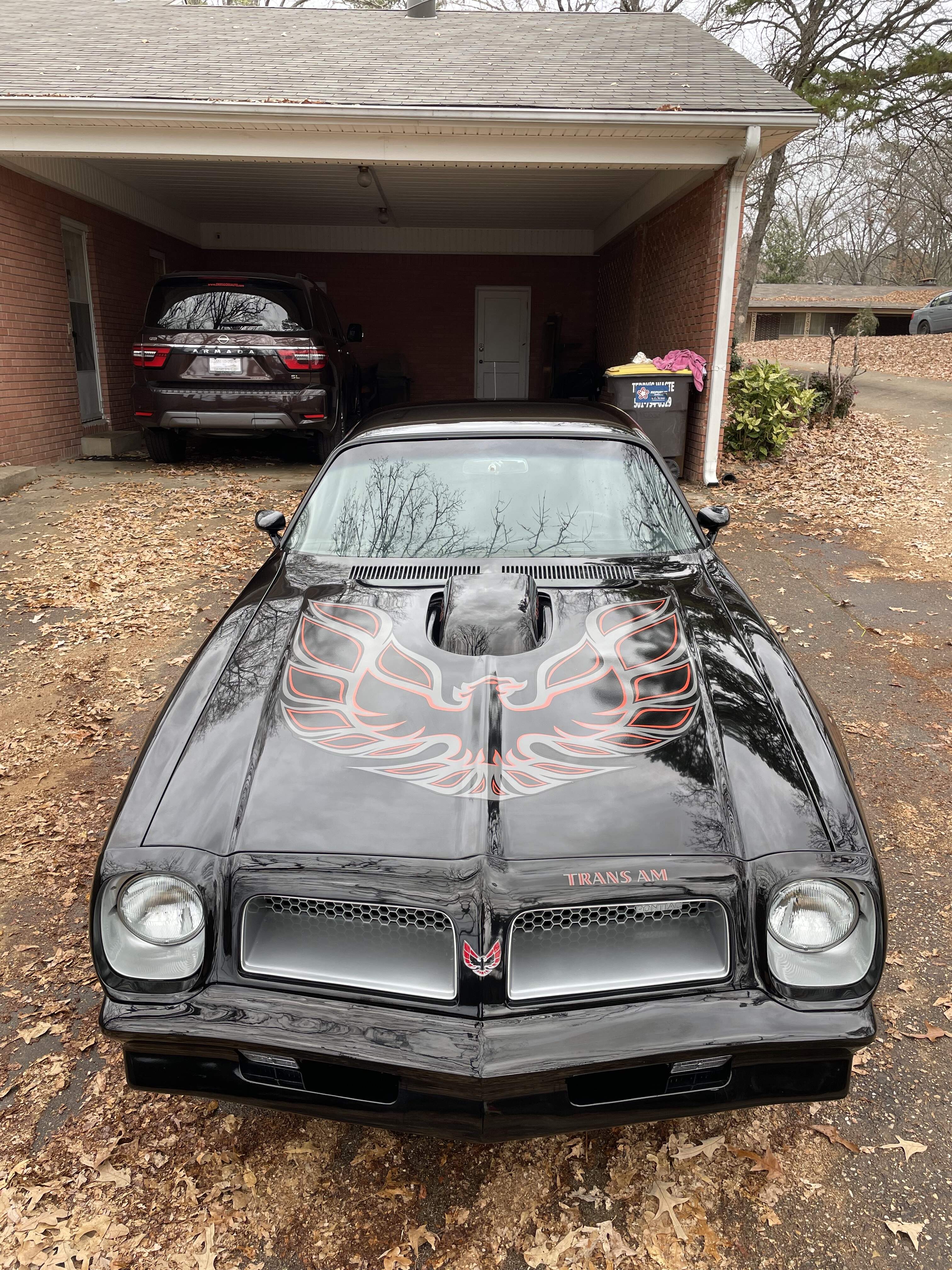

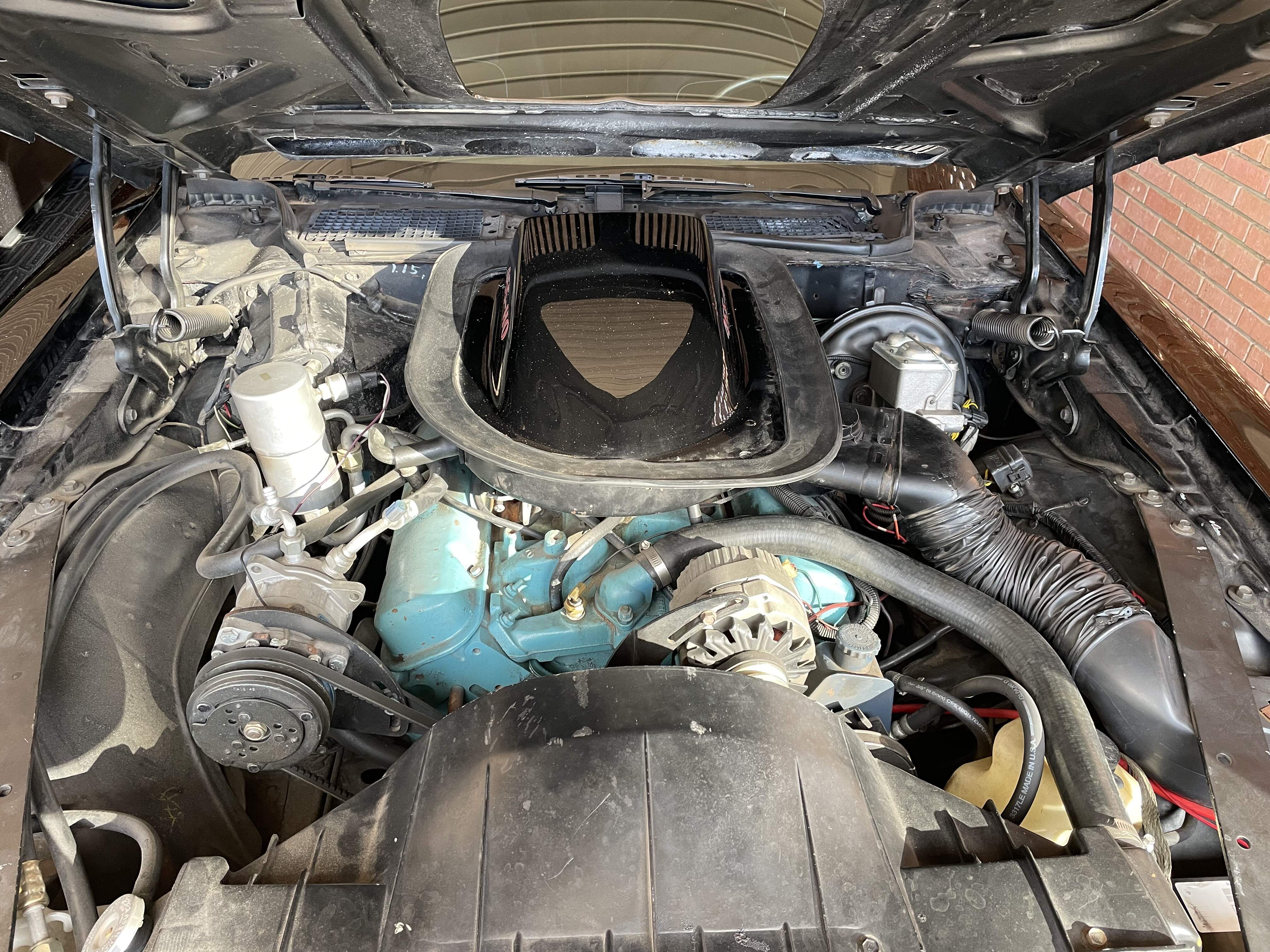

First post here. I recently bought my dream car, 1976 Pontiac Firebird Trans Am with a 455 engine. The prior owner kept it mainly at stock and appears to have only added a Fitech fuel injection system and duel exhaust. I am wanting to upgrade the engine but see a lot of posts stating that the engine needs to be rebuilt first before upgrades are added or it wouldnt be able to handle the upgrades. Is this actually true? Yes, the engine is old but it appears to be in great shape. Is it more of a better safe than sorry situation?

HI Foxcraft! Welcome to FP and the madness. What a great looking car! Thanks for sharing the pics. We love pics around here!
The 455 is a very stout motor. The question becomes what are you thinking about doing to the car or the motor?
If the car has a lot of miles on it (over 100k) then it might need benefit from some freshening up the engine and transmission.
If this is a low mileage motor, unless we are trying to add a power adder, then it should be fine - unless you envision some sort of strenuous duty in it's future. Examples could be autocross or drag racing.
If you think this is going to be just a street cruiser / cross country / Hot Rod Power Tour car, then only fix what needs to be fixed due to age, neglect, or wear n tear. A tune up, new oil/filter, new tranny fluid/filter, shocks. tires, flush and fill the radiator, etc. should be done to keep things current.
