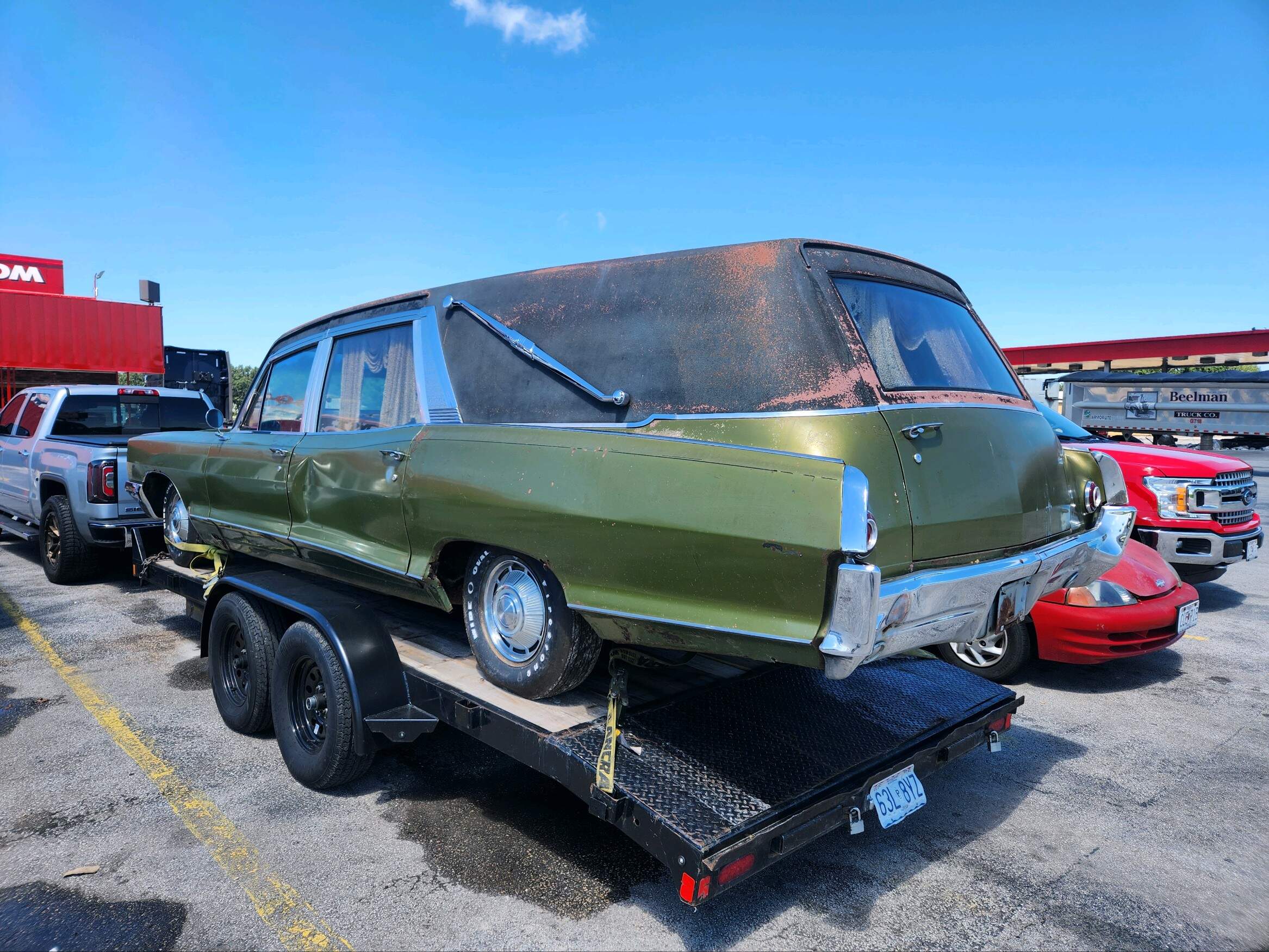

Hey- new classic car owner. I recently purchased a 1966 bonneville hearse.  She is a beautiful piece but she is showing plenty of rust on the frame. I have had some difficulty finding frame parts to fix that with. What frames are interchangeable (like what year/models were the same)?

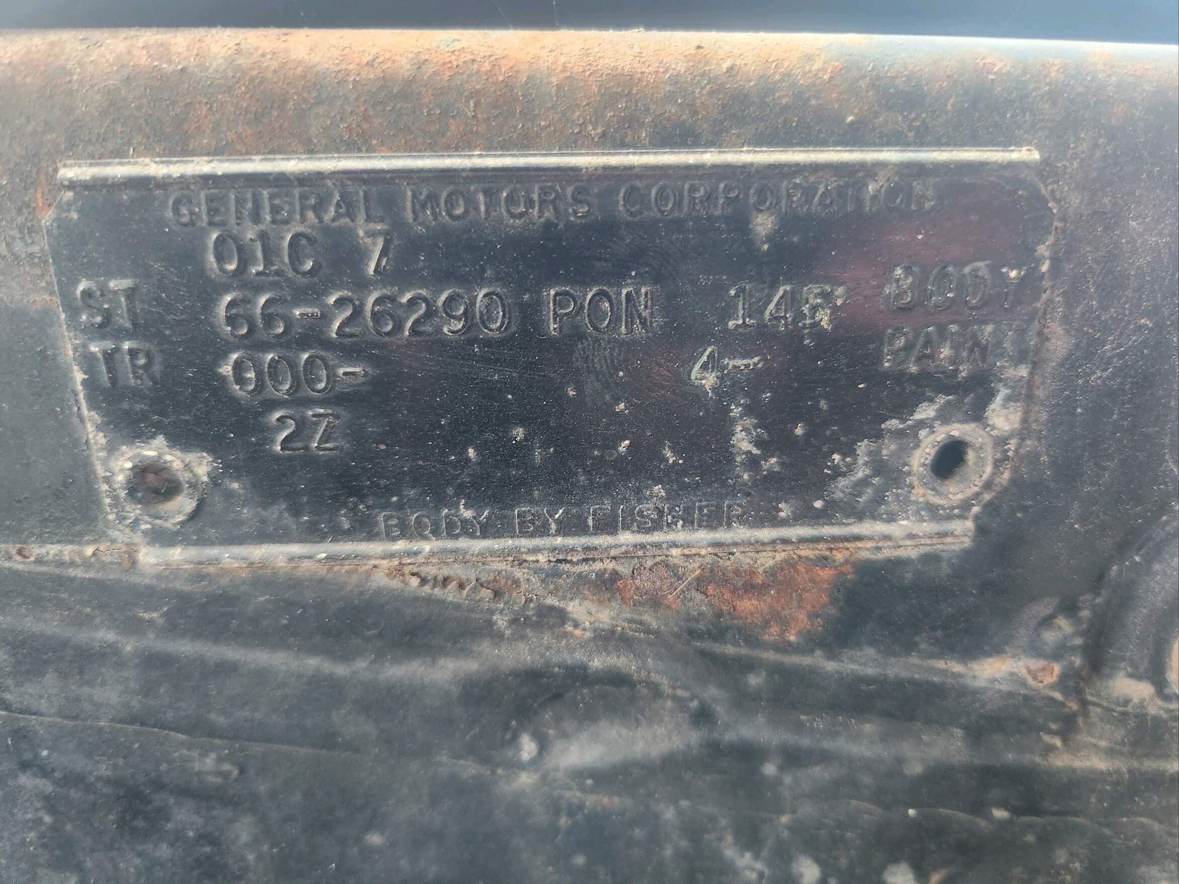

It is more than likely that it rides on a long wheelbase Pontiac commercial chassis (ambulance/hearse/airport  taxi..etc) which can be substantially different than the standard Pontiac station wagons...
Any detailed pics/specs...?? They would be helpful in determining what chassis/frame you actually have...Then can go from there...

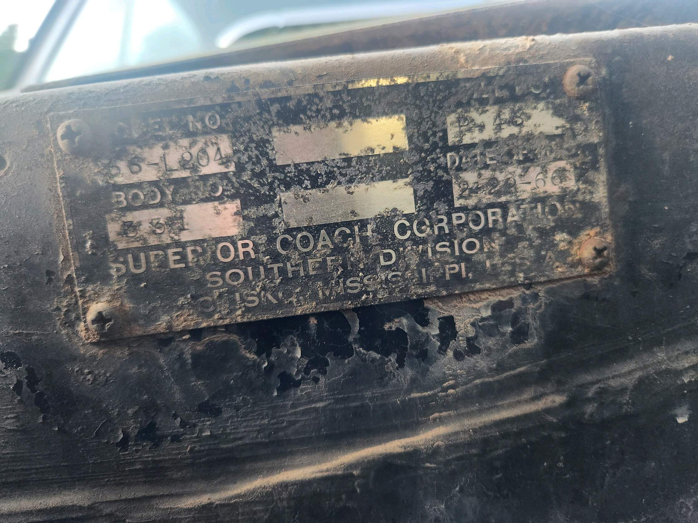

The body is by superior coach. I have emailed them inquiring information as well. From what I gather I believe it is on the longer wheel base and then extended, potentially at the back. I expect that some fab work will need to be done, but wanting it to be minimal.
The driver side frame rail is not salvageable.20230902_192402.thumb.jpg.125e8c074fe3433bfd95a5764af5f8ef.jpg20230902_191945.thumb.jpg.05e1675dc3a018856c19238331ccb888.jpg20230902_192134.thumb.jpg.3018ea44790b74ddb6a1fafb48e2ed57.jpg20230814_121741.thumb.jpg.7441444818d13ad45403306b62adff26.jpg20230814_121749.thumb.jpg.0dd0a5f1364d3009f5f48809f5969fe0.jpg20230814_121805.thumb.jpg.937720c0e756068ac956d3171ba5968f.jpg20230814_121815.thumb.jpg.b4faa82c9f66a883cdef3aa1a46fd3a6.jpg

I would check under your car. I suspect that when Pontiac shipped your vehicle to Superior Coach in Mississippi that it was an original 124" wheel base chassis. GM use to send commercial chassis (CC) cars out with the front clip and windshield installed and the doors, bumpers, and rear quarters were neatly packed onto the chassis since the coach builder would be adding the roof/upper body and detail out the rest of the car..
I think your hearse has had the chassis lengthened by Superior for hearse/ambulance duty. I would look underneath the chassis (front to back) for possible cut/welded extension pieces.
So depending on what you need, I suspect that you need to find a donor 124" chassis, preferable either a convertible or a wagon chassis. Convertibles have added frame stiffeners to support the car with the loss of the roof. A wagon chassis for obvious reason - it is the closest to your car.
