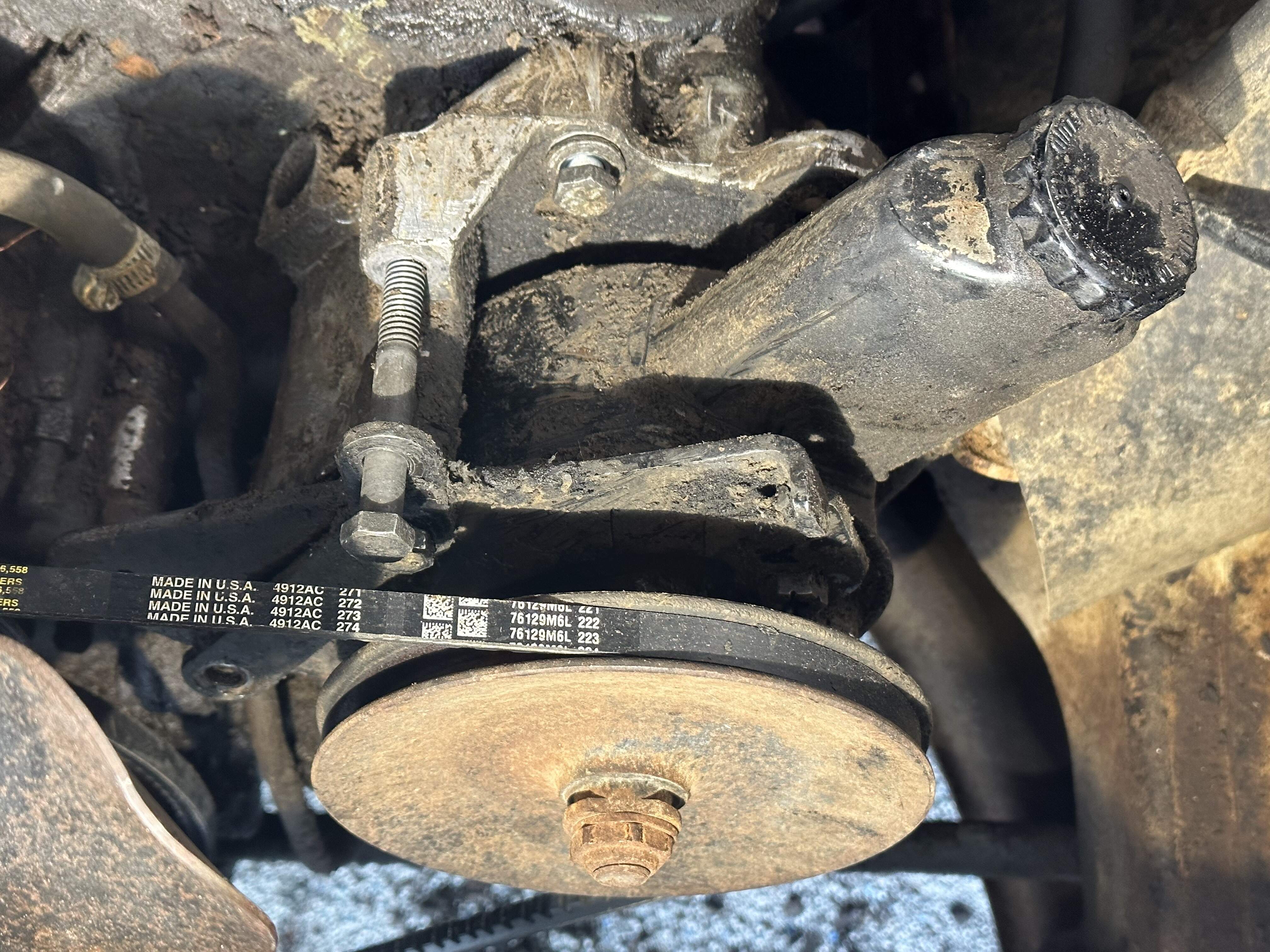

1968 Catalina power steering pump movement. I’m replacing the radiator and water pump in my ‘68 Catalina. I’m trying to move the power steering pump so that I can remove the belts. The engine is a 400 cu in with no air conditioning. I’ve removed or loosened all the bolts that I can see. I still can’t get the pump to move. What am I missing?

look on the back of the pump, there should be a bolt welded to the pump housing with a nut through that steel plate
