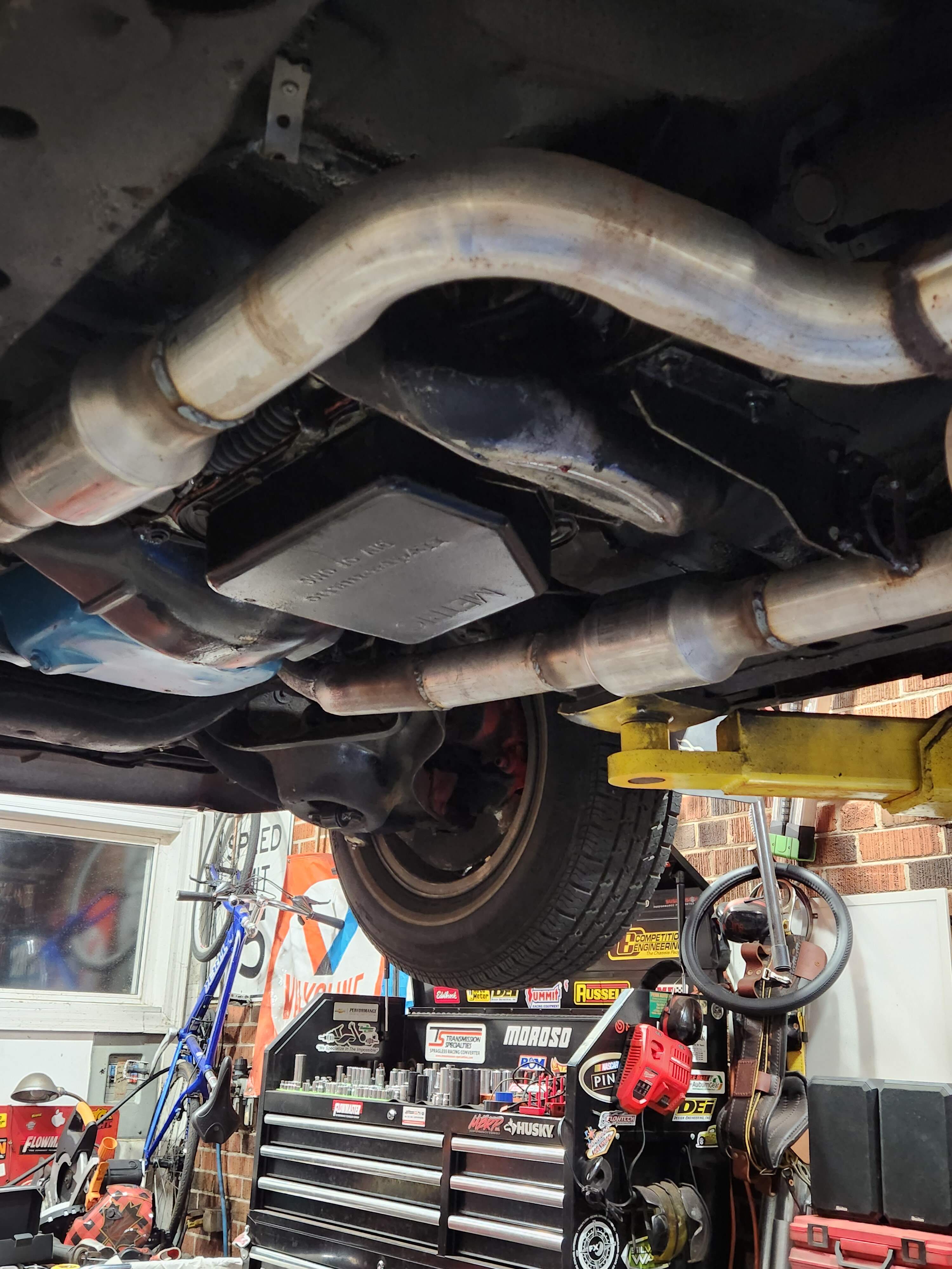

I hope someone out there can help me. I installed new 2 1/2 inch exhaust from the exhaust manifold to the the tailpipes. all new SS pipes with cross over and cats and  magna flow mufflers.
Car starts runs for a while then the one side of the cat gets beat red. car runs rough after wards. does anyone know what I have done wrong.

Does the car have the original engine..??
Generally red hot catalytic converters are caused by unburned gas dumped into them...Usually Due to an engine Misfire and not burning the fuel completely in one or more of the cylinders...Could be something as simple as a bad plug wire or spark plug itself....If you could give some more details...Might be able to help you norrow down some..

The engine is the original 301(4.9 ltr) engine. I have around 114000 km. the car is a Canadian car. I live in Ontario Canada. I have had the car since new. I will get the spark plugs  and wires looked into before removing the cats.

That was the old skool way of testing for a plugged cat.  Get it warm at night and look under the car.  Replace if it glows. Also check flow from exhaust tip with your hand to see if there is a difference.  Did you install??? Can you check to see if flow is in the right direction?

Just want to thank you all for the great advise. adjusting the car, replacing the spark plugs and adjusting the fuel mixture worked.
