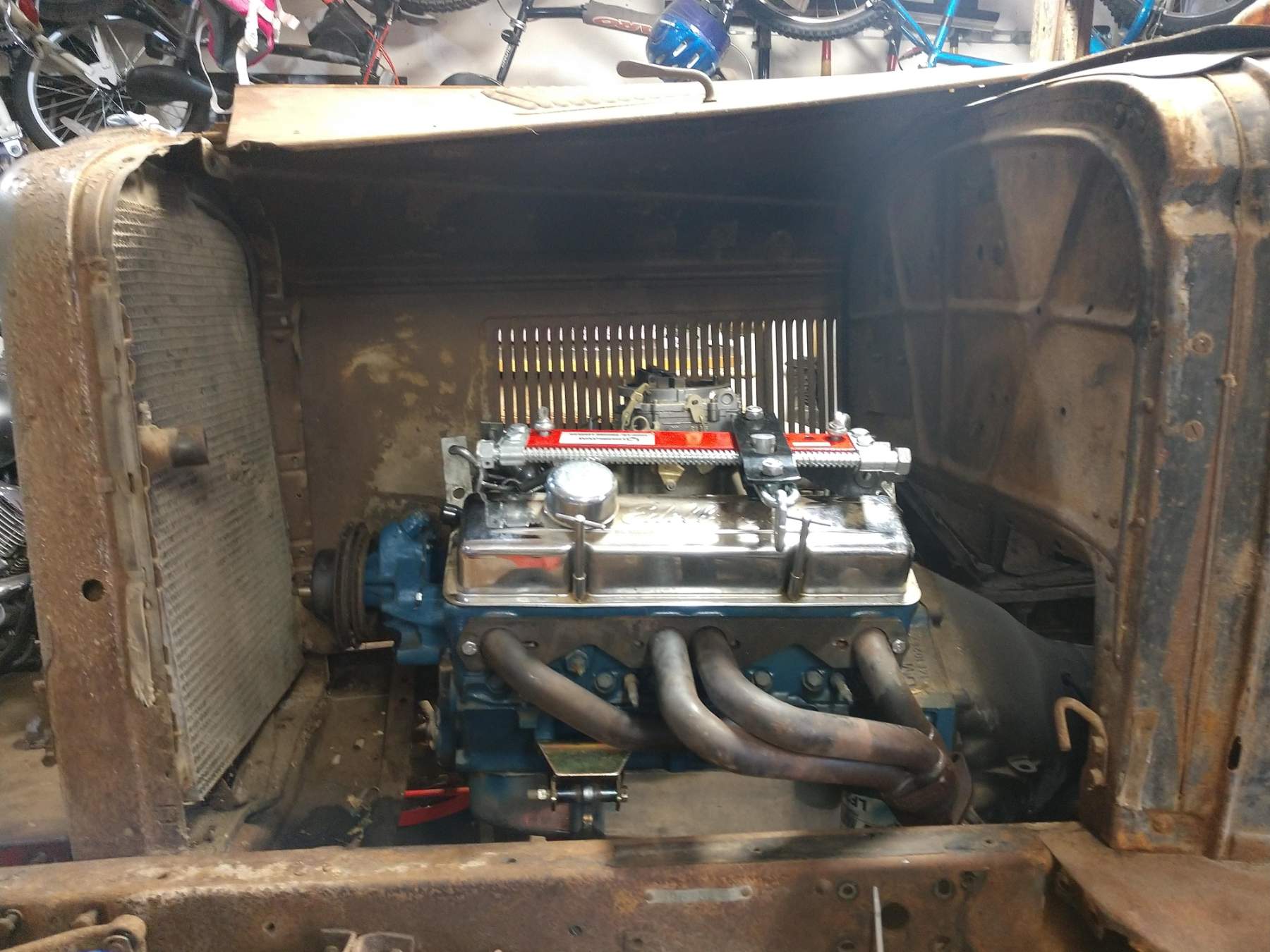

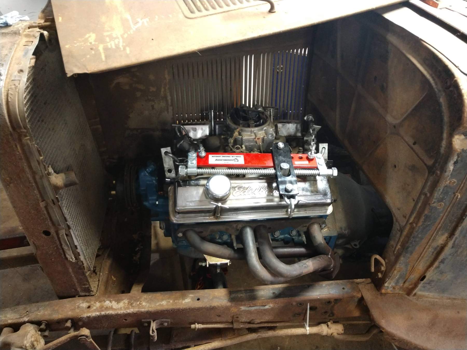

Here are two pictures with the 350 installed with cross member. The attached headers will not be used as they do not drop in the right locations. We plan to go old school and use rams horn manifolds. As we had a set laying around. Plus they will give us more clearance for the steering.
