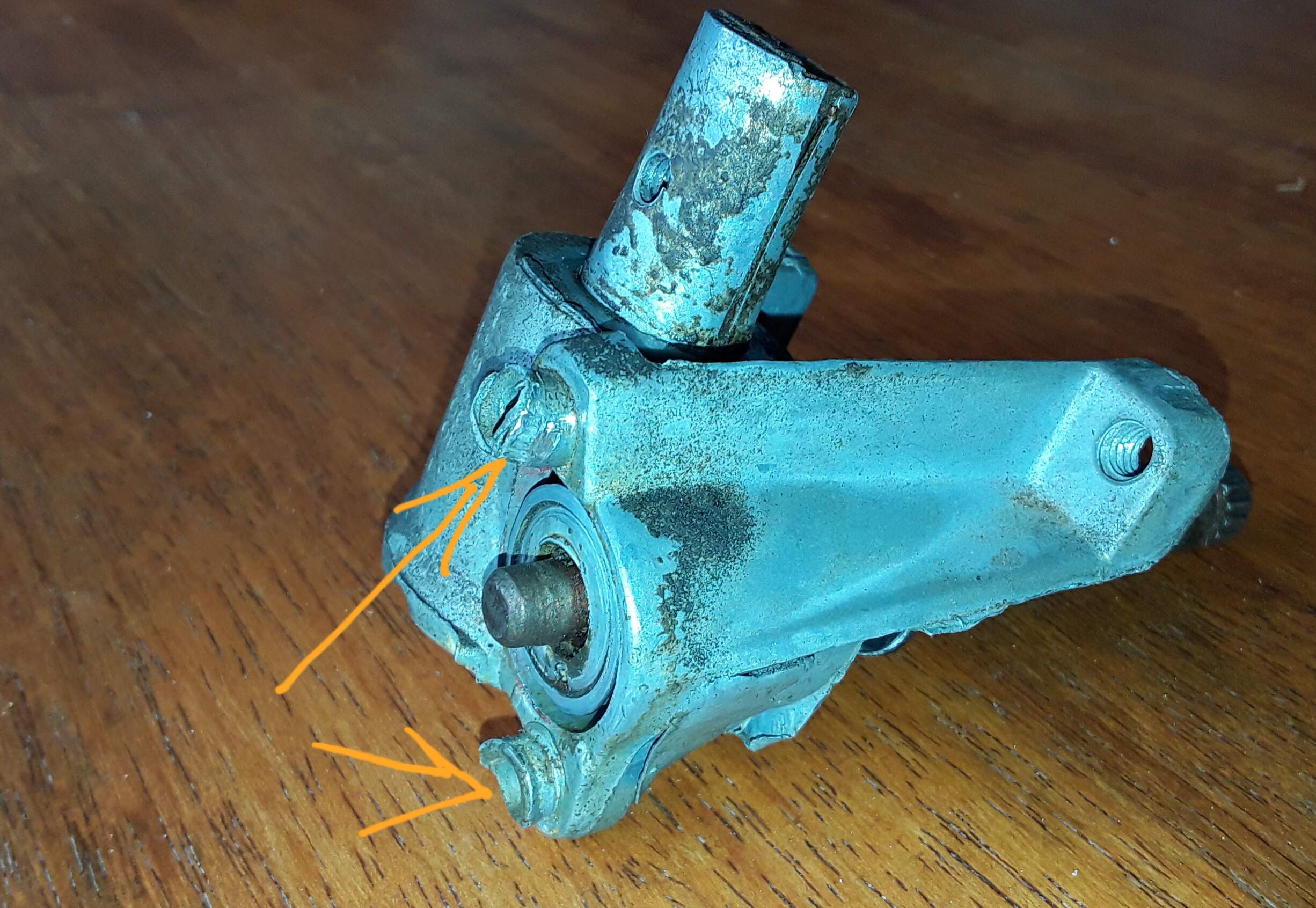

Hi Guys, Tightass Time again. I noticed that my driver's vent window winder wasn't doing it's thing.

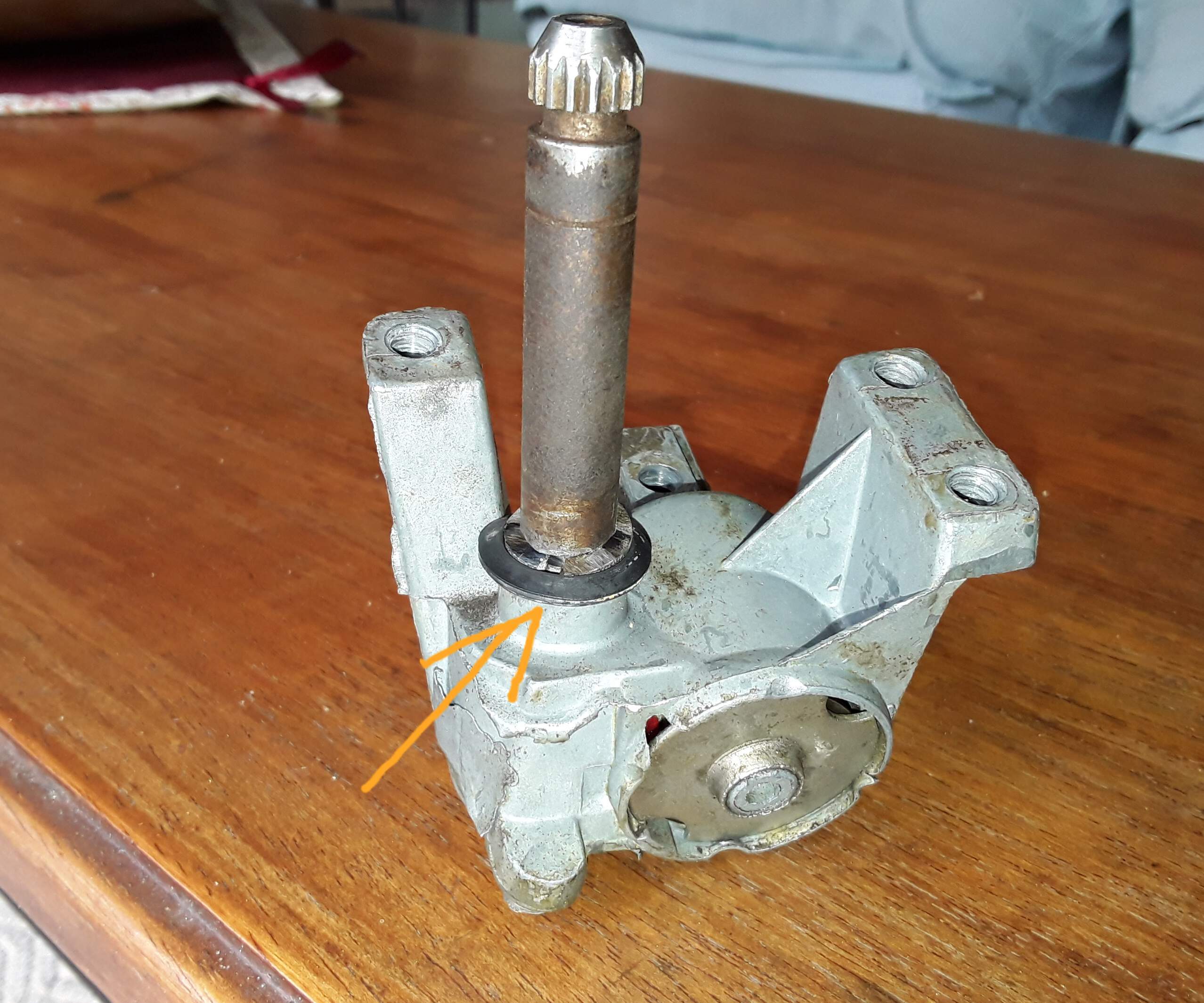

Ames wants $40 for a replacement. That's reasonable, but converted to Aussie dollars plus shipping, the price gets up there pretty quickly. So, I peered inside the door panel and undid the 3 bolts plus one other and out came the old winder unit. After I played with it, I could see the problem. There's obviously some sort of retainer that stops the spiral gear from winding itself out of the housing, but it appears to have broken off. (See first photo.) So, I marked where the shaft abutted the housing and removed the shaft. I angle cut a groove into the shaft and then squeezed a spring washer in there, which will do exactly what the retainer would have done. Total cost: zilch! Cleaned out the old grease, lubed and greased the gears, and now it happily winds away.20200426_162351.thumb.jpg.333a20d0e70815e2437c86f1d402a32a.jpg20200426_162318.thumb.jpg.f807e419961115671da0ab2efce6522a.jpg
