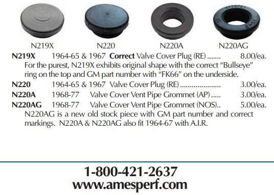

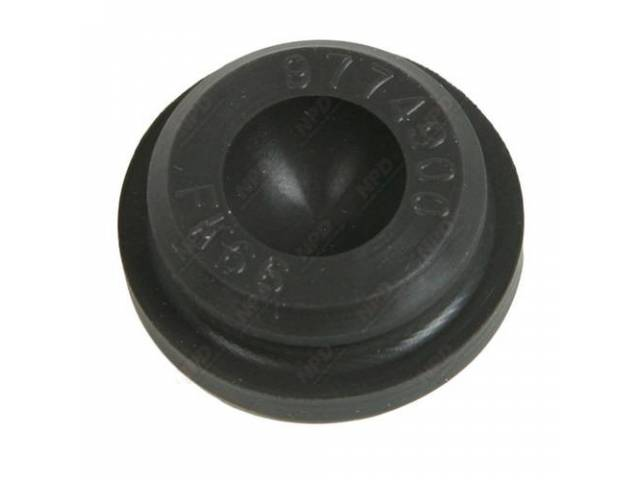

Fitzy - they are readily available from the catalog companies and they are not that expensive. Just search for valve cover plug.
Here is one example.
https://www.npdlink.com/product/plug-valve-cover-hole-oil-filler-tube/182136?backurl=search%2Fproducts%3Fpage%3D2%26search_terms%3Dvalve%2Bcover%2Bgrommet%26top_parent%3D10000%26year%3D
If you can't find one at your local Auto Parts Store, almost all the Pontiac Vendors should have them.
