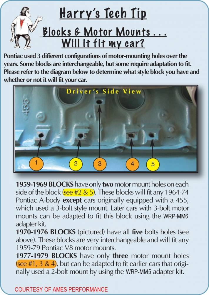

I think this chart will answer your question concerning the block.

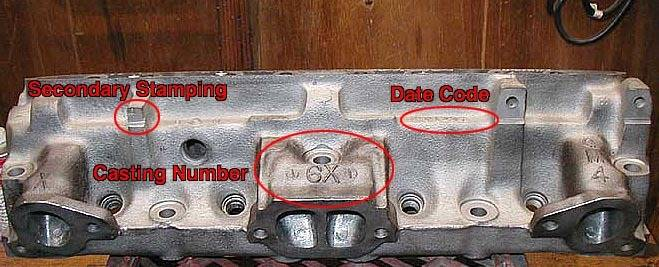

As for your heads, you would have to tell us what casting numbers you have for your 350 and 400 engines or physically look at the exhaust ports.

THANKS for chart/table/pix. OK, the plot thickens---my existing '76 350 should have the 5 mount holes (presumably all drilled?)--but I'm now unable to verify such, as I cannot get/see under car. It also looks like I now have some kind of custom mount(s)--as this engine is now in my 58 Bonne.  I don't know whether 2 or 3  mounting holes are now used... I do not yet have a 400 engine, and was now seeking some heads-up info as to what year(s)  engine I should look for to facilitate such a swap.
As I don't have the car at my house, I'll try to check head Casting No. the next time I can get to car and sneak a peek!
