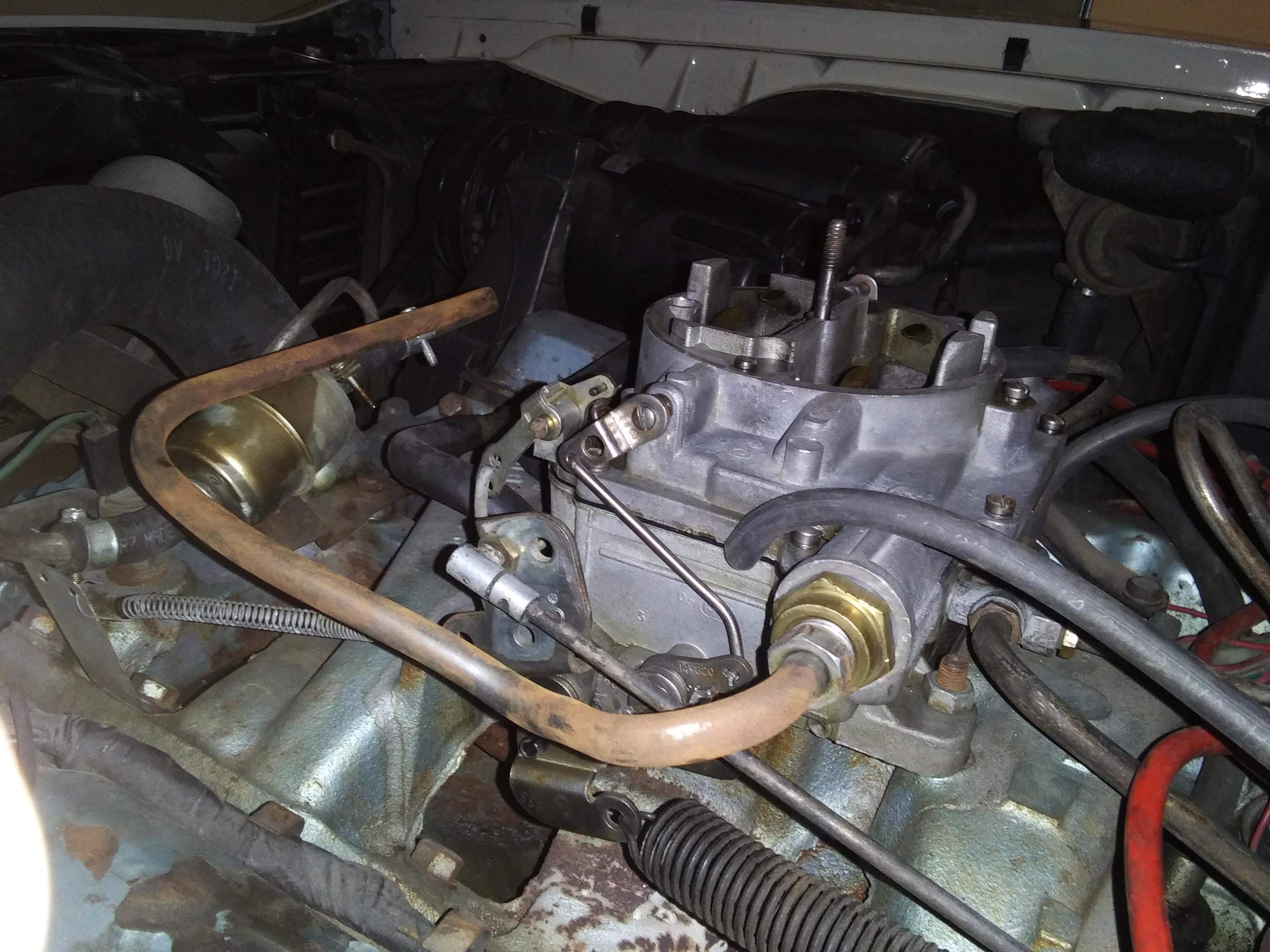

I'm the proud owner of a '67 Grand Prix convertible. I recently had my carburetor cleaned, and now the headlight curtains don't work anymore... the vacuum line is disconnected but, I don't see where to connect it.
I see the line to the brake vacuum canister, the advance line but... what am I missing ? (the line to the headlight is the one at the front).

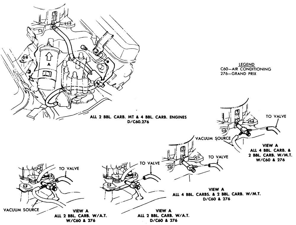

I went looking to see what I could find on Vacuum hose routing and didn't see much.
This is the only Diagram I came across that may offer some insight to hose connection points.

Anyway I hope this diagram helps.
Cheers

Thanks a lot ! So indeed I will need to buy a T because from the vacuum port, there are already the vacuum canister for the brakes (works fine) and for the advance (works fine too I guess !).
