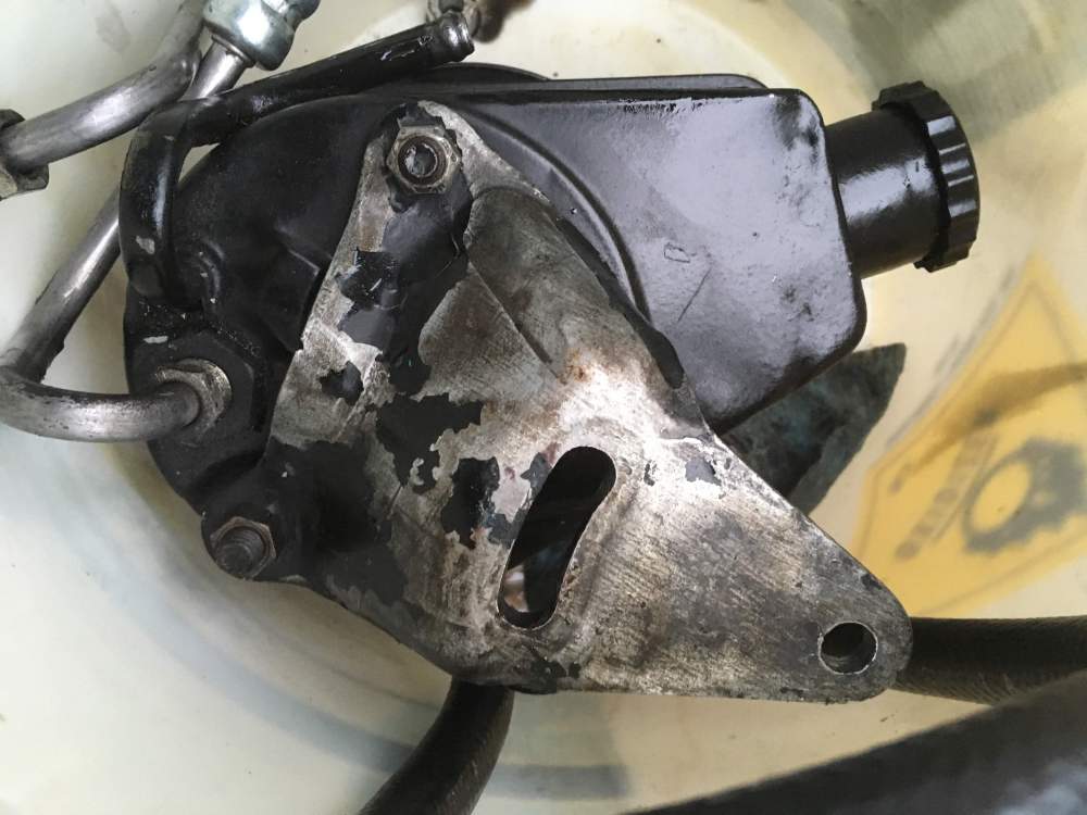

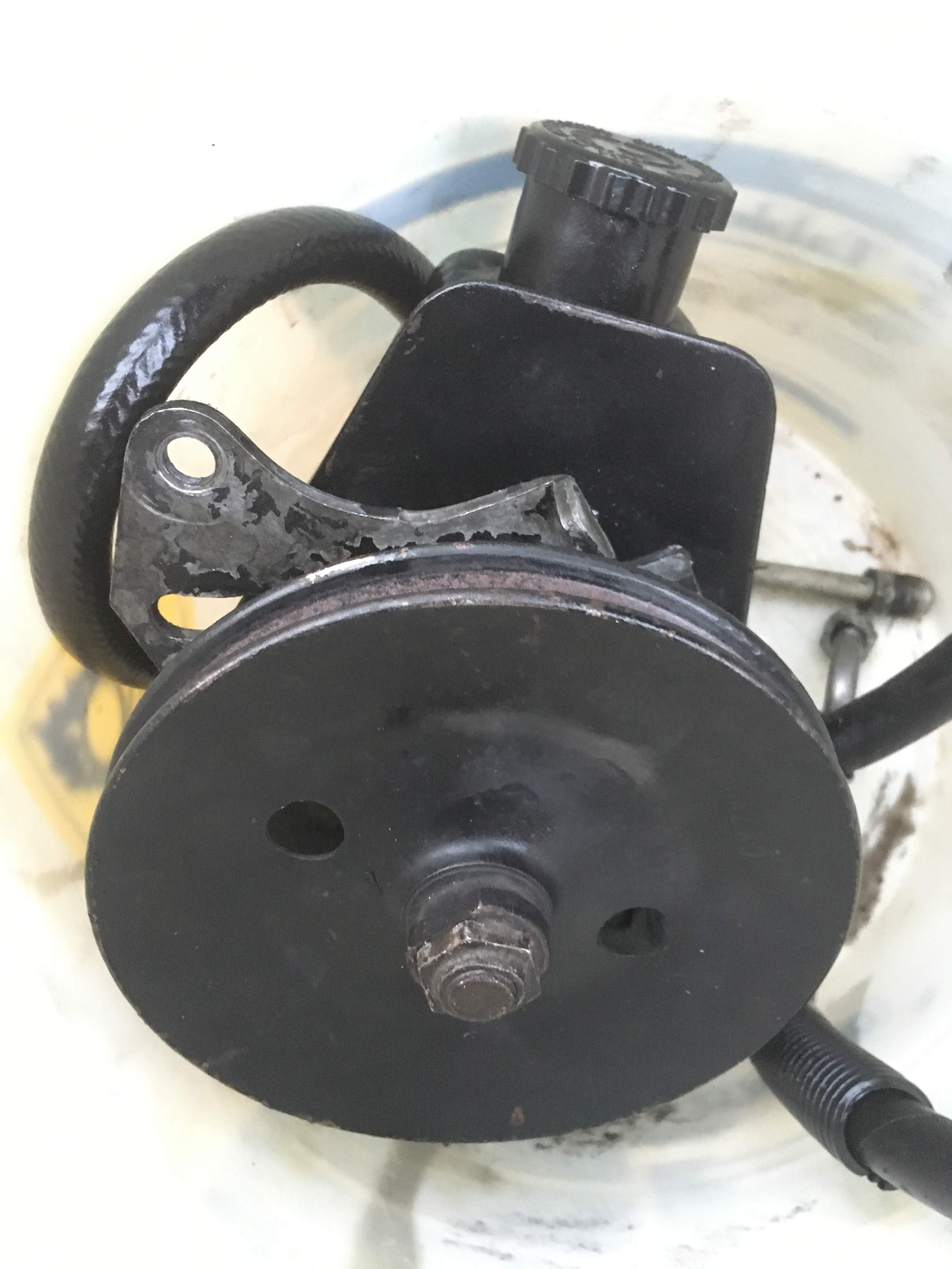

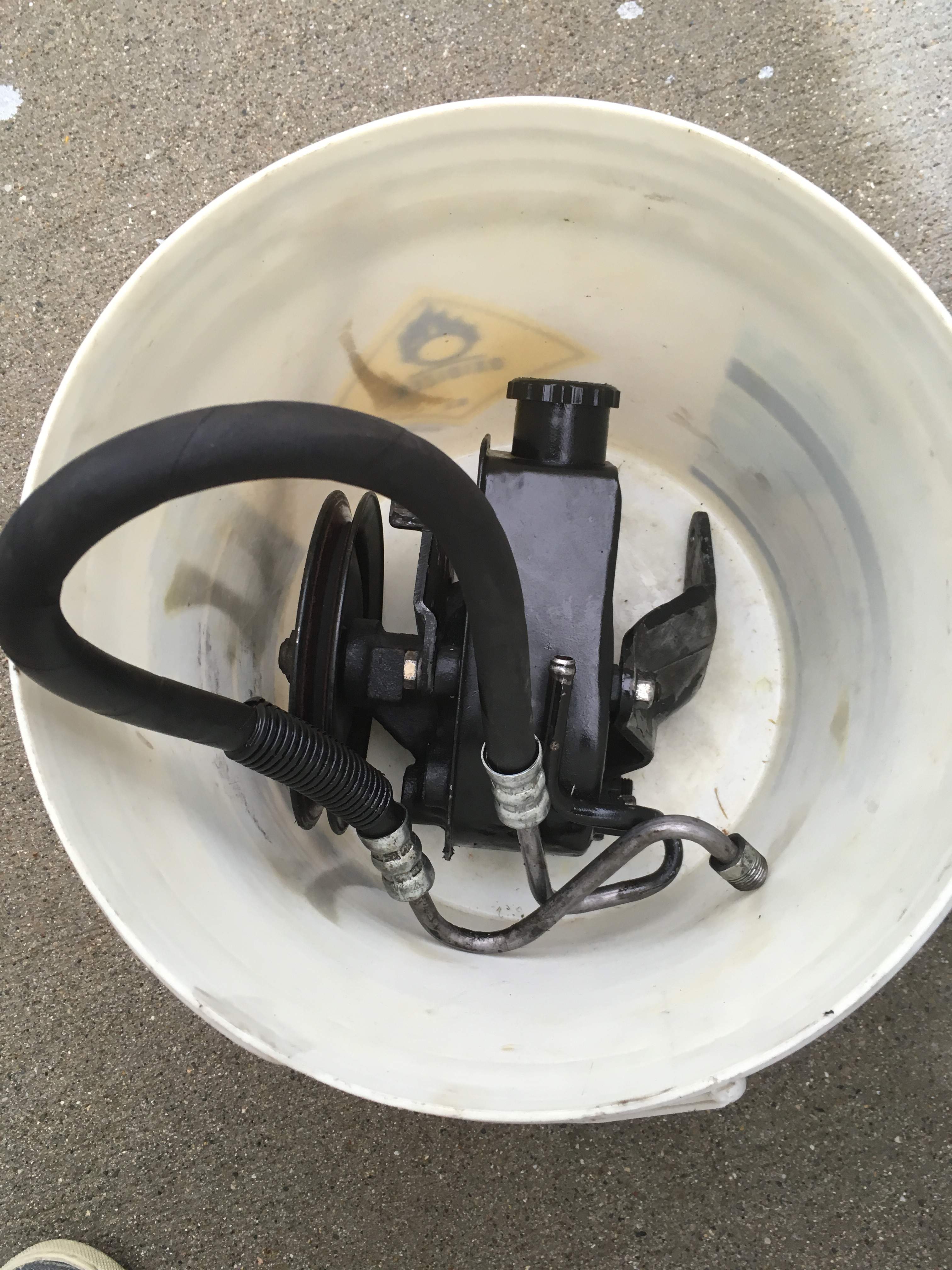

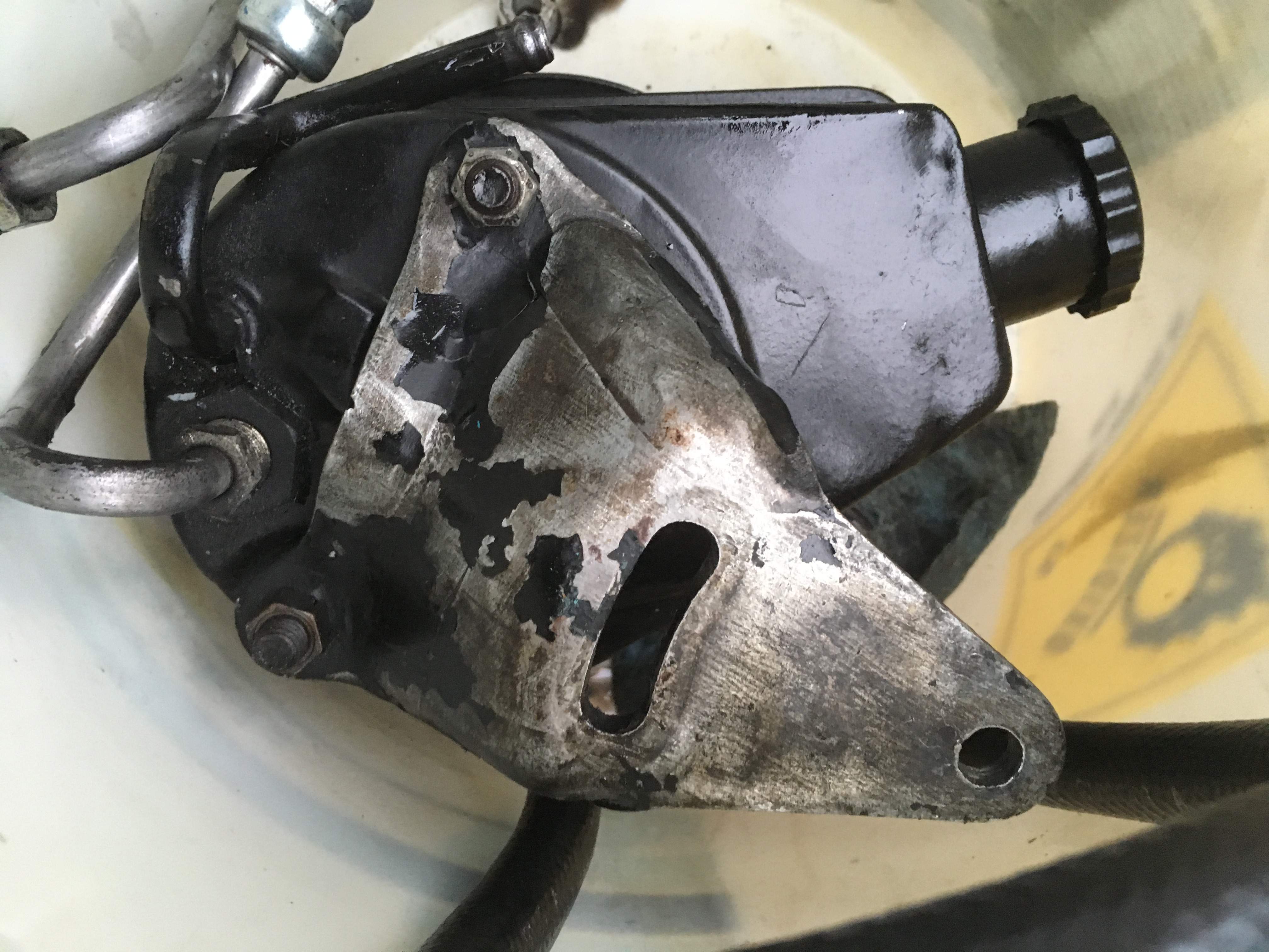

Okay so last night I decide to work on Lucy after work. I find a large puddle of power steering fluid under her. So clearly after replacing the V-belt, I did something. Now that the reservoir is empty (all the fluid is on the driveway and I spend most of the remaining daylight cleaning it up as best I could), I take the brackets off the engine to look at the power steering pump. I don't see any obvious holes, leaks, or gashes.
I see that the low pressure return line is nothing more than 3/8" diameter thick hose with two hose clamps, one at the pump and the other on a fitting at the steering box. The high pressure line is a special hose and I see nothing obviously wrong with it. The rubber hose is probably old and I should probably replace it period (which I will most likely do anyway even it isn't to blame).
Right now I feel I have to clean everything with brake / carb cleaner, put everything back together,  fill it up with fluid,  put a bucket under Lucy, and run it to see where its leaking. Anyone got any better suggestions for diagnosing or detecting said leak?

Wasn’t there an obvious drip point relative to the puddle?
No because I moved the car to its point in the driveway on Sunday and it had two days to drain. Therefore the puddle was the width of the car and the pump was empty.

Thatsa pretty big leak to drain it in 2 days.  Clean and only put a bit of fluid in the res.  Start the car and add till it starts leaking.  Hope you don't have to fill it all the way to find your prob.

Ok, so if I step through this as best I can. The pump wasn’t running in general? Sitting it lost most of the fluid? And this was after you changed the belt? I would inspect/ look at the power steering pump/housing & the hose connections at the housing. Check the housing for a crack, on the bottom or around the hose connection fittings & around the face area were the pump inserts into the housing. The steering box and hose connections at the box would only empty the pump when it was running as a rule.

I am not having any lucking finding an obvious crack or leak anywhere. I pulled both hoses and the pump off Lucy last night. I covered the steering box holes with tape for now to avoid any contamination. I think I am going to make a parts run bright and early tomorrow morning to NPD and get a new pump and hoses and be done with it. I will also re-do the mounting brackets as they sadly need some love and new paint. I will also have to scrounge up a pulley puller.

That’s what I would do! The housing may be cracked at one of the bracket bolts or the O’ring seal at the pump to housing may have failed. That said it’s doubtful that it’s the gear box and if it was it would be the pinion lip seal. Which should have shown up as a regular drip leak.

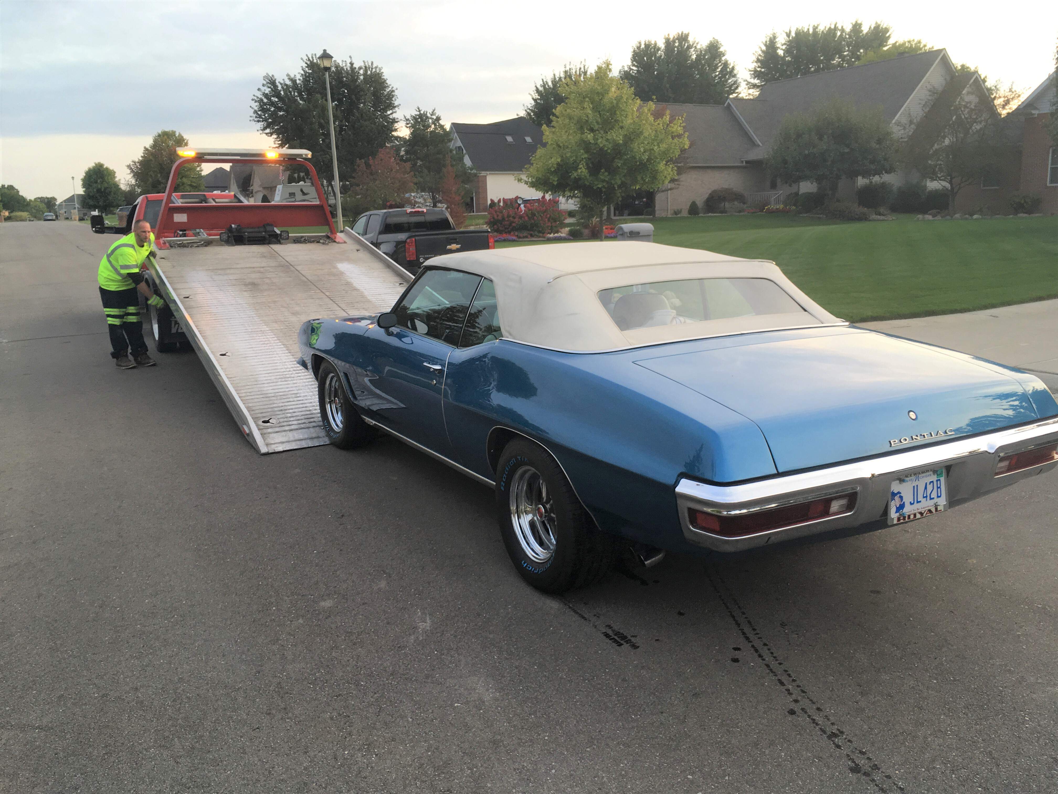

Well I hit the wall with Lucy and I am running out of time. Sunday I spent three hours trying to put the power steering back together. I had to finese the mounting brackets to get them close and managed to scrap up the freshly painted brackets and the pump in the process. Grrr..... The real rub came with trying to connect the new hoses. They won't go in. I suspect the new(er) Camaro steering gear has a different thread than the stock Pontiac/GTO threads from 72.
So I decided to call a repair shop and let them get everything together even if it means new parts again. I had to call a tow truck since the battery is disconnected, and the belts are off. It was a blow to my ego but I know that I am running out of time and I have a charity car show on Saturday. So I am hoping to have Lucy back before Saturday.

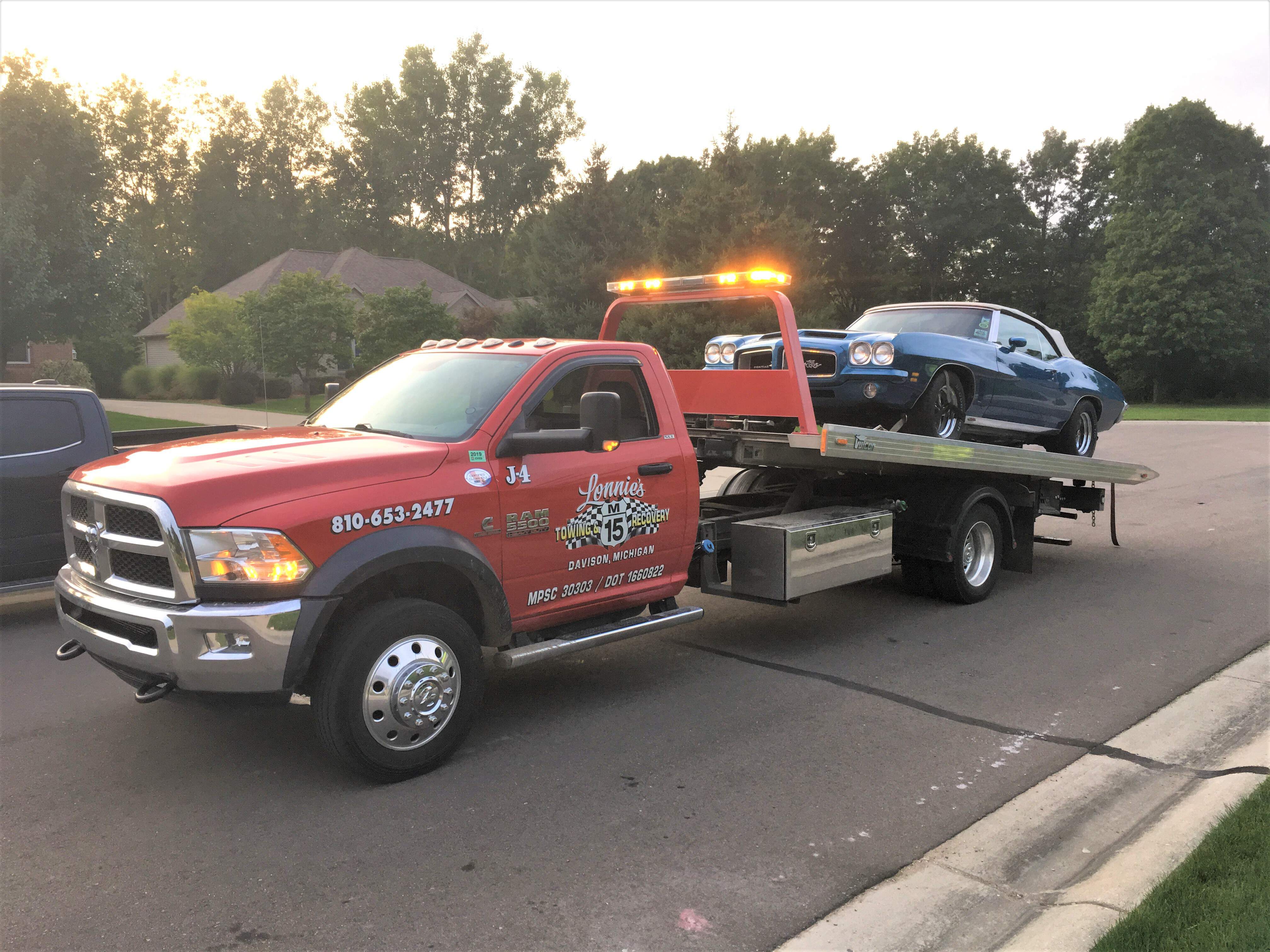

Here ia Lucy in the street, making a mess on the driveway and street and getting hooked up to the tow truck. The fluid is coming out of the steering box. I didn't think there was that damn much fluid in it, but again I'm wrong. The wife is not happy about the mess all over the driveway either. Anyone got a recommendation for a driveway stain cleaner that really works?
Sorry to hear about the mess buddy! I don’t know what year the Camaro gear box is, but if it’s from 2000 on up it is most likely metric. If that is true, and I know it’s too late, but for future reference, they make adaptors that would have allowed you to use the hose you had.
