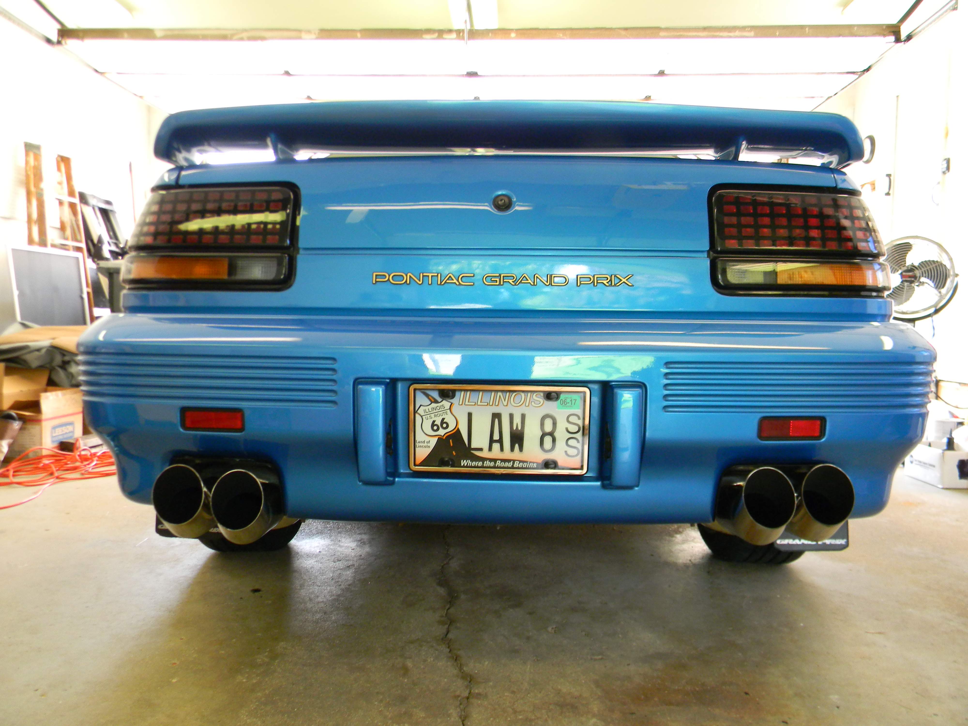

My 92 had a quiet exhaust, and I put mufflers on it that are not muffled at all.  Freeing it up seemed to help with the performance, along with a freed up cold air intake. The rev limiter is there so you do NOT overspin the cams, if yours in the 3.4. Taking off the limiter could be a BAD thing! Once the car is OVER 30 MPH, it will rev UP to around 6 Grand, then the limiter kicks in again.  My GP will ONLY go up to 116 MPH then it will not go higher due to the limiter yet again.  Kinda sucks, but it is how it has been since day 1. I added a Photo of the pipes/mufflers I added for sound and NO restrictions.  Only muffler on it now is the Converter!

Here ya go  Smorggy!  I have another of it running, but this has the best sound.  My GP also has Sequential Turn Signals, like the old Cougars and now newer Mustangs have.
