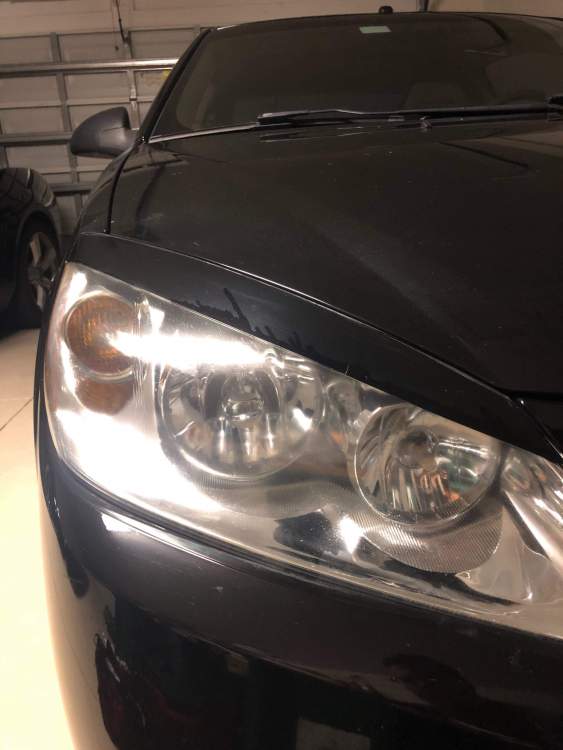

Apparently, my headlight had quite a bit of gunk on it as most people can get by with just using the rubbing compound. Ended up having to use the abrasion pads as well. However, I am pretty happy with how it turned out. I wouldn't say it is "brand new" but it is very close and oh, so much better. For the price and spending less than an hour on the project, it is a great product IMO.
Totally did a bonehead move and forgot to take a "before" picture but you can somewhat see this in the below pic:
Here is the after. Like I said, not perfect but so much better!:
