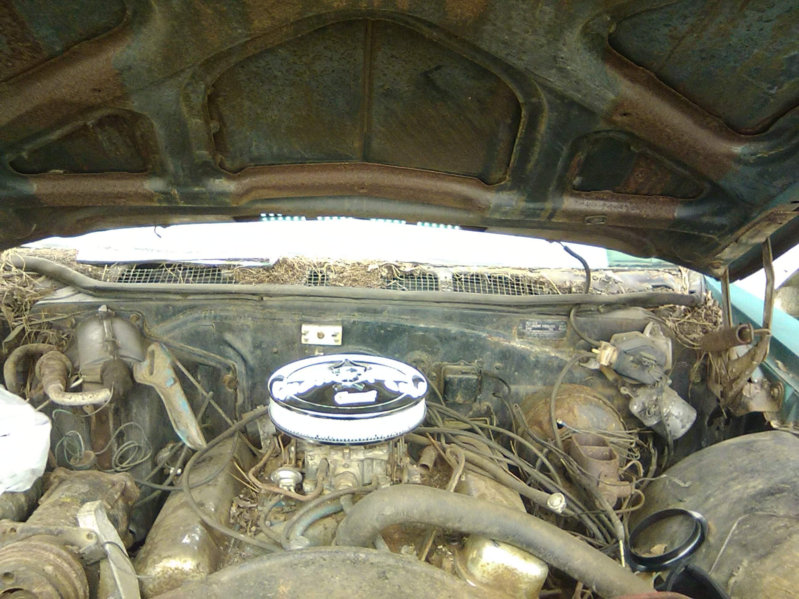

i just bought a 1968 bonneville that has been sitting  for 30 years has the original 428 th400 motor is not locked up i turned the crank with a socket and wrench before i handed over 500$ put a battery in all the lights and  things work the engine wont turn over or try to crank turn the key nothing happens do i run wires from battery straight to the starter??what could be the problem.??thank you for any wisdom that helps😟

Thank you for the wisdom switch is bad I used a bump switch. DiStributor is stuck or rust is the problem engine turns over and pops
That's a start bro. Thanks for the pic to 😁, we love pics around here. Old or new, even just old parts. We don't care, we just like Pontiac pics lol!
