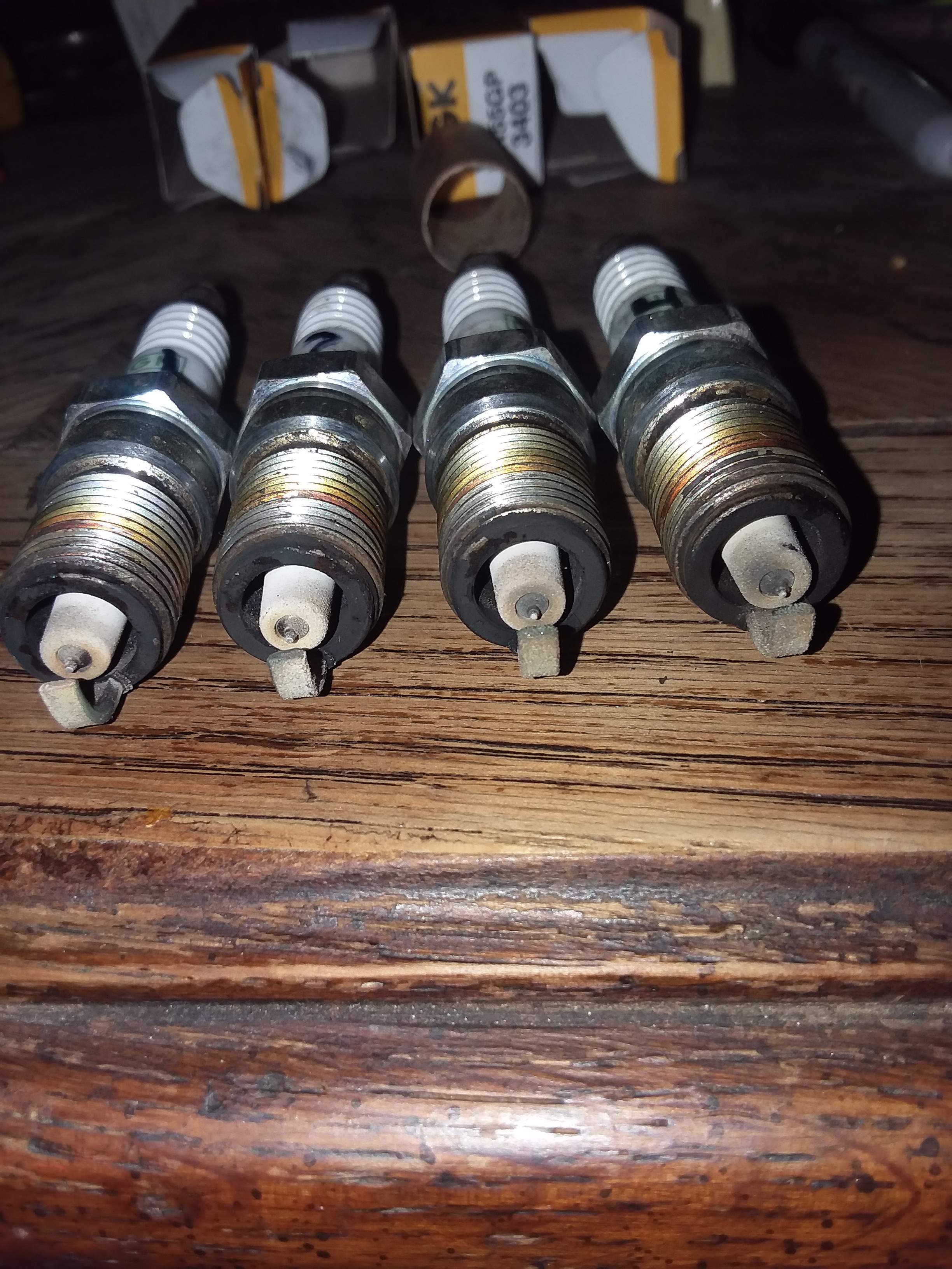

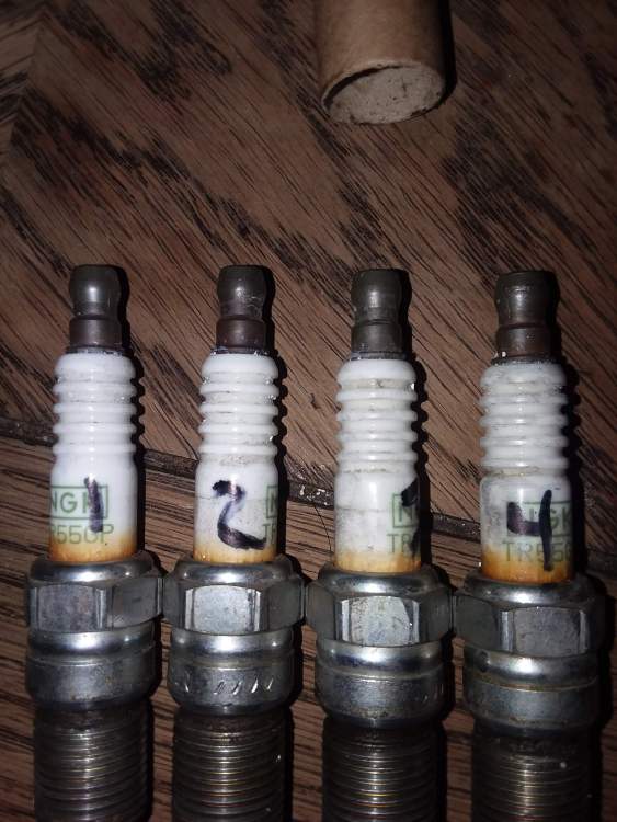

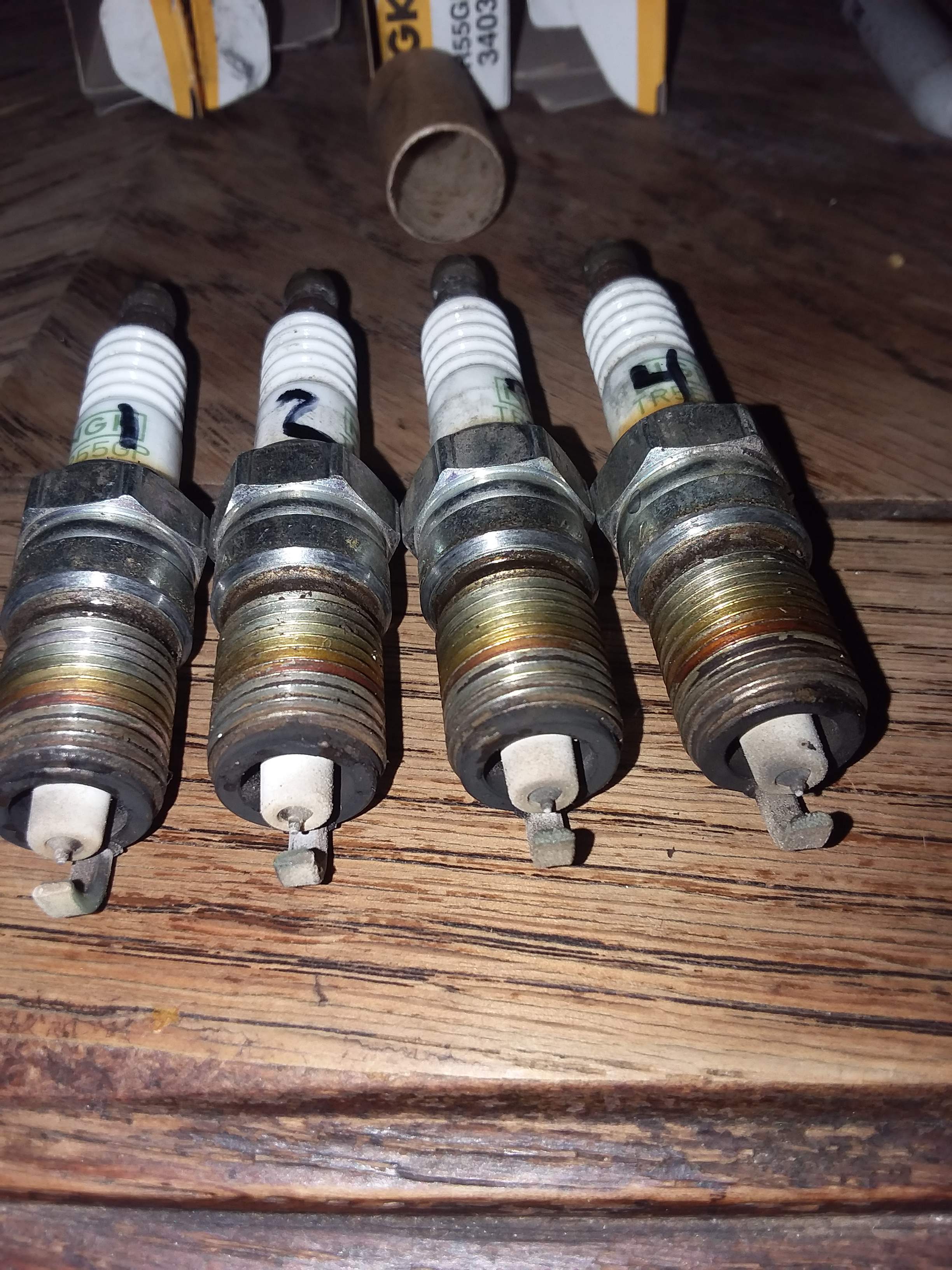

Got some NGK spark plugs that ran well for about 35,000 miles or so. When I installed them I put new boots on (GAs spark plug wire set) with dielectric grease. The plugs came out very dry so I put anti-seize on the new ones and worked it in also dielectric grease on them as well. Here r some pics of old ones. Any advise about this?
So what prompted you to change your plugs in the first place? I really don't see anything of extreme concern in the wear.
Are these the correct NGK plugs for your GA? Based on the numbers on the plugs vs. what I pull up at Autozone.com - these could be a heat range or two off.  Autozone shows a TR55IX as one of the NGK plugs.

I reset the plugs gap from .06 to .05 and removed anti-seize from nickle plated plugs .. then was like what the hell and actually read the dielectric grease packet (n this is why u should read all manuals) turns out it is an insulator and not a conductor ... cleaned up that mess and the difference in gas mileage is crazy. I do think this is why I though the old plugs where bad to start with. Damn dielectric grease  on contact points
