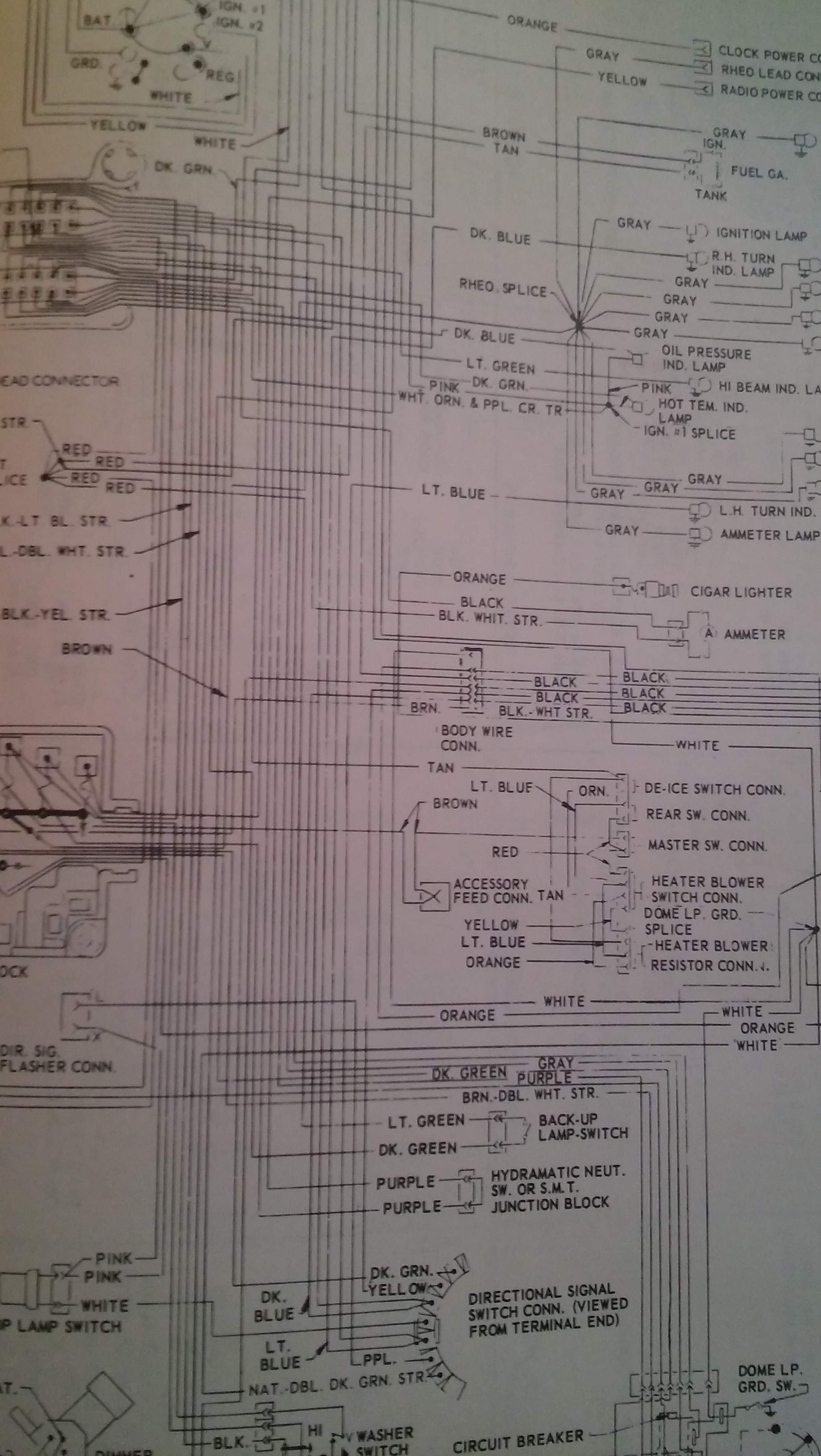

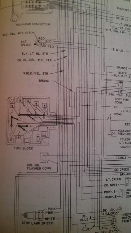

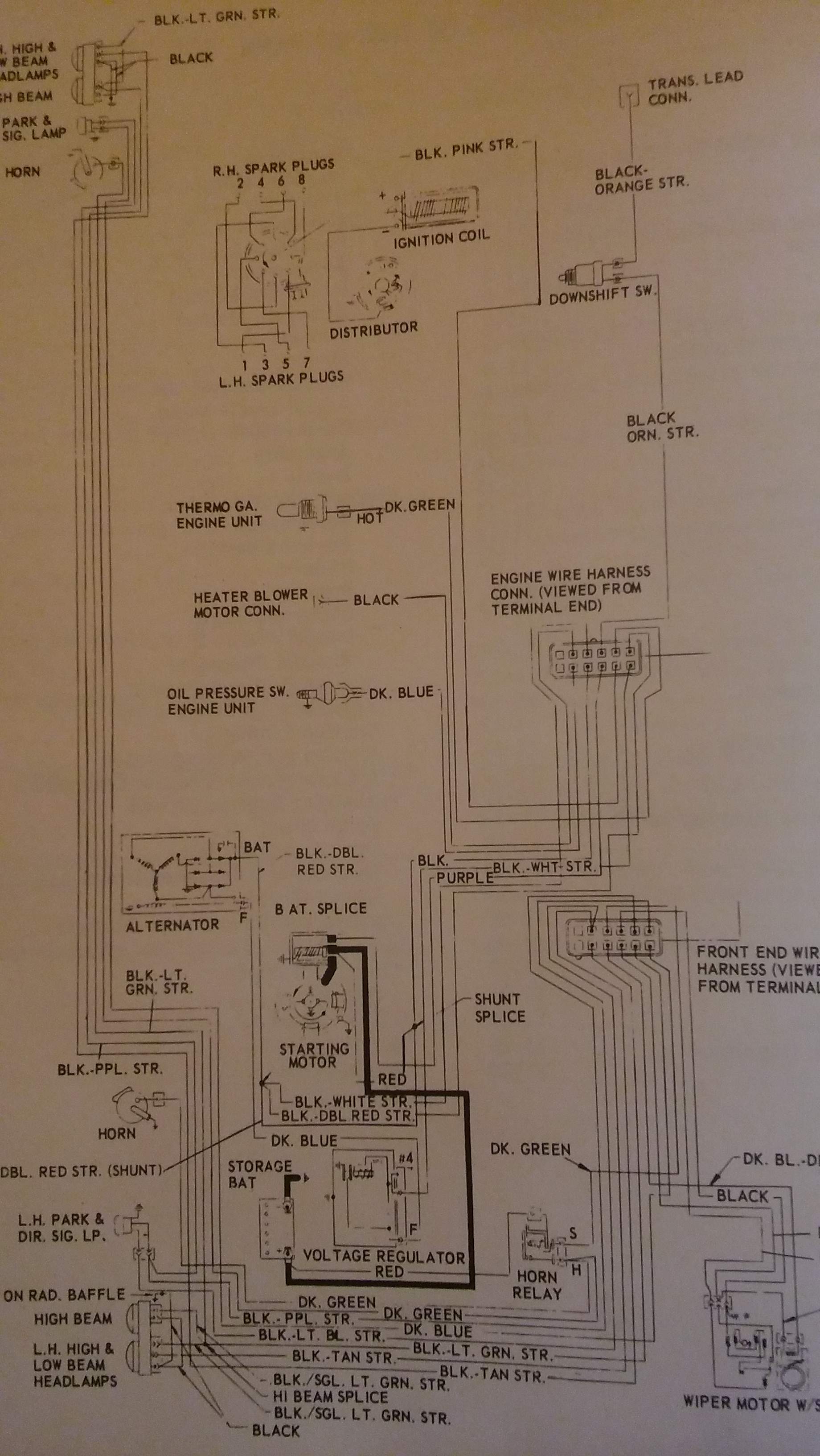

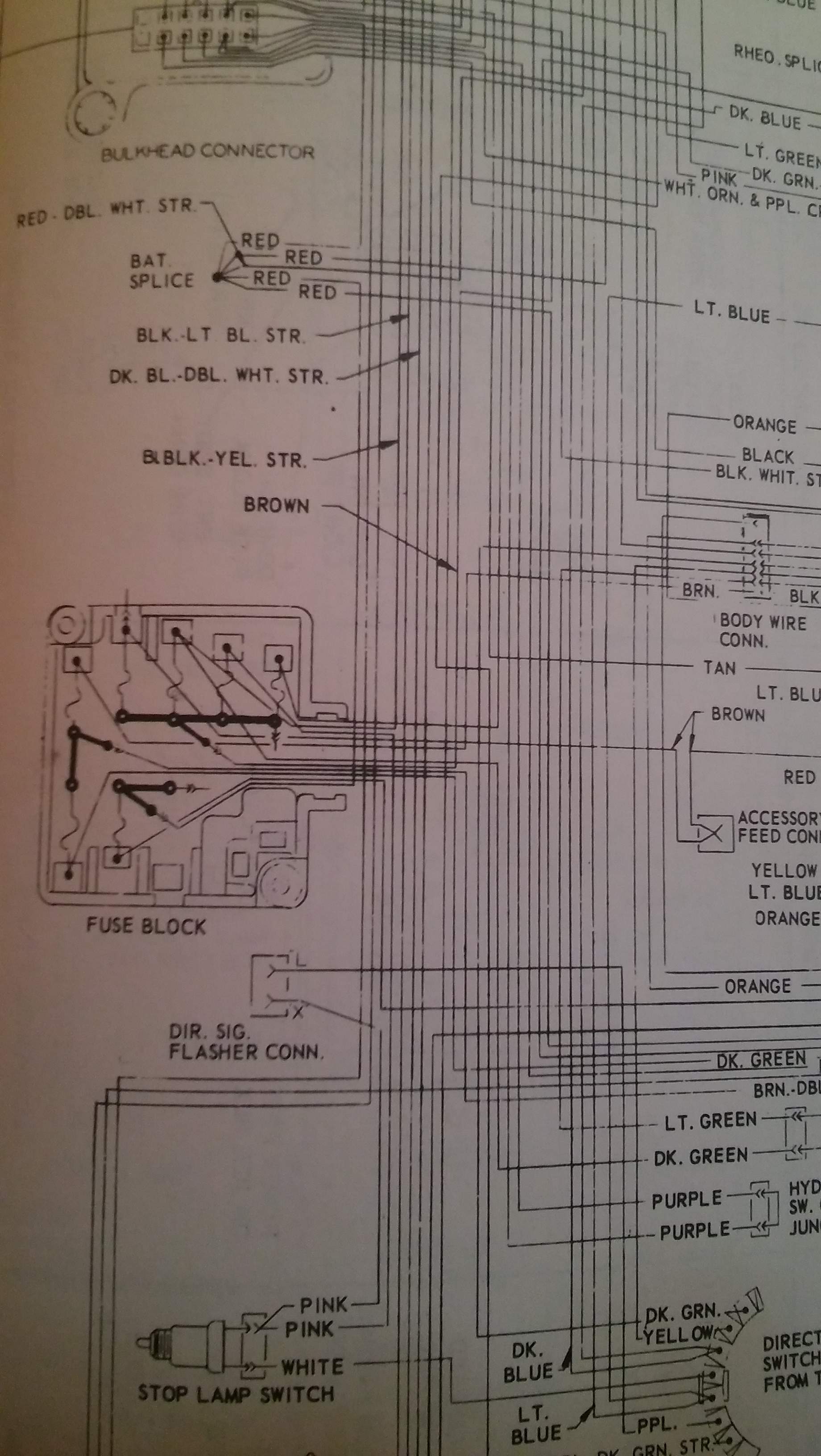

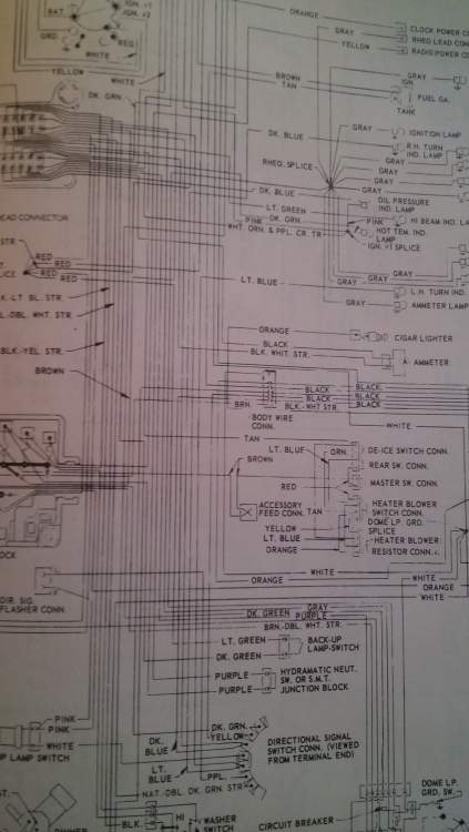

This the actual GM manual from 1965...Not a reprint....
Took photos with phone....Hope you can see them OK....Flasher is located in the fuse block......Hope this helps
