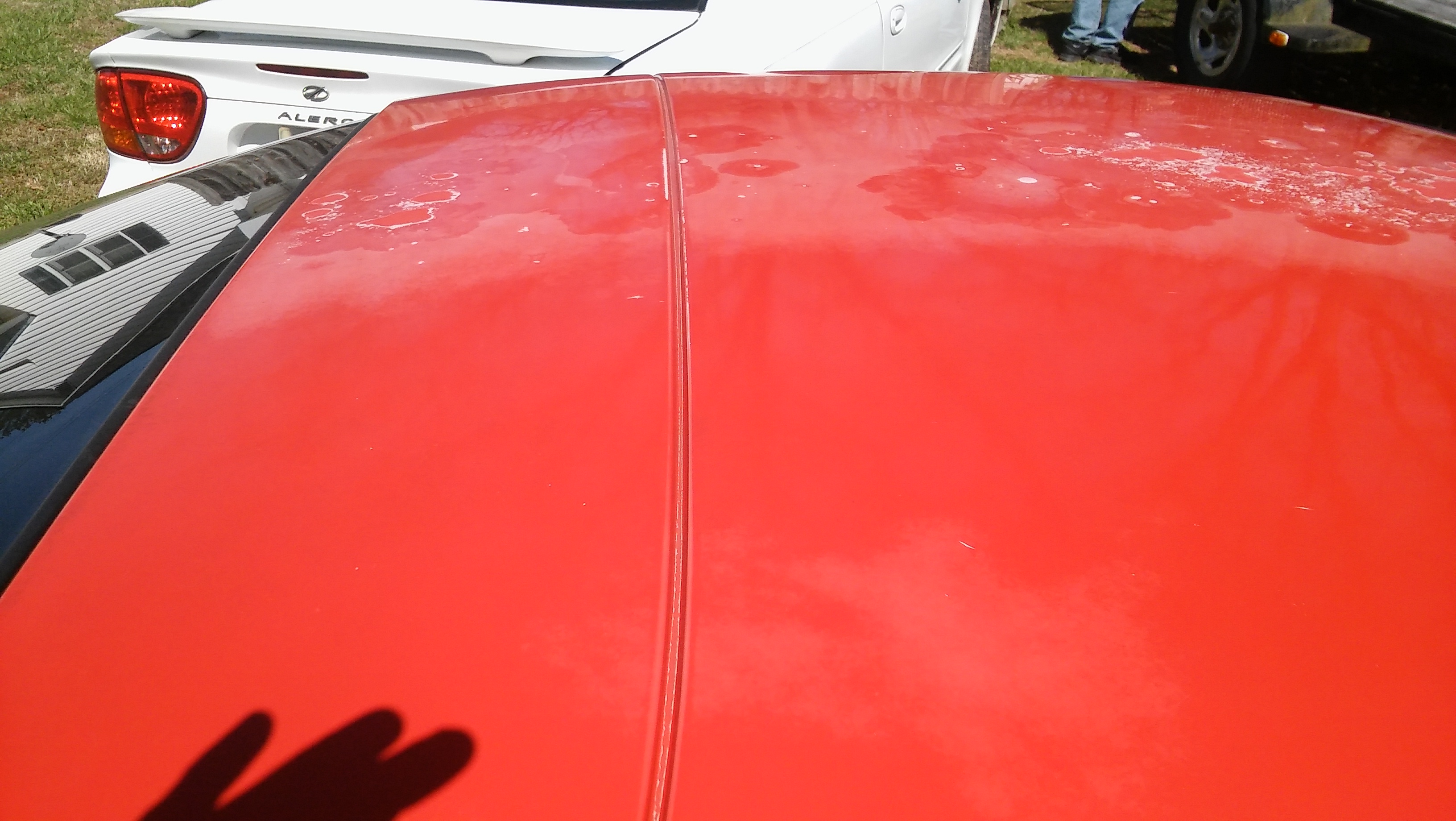

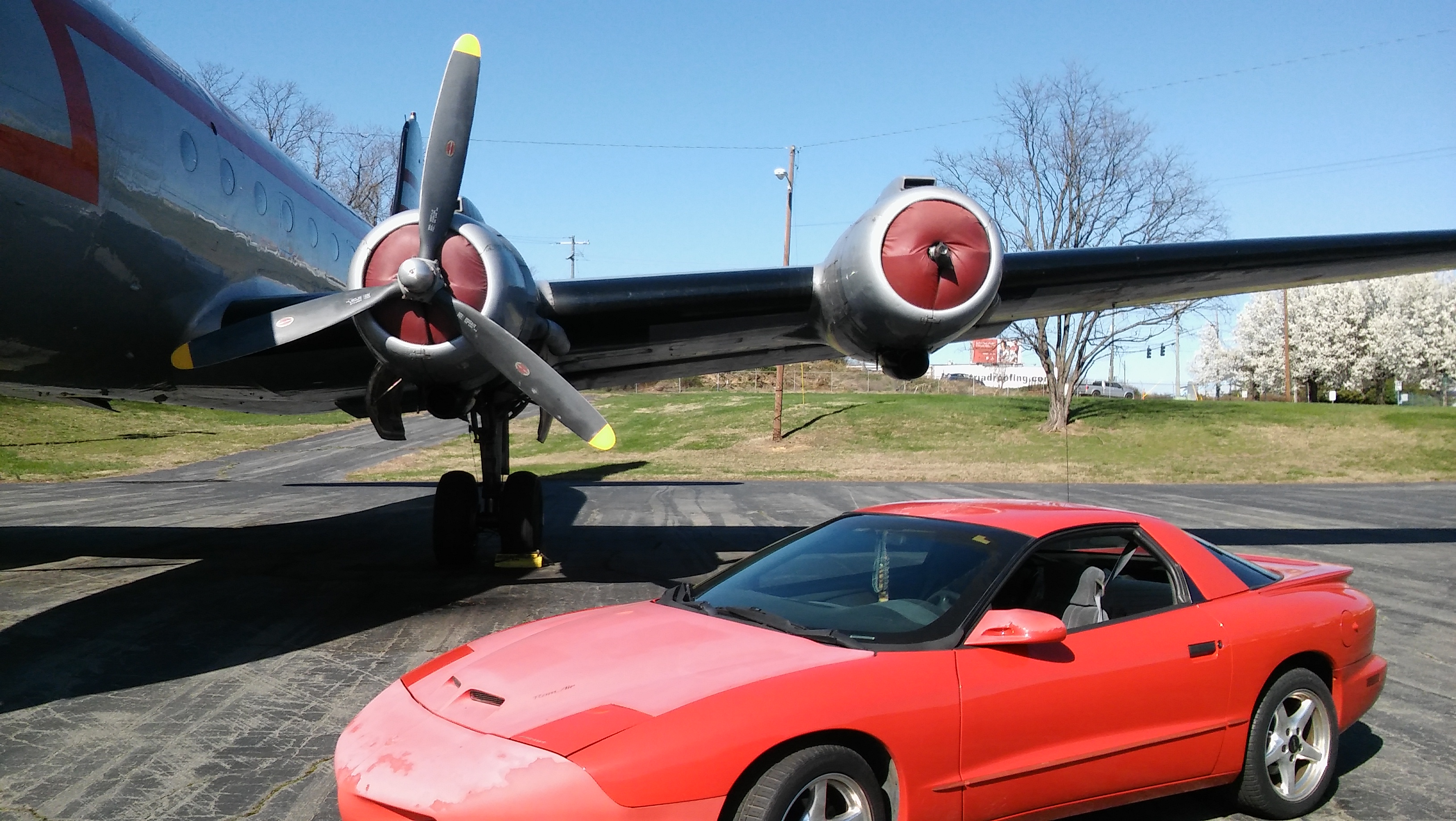

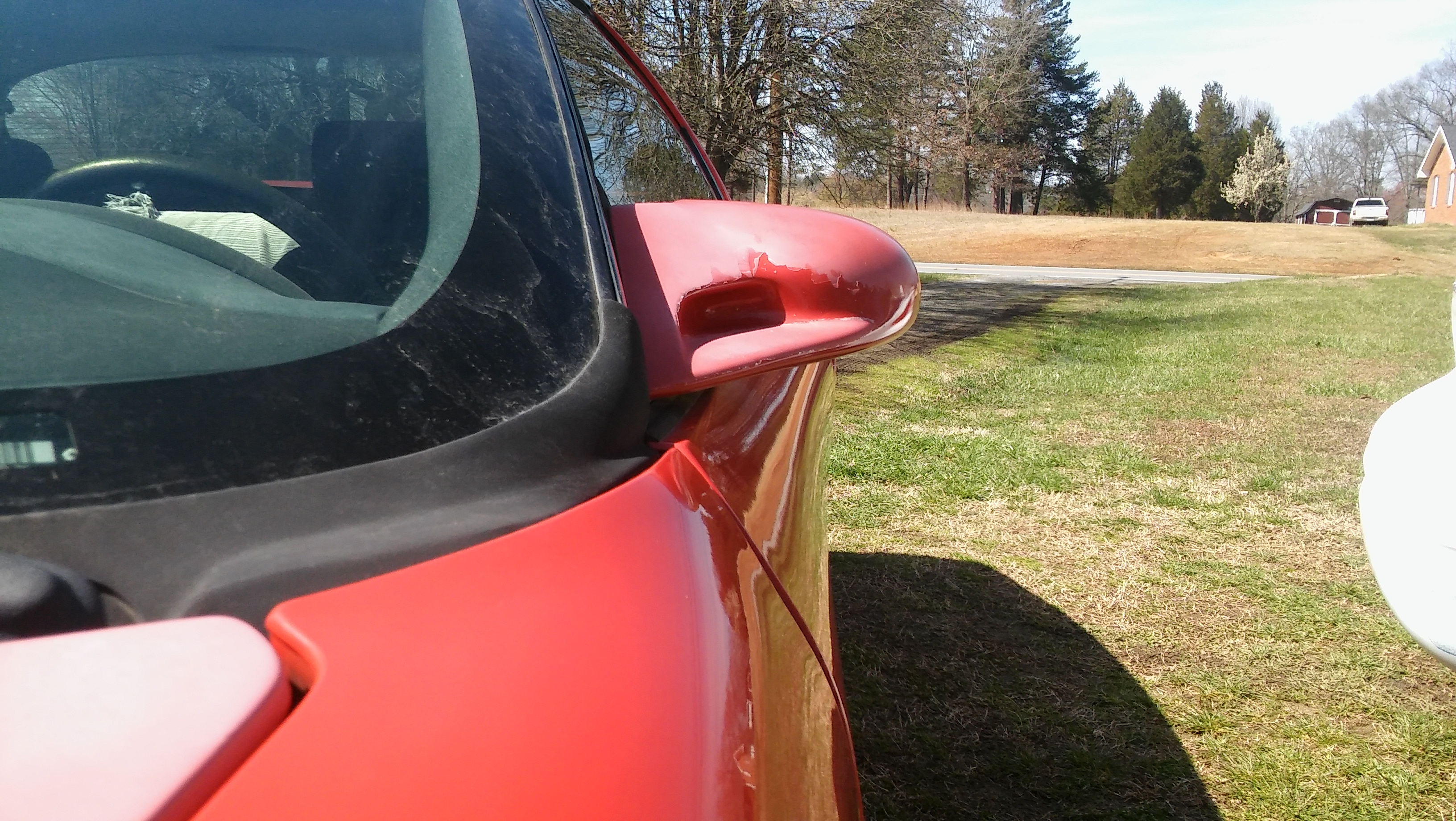

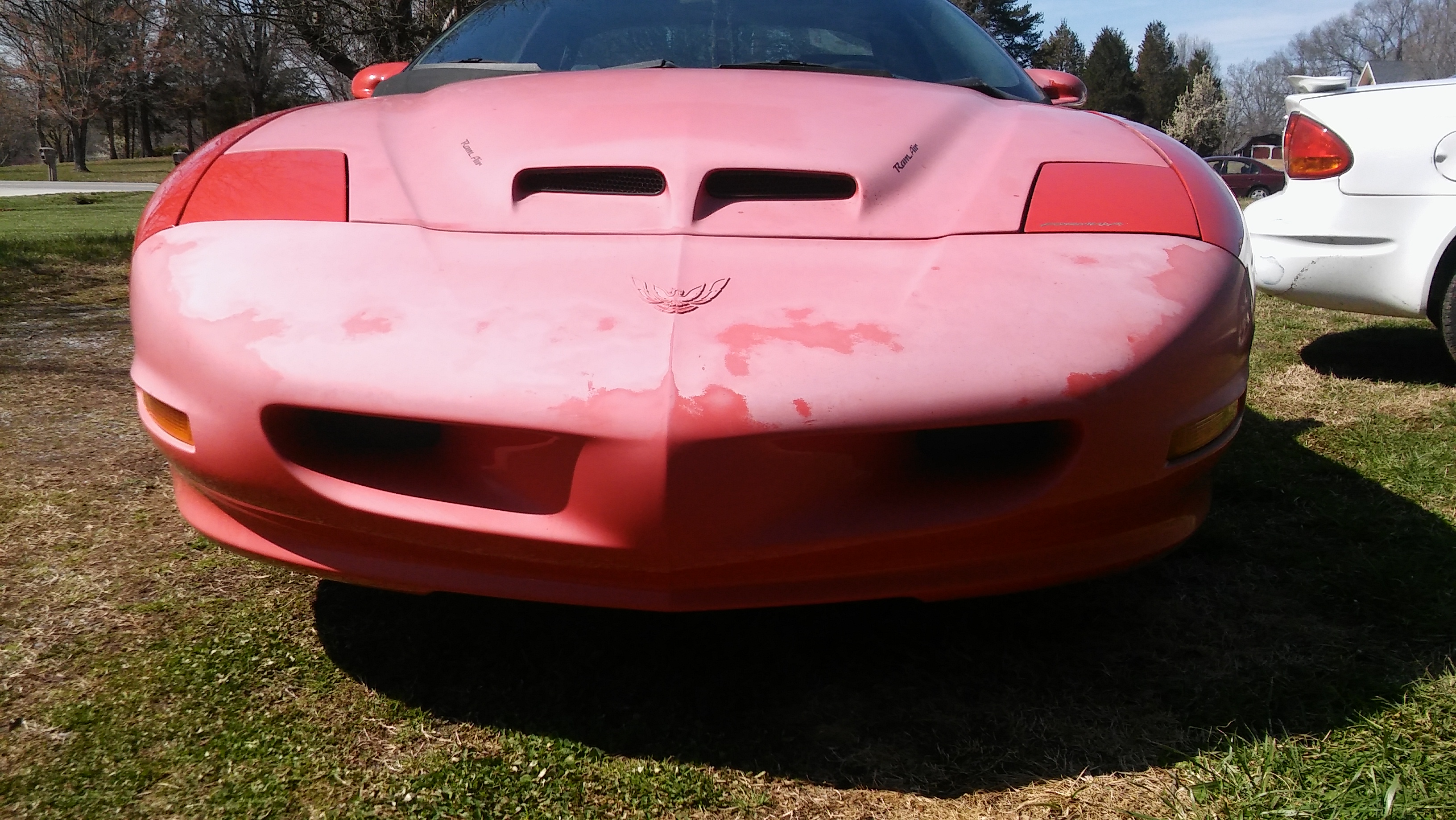

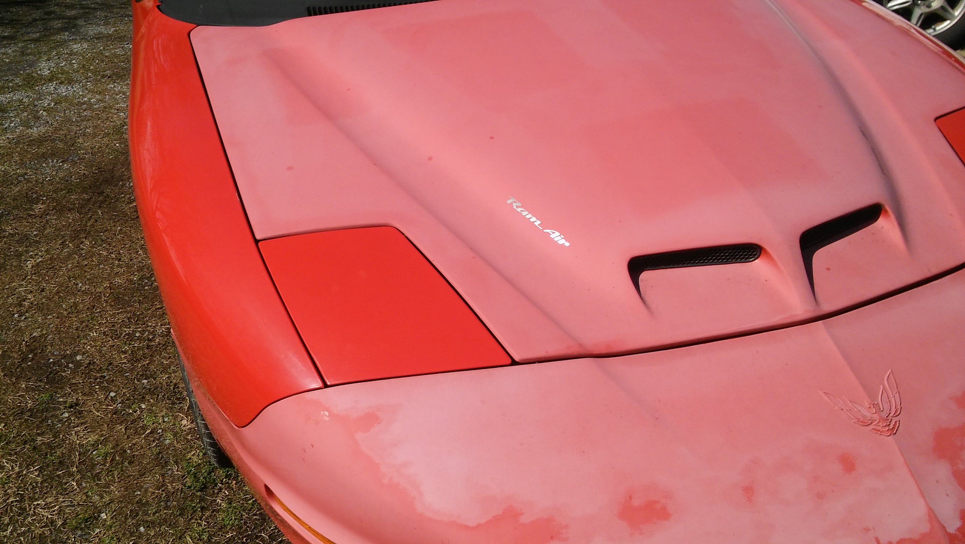

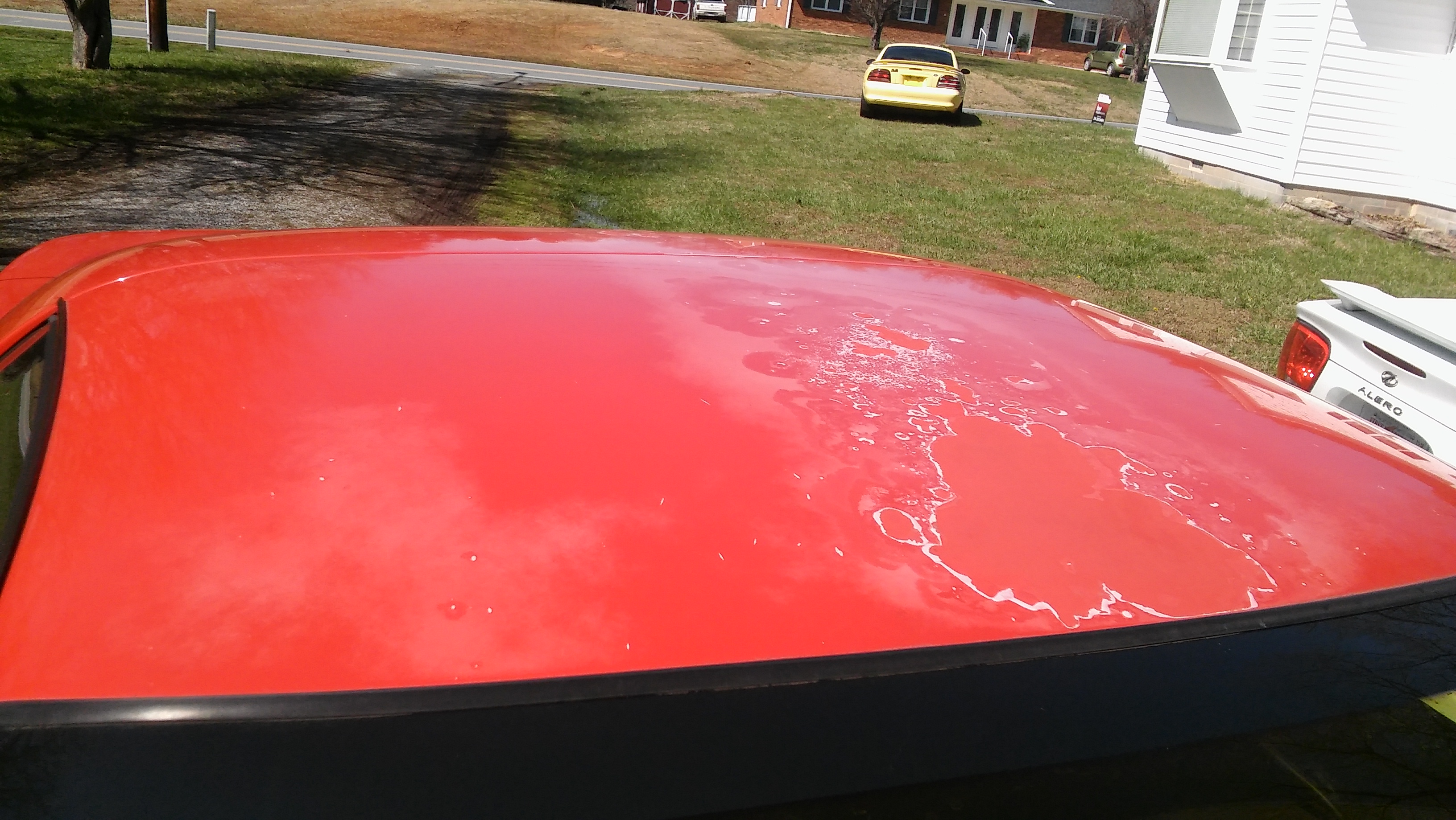

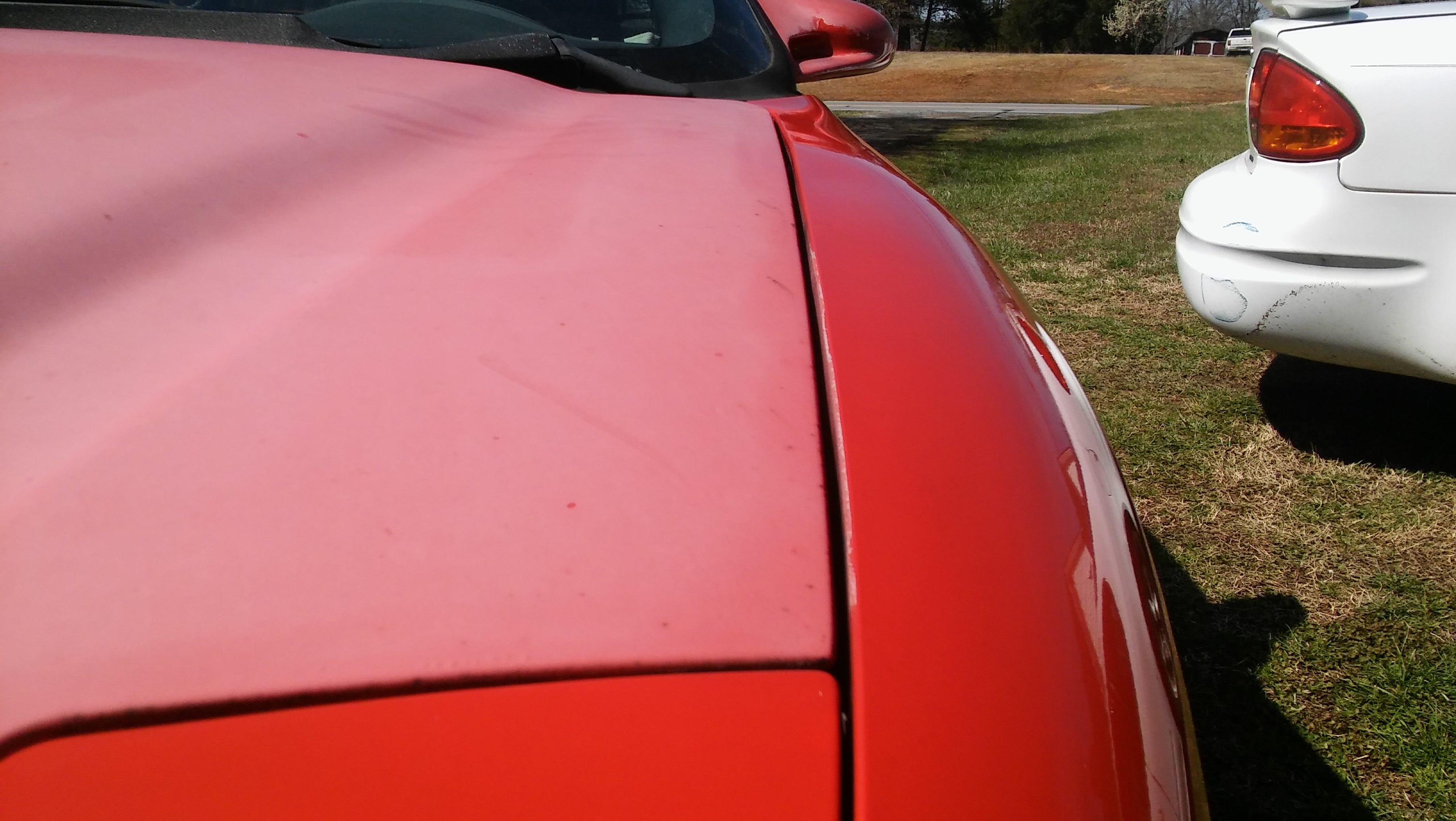

The clear layer has been peeling off of my 1997 Formula 1LE over the last few years...Honestly it looks terrible..My delema is...I want the car to remain as original and unmolested as possible..Pretty much the clear is peeling off the roof.. Rear bumper cover..Front bumper cover and the hood..My question is Do I redo the whole car..or just the part of it..Am afraid if I don't do it all it will never look  right..At the same time I want to keep it as original as I can..As of today the only things not original..Besides the fluids are the tires the battery..serpentine belt...clutch master cylinder... rear pinion seal and the fuel pump...mechanically it is excellent...other than that is completely original Any advise or feedback would be greatly appreciated.....
Edited by TWO LANE BLACK TOP
Right now the condition of the FACTORY paint, makes the ENTIRE Formula look like it has been neglected for a LONG time and takes the resale value down the drain. The fact that the paint is peeling all over the car, means you can't just paint over the ORIGINAL finish, because it will just flake off again. The ENTIRE finish has to be removed. Also, you need a Quality Bodyshop  that has worked on these cars before. There are several DIFFERENT PAINT mixtures that need to be applied SEPARATELY! The doors, the front fenders and the front and rear bumpers are made with a different material than steel. The surface qualities of the different materials using a technique known as Distinctiveness of Image, which compares the clarity of the reflection or the visual  depth of the paint. WHEW, that's a lot to understand, but the bottom line is that you cannot just pick up a paint gun and shoot the entire car. ALL of this is EXPENSIVE, but if you want your Bird to look BRAND NEW, it's gonna take time and $$$$$Money.
Two Lane, I’m sorry, but I would disagree with 91 as far as needing to strip the whole car, at least at this point, but his assessment of its condition for value is true enough given the availability of that car. I’ve painted a lot of cars in my life in many different states and conditions, Vettes, Fieros and all kinds of steel bodies and that includes urethane bumper covers and plastic mirrors.
So while I can’t see your paint job well enough to determine its current condition, I wouldn’t rush to the judgment of stripping it! It’s a base coat/clear coat paint. If the base coat that is left where the clear is gone is in good enough shape. The clear coat that is left isn’t crazed or opaque looking and appears in good shape you may be ok to do the following.
Wet sand the whole car down really well, finish with 400. Then spray it, the whole car, with a primer/sealer. Then paint as normal with the original bc/cc paint. I don’t believe you can chance getting away with less.

Thank y'all for your input..As far as value of the car I know that the paint condition hurts it..But it is still a 1LE ..and it is ultra RARE..28 produced in 1997 according to PHS..14 of them were actually titled.. the rest went straight to the track..Realistically...rare means Unpopular..Will Probably never have alot value except to me..Most of the people That see it Don't have a clue what they're looking at...To them it's just a V6 firebird with an after market hood Someone stuck on it..That being said.. Am not looking to sell it anyway..
Have had a few different paint guys look at it..General consesous is Like Indian said Where the clear has come off.. the base coat is salvagable...accept for maybe the hood... Then again one says it can be saved..Another one says it can't..Personally I think it can..The clear on the doors.. fenders..Quarters is in good shape no signs of flaking..crazing or having an opaque look to it..Worst part is the hood and the front bumper cover as indicated in the pics..When the weather clears here in the next couple days will take some really detailed photos of the rest of the car .. Then will go from there

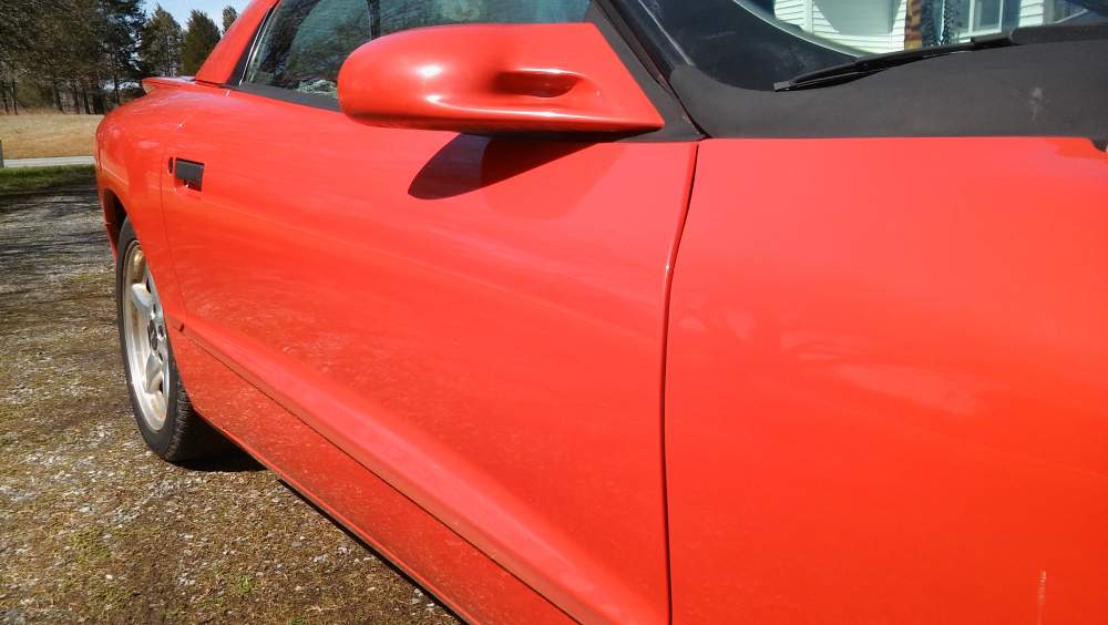

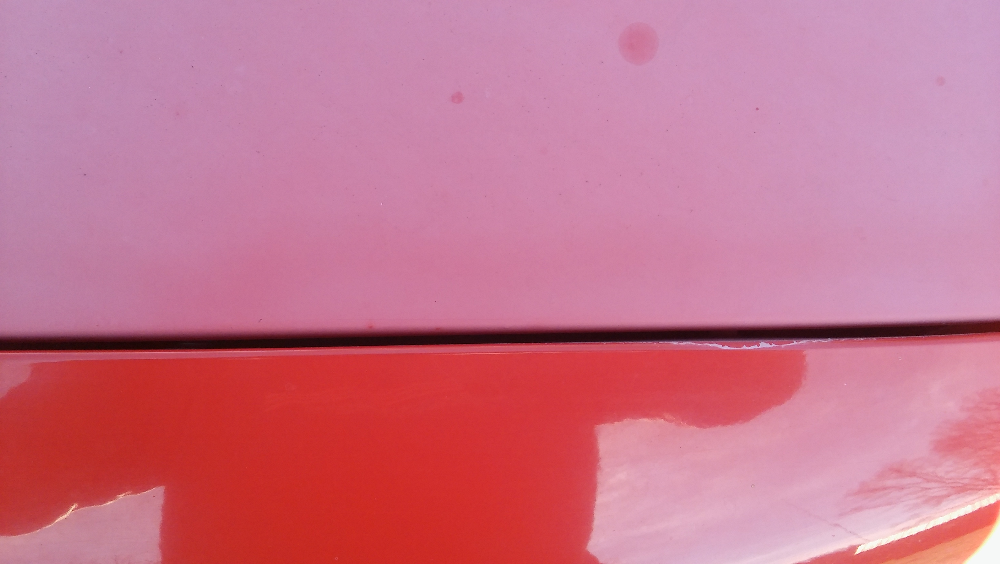

The only reason I suggest the primer/sealer is color fade and or match! It doesn’t appear that the bc is metallic, right? Yet base coats have no UV protection in them, that’s in the clear coat. So even if there is enough bc to scuff down the pigment may have changed and not match the rest of the car & if you scuff it, well it won’t match either.
If you use new bc on those areas they may not match either. The clear coat is a non issue as far as matching. My best advice based on what you’re telling me is this.
It appears you’re fortunate that all the clear coat issues are contained to whole panels? So you don’t have to blend bc/cc lines.
While it’s not the best paint around, neither is what the OEMs use, I like ChromaBase paint to match an original paint and I think it’s your best chance at matching the original that’s there, so I would recommend that. The same goes for the clear coat. So wet sand the whole car in 400, cover what won’t get painted in bc. Reshoot the areas that are bare base coat. After it dries the proper time, don’t sand the bc at all, I repeat don’t sand. Then clear coat the whole car. Let it cure a week or two , wet sand it with 400,600 & then 1000 or 1200. Then rub it out. Worst case scenario is it doesn’t match and at a later date you strip it.
FYI, the main reason so many of the early bc/cc paint jobs did what yours has done is because they couldn’t get the UV & plastisizer chemistry for the urethane right.

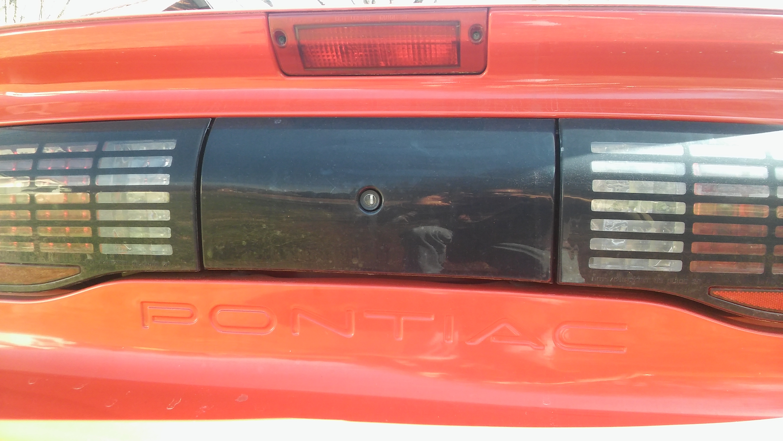

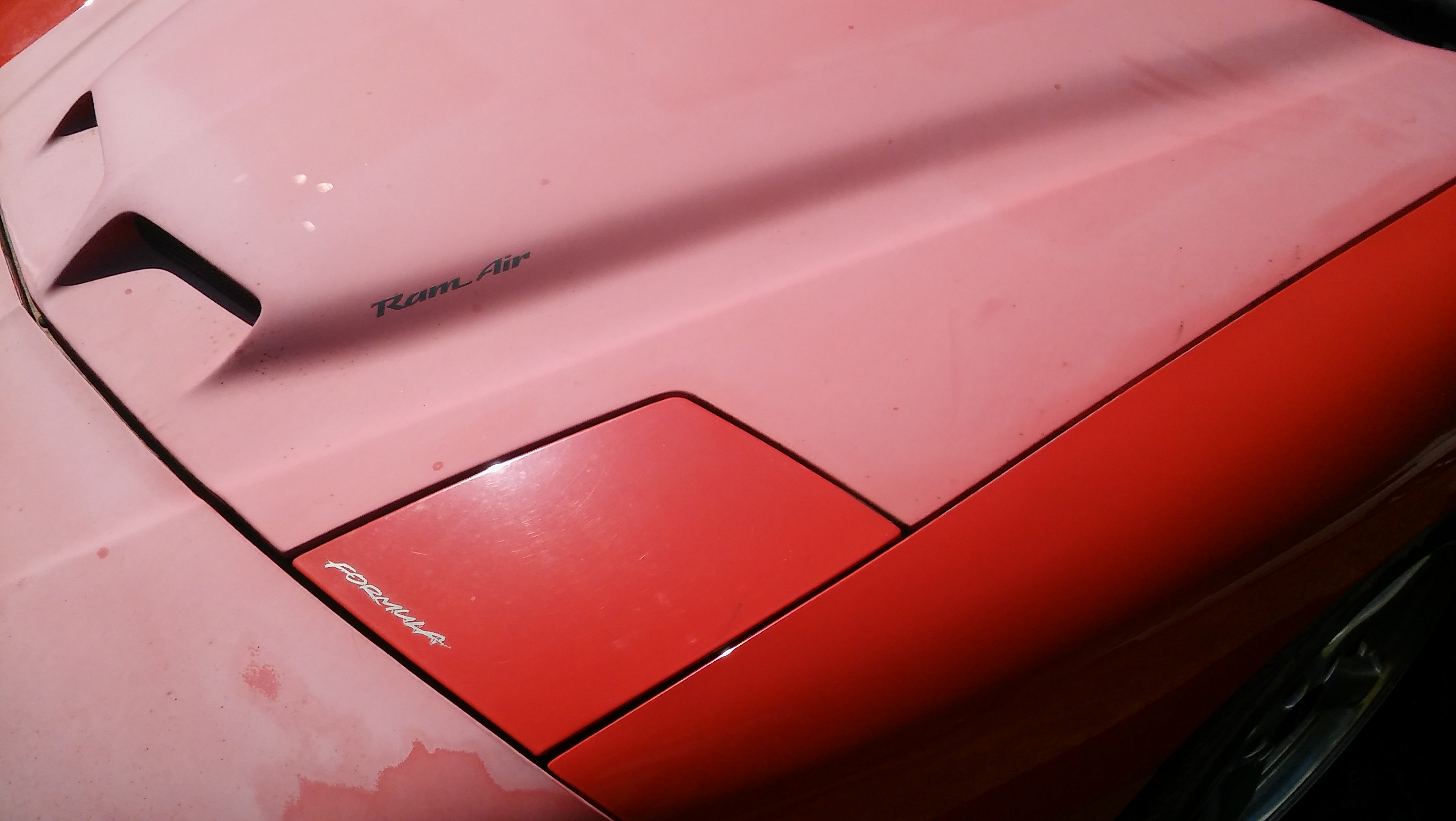

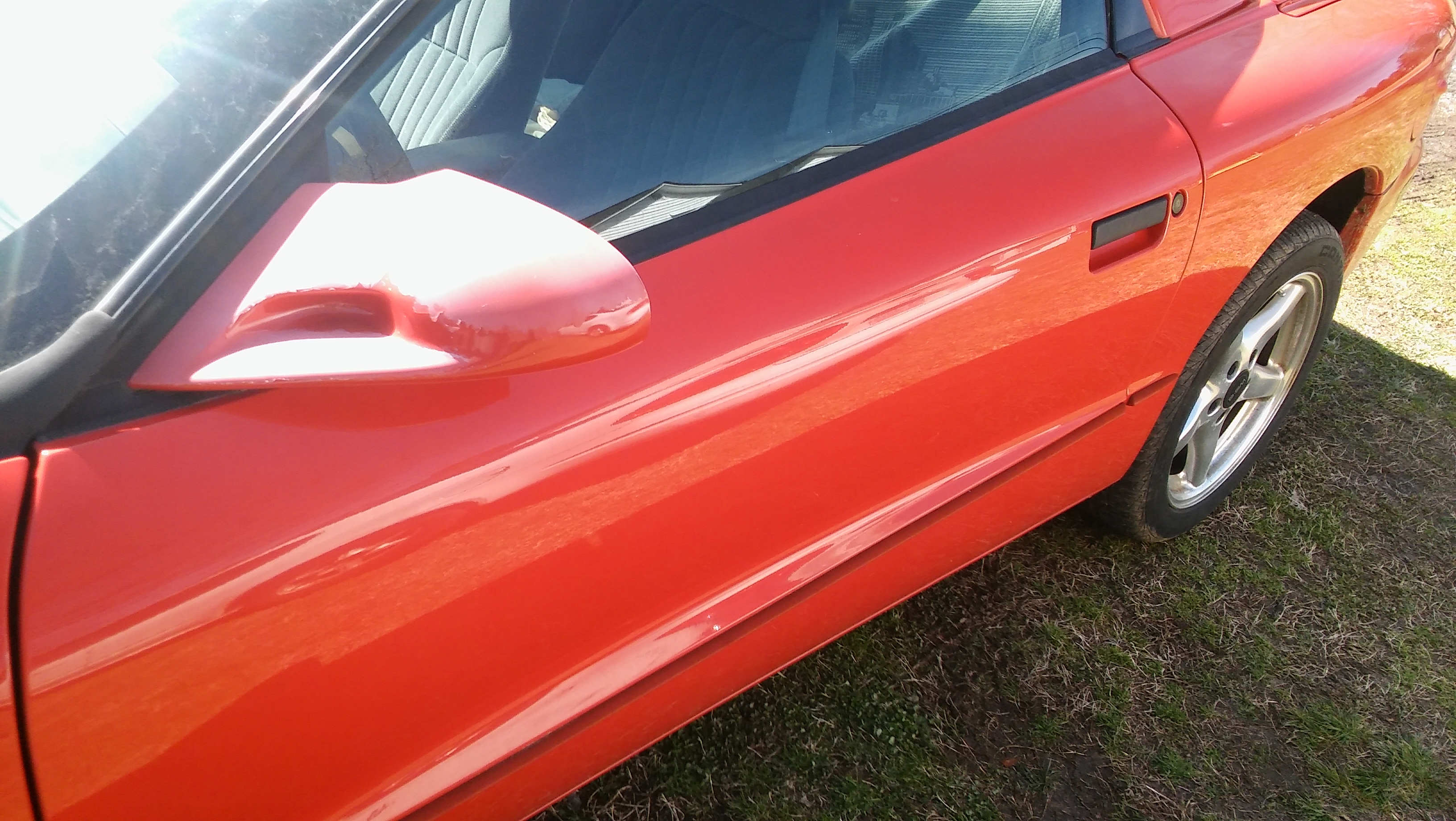

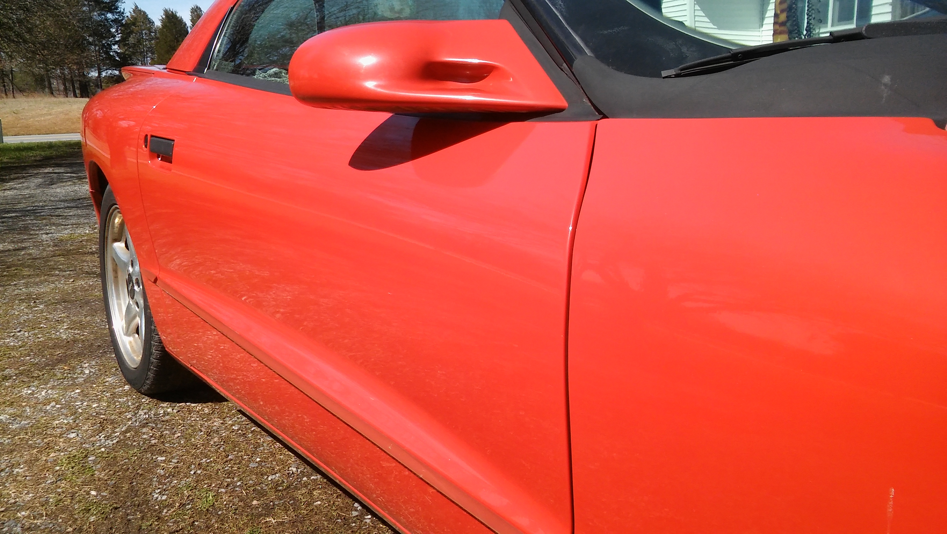

I know I am late to this discussion, but I wanted to think about it first. The clear coat is definitely gone on the hood, front bumper and failing else where on the car. So as everyone is in agreement, the clear coat definitely needs to be re-sprayed. Care will need to be taken when wet sanding the exposed base coat, we don't want to burn through it, just create some mechanical adhesion for the clear coat to grab on to and bring back the color.
Its been my experience that clear coat and paint fail for one of two reasons:
First, the long term exposure to extreme UV rays breaks down the UV protection in the clear coat, or there is imperfections in the chemicals of the base coat/clear coat that reacts to the sun's UV or heat over time and causes it to break down.
The second reason is a chemical reaction of dissimilar chemicals between the primer, base cost, and clear cost. This is the problem that caused so many GM trucks and cars to have their paint peel down to the primer back in the 1990s and early 2000s. Full size trucks, SUVs, and Grand Prixes were especially susceptible. In these case, the vehicle must be completely sanded down to clean metal and the primer, base coat, and clear cost must be totally re-applied in order to prevent the chemical reaction from starting all over again. I am not suggesting this is the case for your Firebird. Rather I am making a point about potential problems.
I hope you can get by with just a clear coat re-spray. I am worried that the amount of damaged base cost that is exposed on the hood and bumper,  is it too much and might force a base coat re-spray? I don't know. Definitely talk to your local paint guys.
While in the long run it may cost more money, a total re-spray might be the best option for the car for the sake of the looks. I doubt you will lose much or any value by re-painting it since it is a 1LE car.

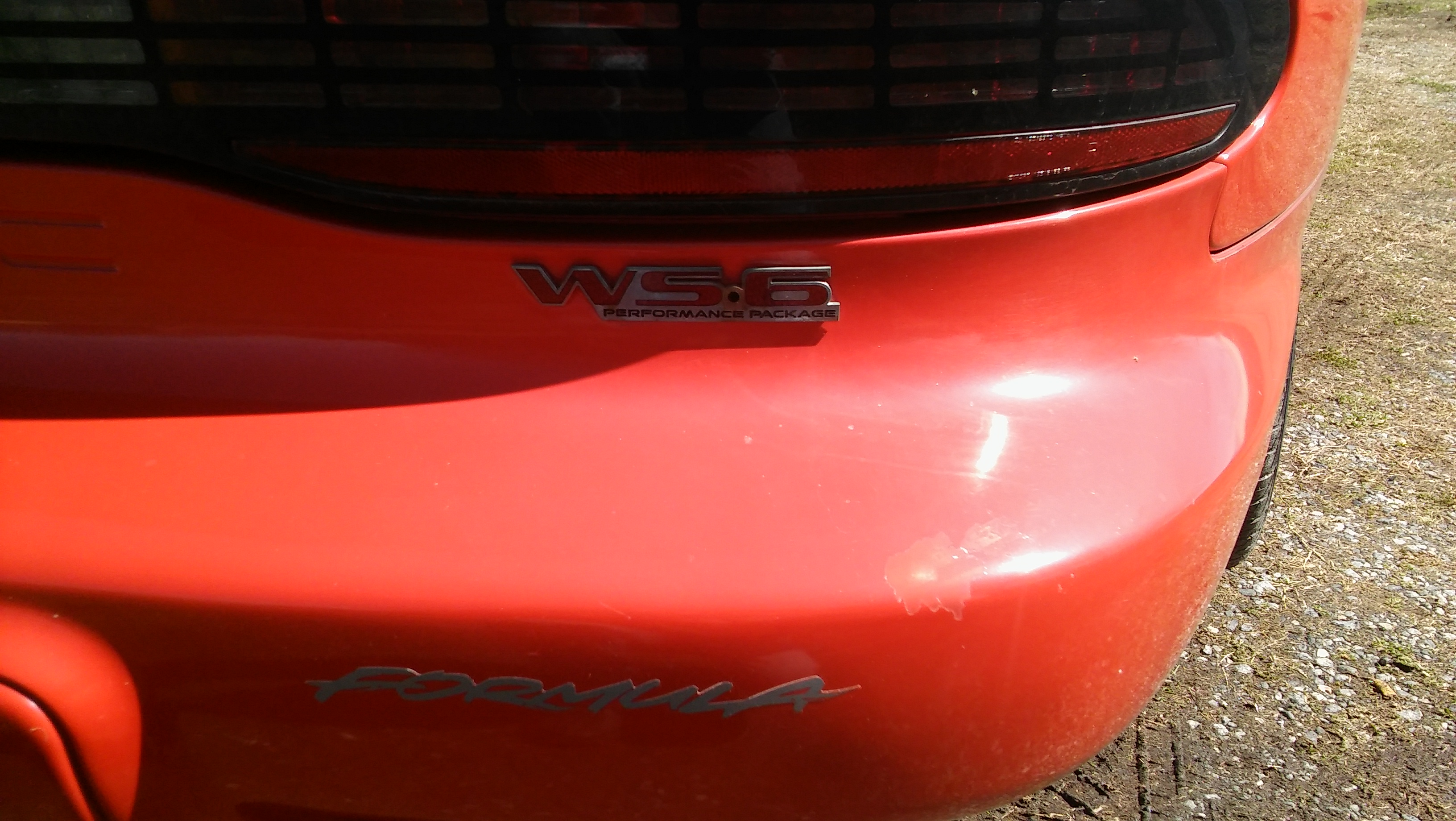

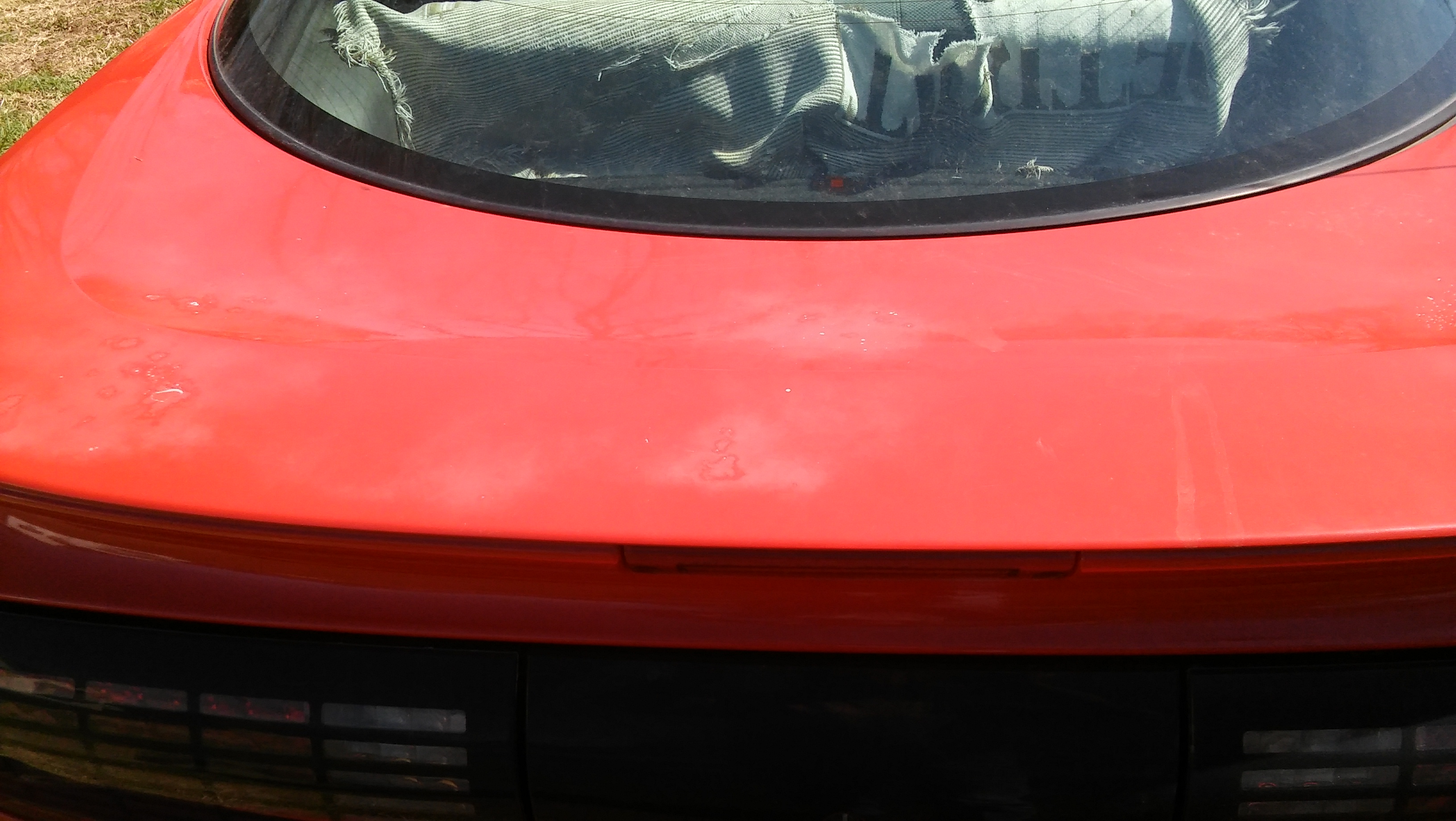

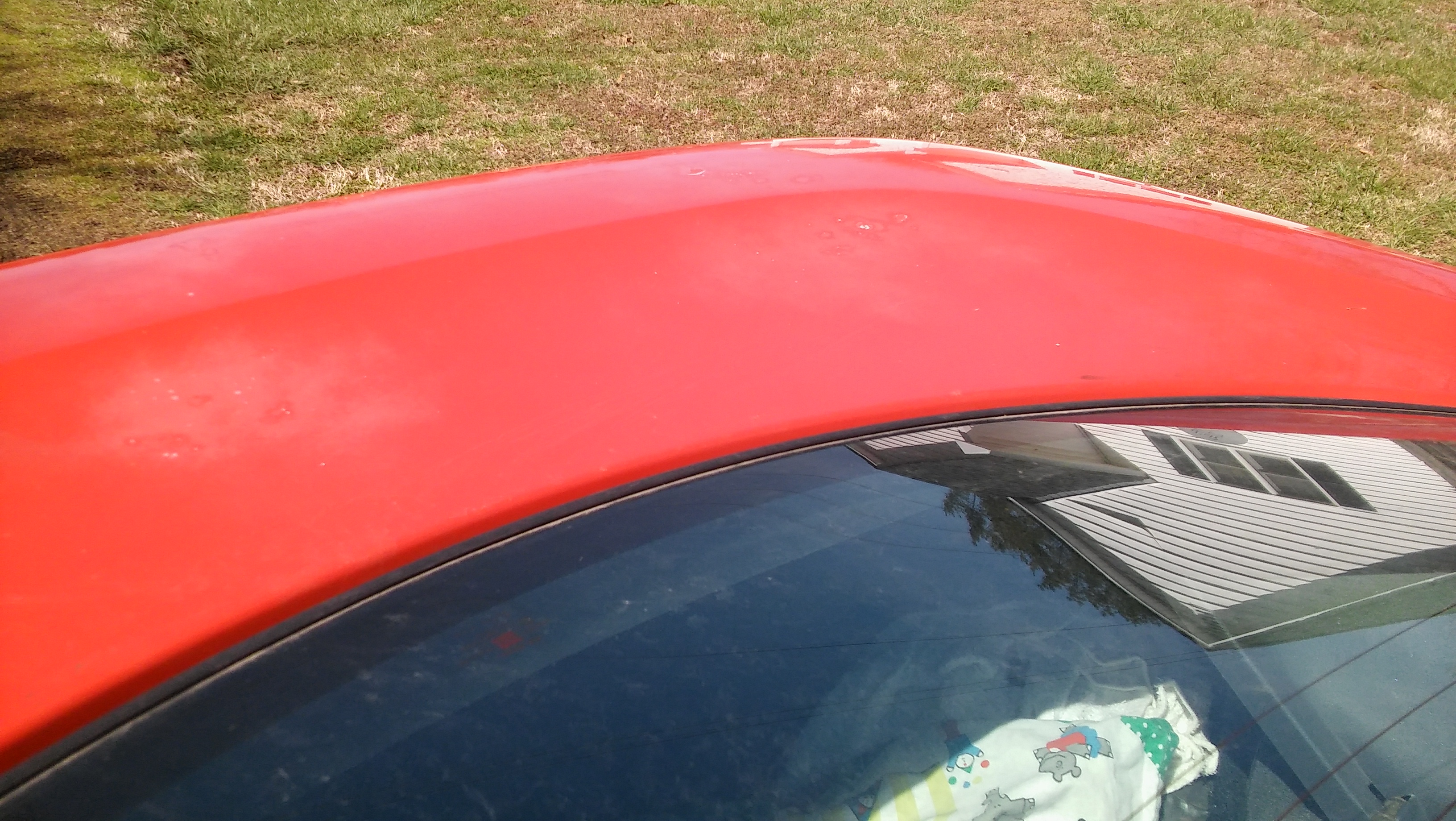

Two Lane after seeing your more detailed pictures and realizing the extent of the decay to other panels of the car that would require blending clear coat into bare base coat, the task would be fruitless. All the money you would spend for a very subpar paint job would be disheartening.
On the other hand I understand your concern over originality. So clearly you have a decision to make, but I well give you one more idea for thought. I don’t know if you’ve ever seen a wrapped vehicle? I have we had a few done at my work for testing purposes of identification of customer products. This process, think NASCAR, that’s how their cars are done, if done right looks like a paint job! It’s cheaper than paint, can last 10 years or more, offers a bit of protection from small stone chips, but best of all in the end you can peel it back off right back to the original finish. Some folks do this to a brand new high end car to persevere its original state and value.
