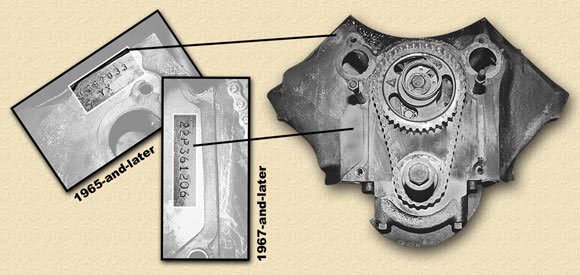

Are you trying to determine if one of these blocks is the numbers matching block to your car? If so, refer to the chart below. The numbers you are looking for are located on the front of the block, on the passengers side, at the bottom near the timing cover.  It should start with "2" for Pontiac, the next letter indicates the assembly plant the car was built at, and the last 6 digits should match the last six digits of your vehicles VIN #.

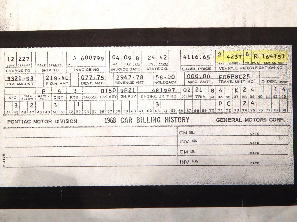

There are two stamp pads on the front of the engine block. On one side you have a nine digit number that starts with a "2" (for Pontiac) with the remaining eight digits being the last eight numbers of the cars VIN. This is a pic from my late great GTO...
You can see they match the last eight numbers of the VIN (highlighted in yellow)...
