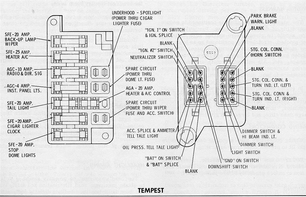

'67 Tempest/Lemans/GTO Fuse block
1967-pontiac-fuse-box-diagram-SgFMdHQ.jp

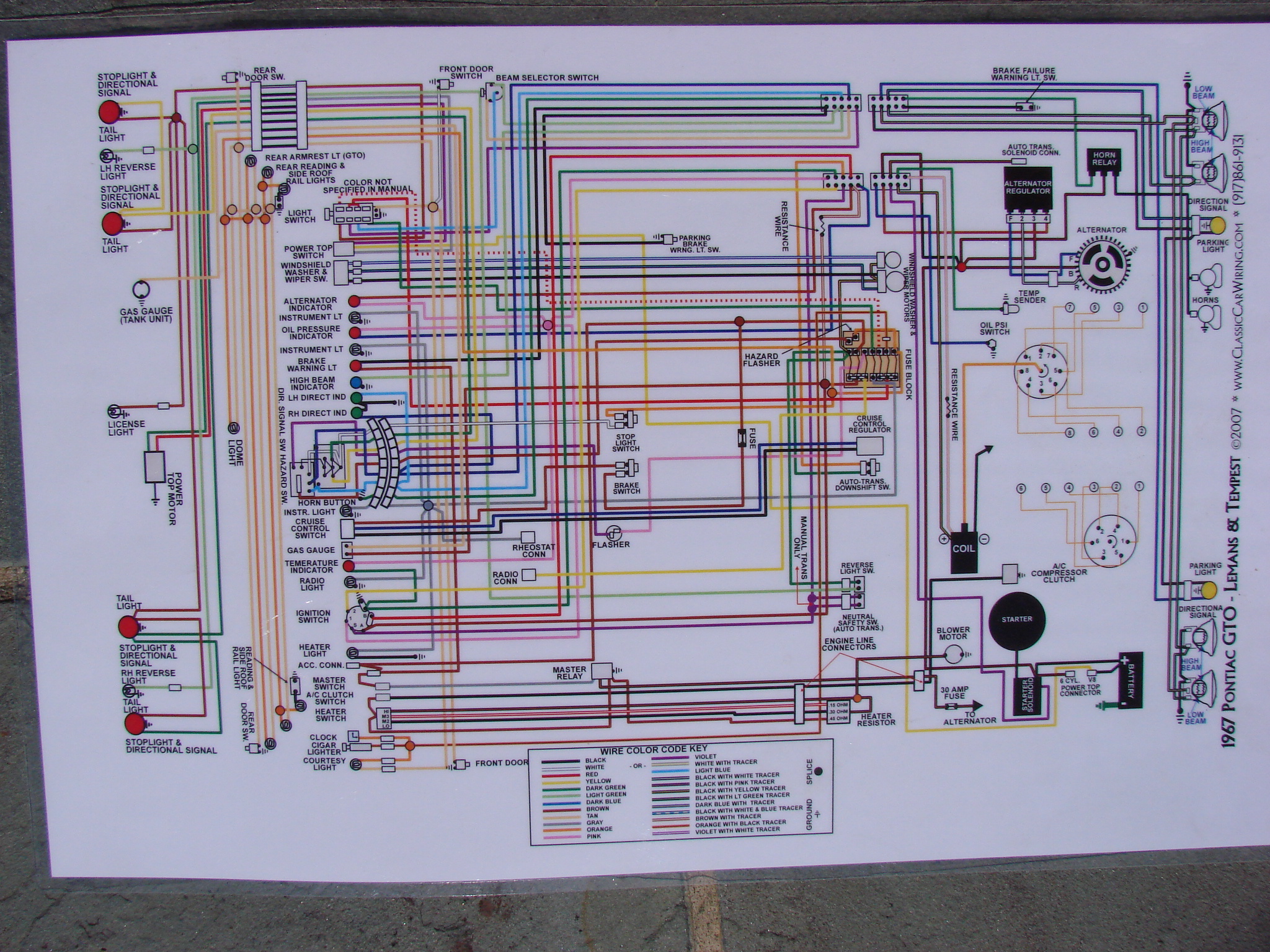

Wiring diagram from a '66 GTO - You want the Courtesy Light circuit at the bottom, lower left.

This problem will be caused by contact of the white wires to door switches with an earth source. Yellow wire has constant power and white goes to ground when door switch activated. So white  wire is damaged and touching the body somewhere.
yip sure is, 👍
