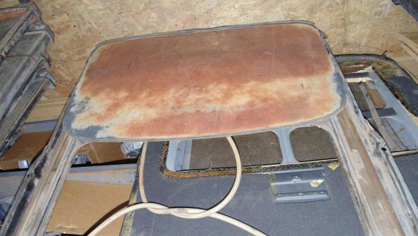

Much better after I finally broke down and pulled and completely rebuilt the distributor, and everything in it... ha ha. From the pickup coil to the plugs, all electrical ignition has been replaced. The MSD advance kit had great weights and springs inside it, and I chose to go with the medium springs. Now, I'm working on the choke thermostat,pulloff,etc.... The walker unit that I ordered through O'Reilly was backwards (in the way the spring cup was facing) so I have to send it back. I am still unsure of what that exhaust efe flap does, and whether or not it'd cause issues (or whether it's open or closed if I leave it disconnected from the vacuum line) The plugs were fine except for the outer 4 (1,2,7,8) which were all blackened with way too much fuel. Not sure why that'd be...? I am hoping that since those Delco's were in the engine throughout all of the carb and fuel pump and filter work that maybe the new set will burn cleaner. I do have a bent idle mixture screw that I am having a hard time finding. I found the original ASC sunroof but the guy wants like a grand for it. (pic attached) Will keep working on her after the rain stops, then she'll have to get into storage for awhile while the overtime stretch at work goes on until next year...
