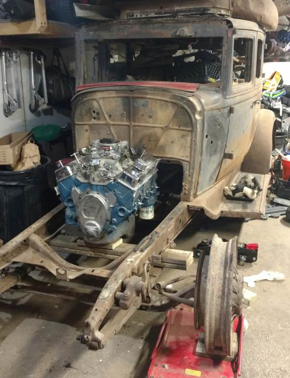

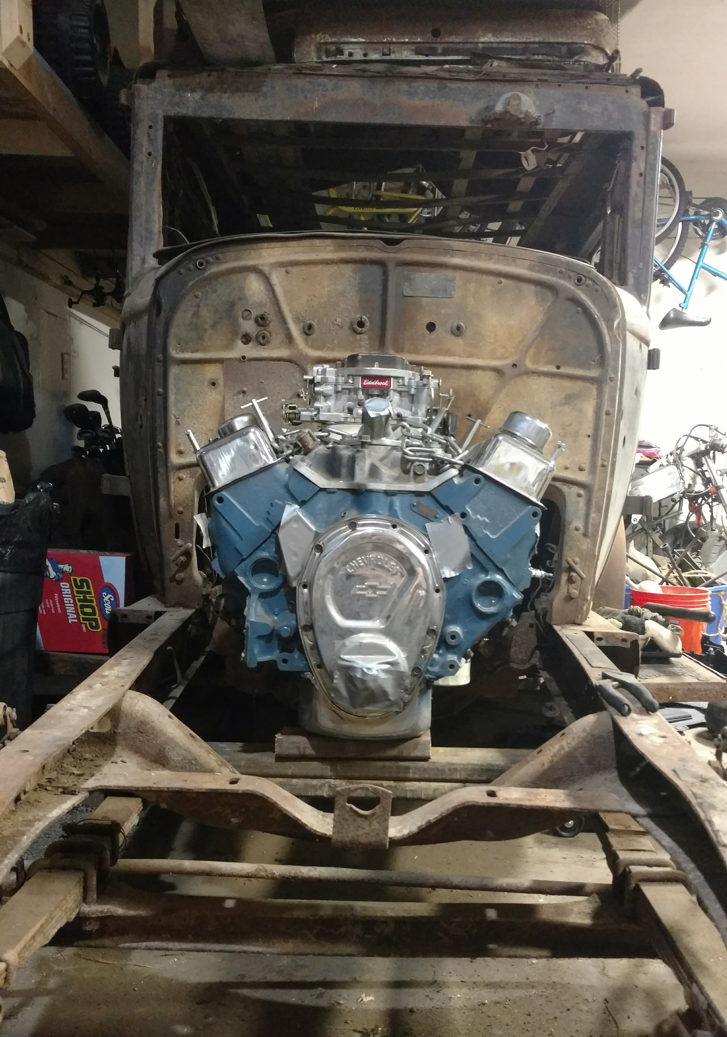

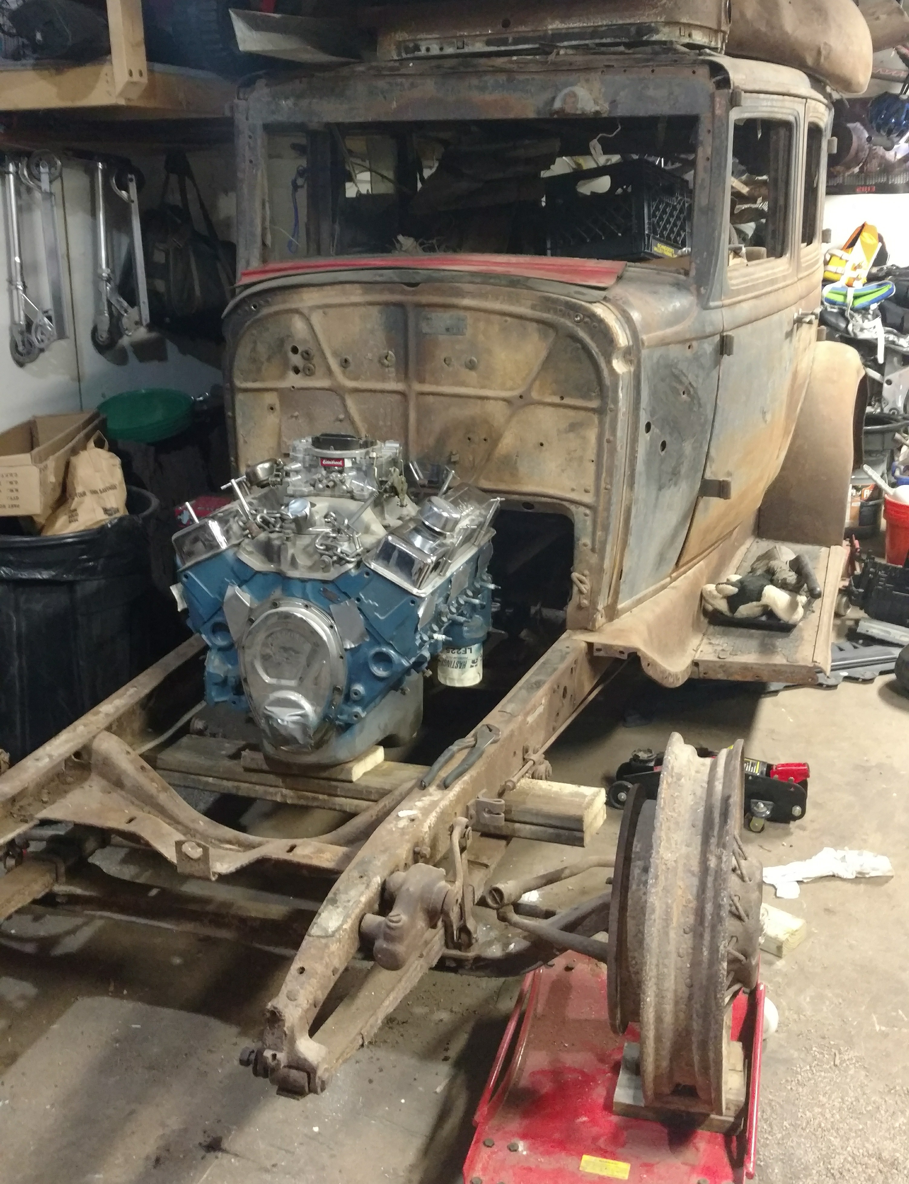

    Look what showed up today! My wifes birthday present! (This car is for her if i ever finish it) $750 for new radiator, fan shroud, and electric  fan with wiring and temp sensor. Makes the shroud
Thought y'all would like a little update. Its not a huge step but it paves the way to getting motor/tranny (turbo 350) seated and rear end mounted.
I have an S10 limited slip disc brake 10bolt rearend that is within 1-2 inches of stock width.
Once engine and rearend are in place I will need to replace the leaf springs and order a drive shaft. Though im thinking I should maybe wait on that till I have the steering figured out.
Then our next step will be to find a steering setup that we like. I've meet one person the put a power steering unit infront of the axle. With a couple universal joints.

Thanks for sharing.
So what kind of steering system is the other person got? A rack and pinion set-up or a more traditional power steering gear that is mounted forward of the axle?
6 hours ago, Frosty said:
Thanks for sharing.
I wish I knew. We only met him the weekend before we picked up this car. But I did find someone that knows him so hopefully I'll hear back soon.

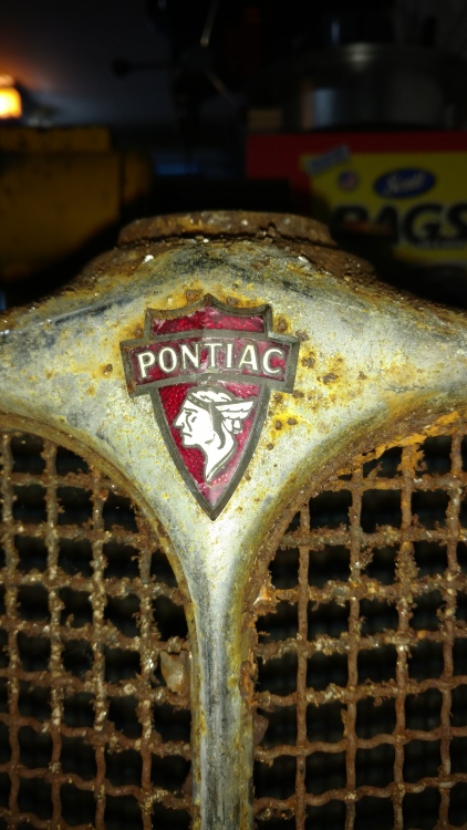

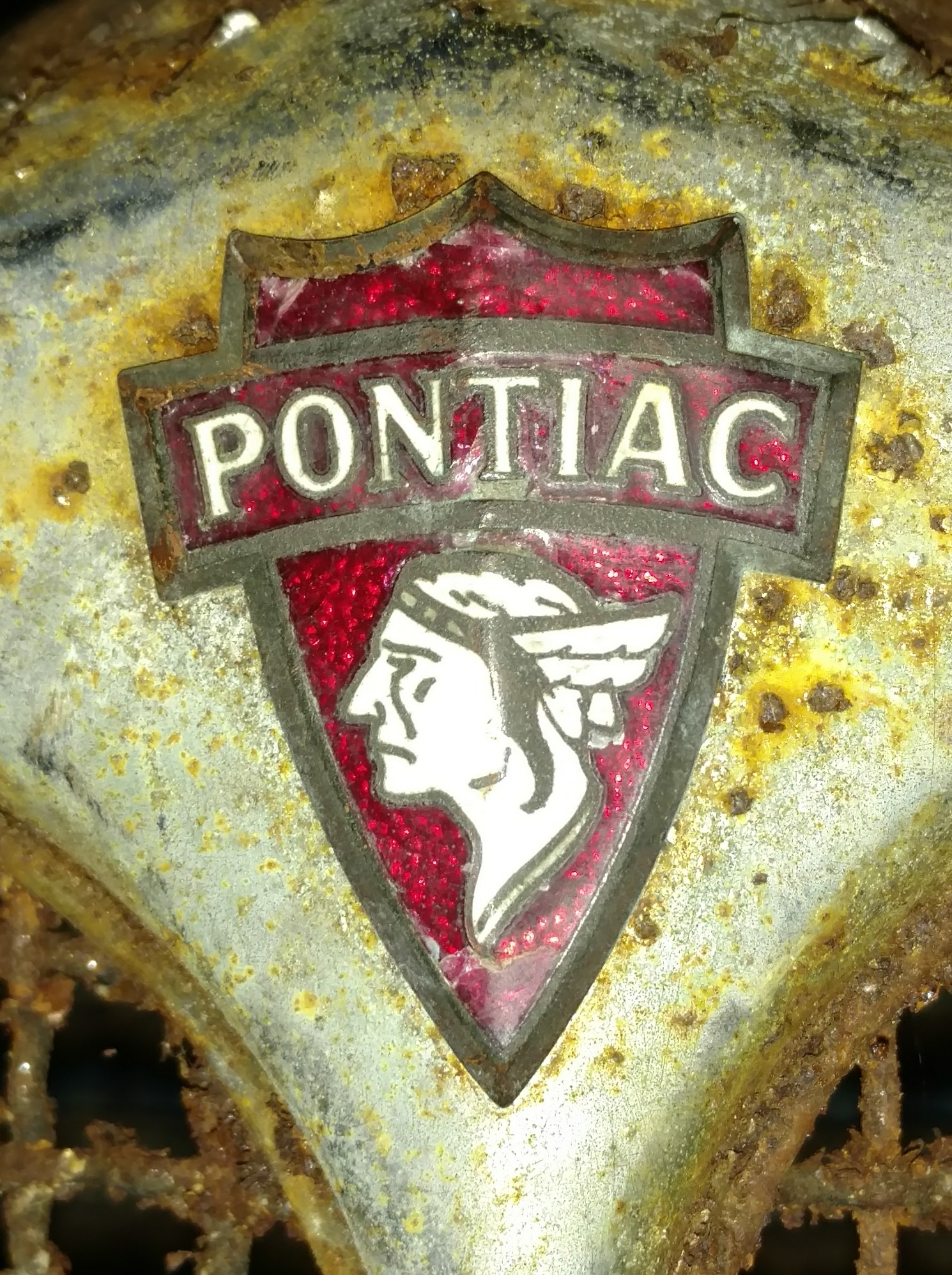

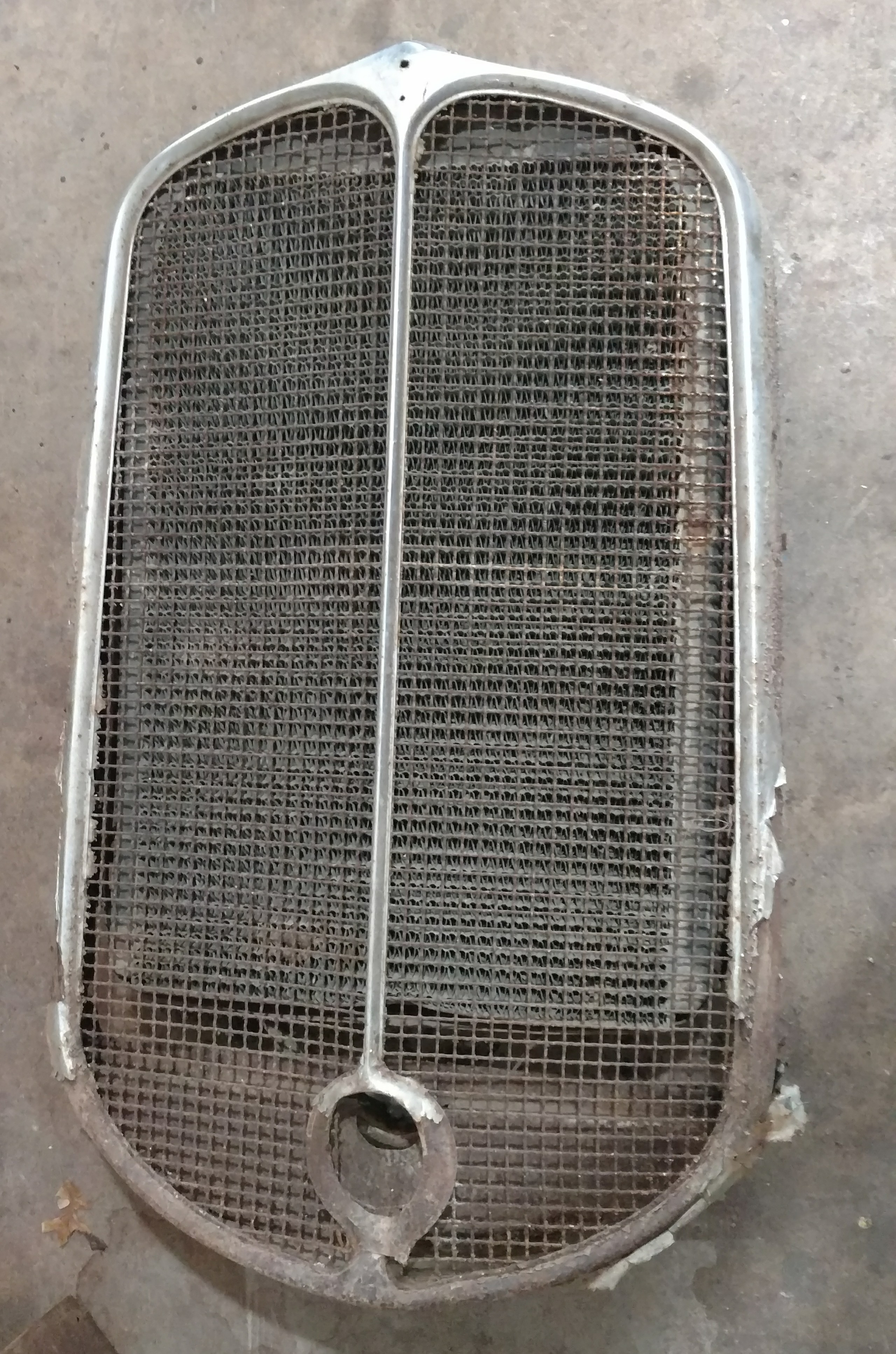

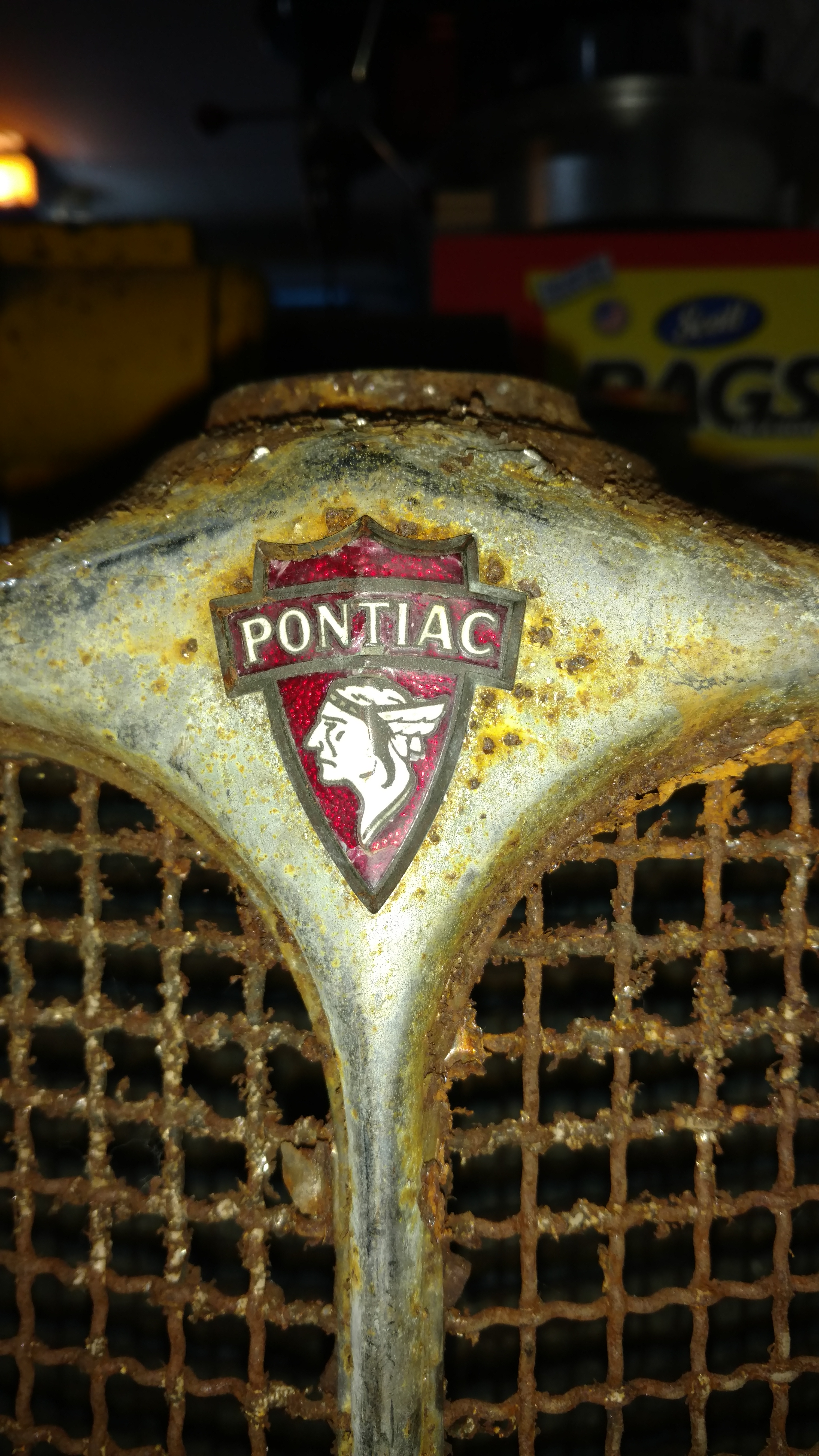

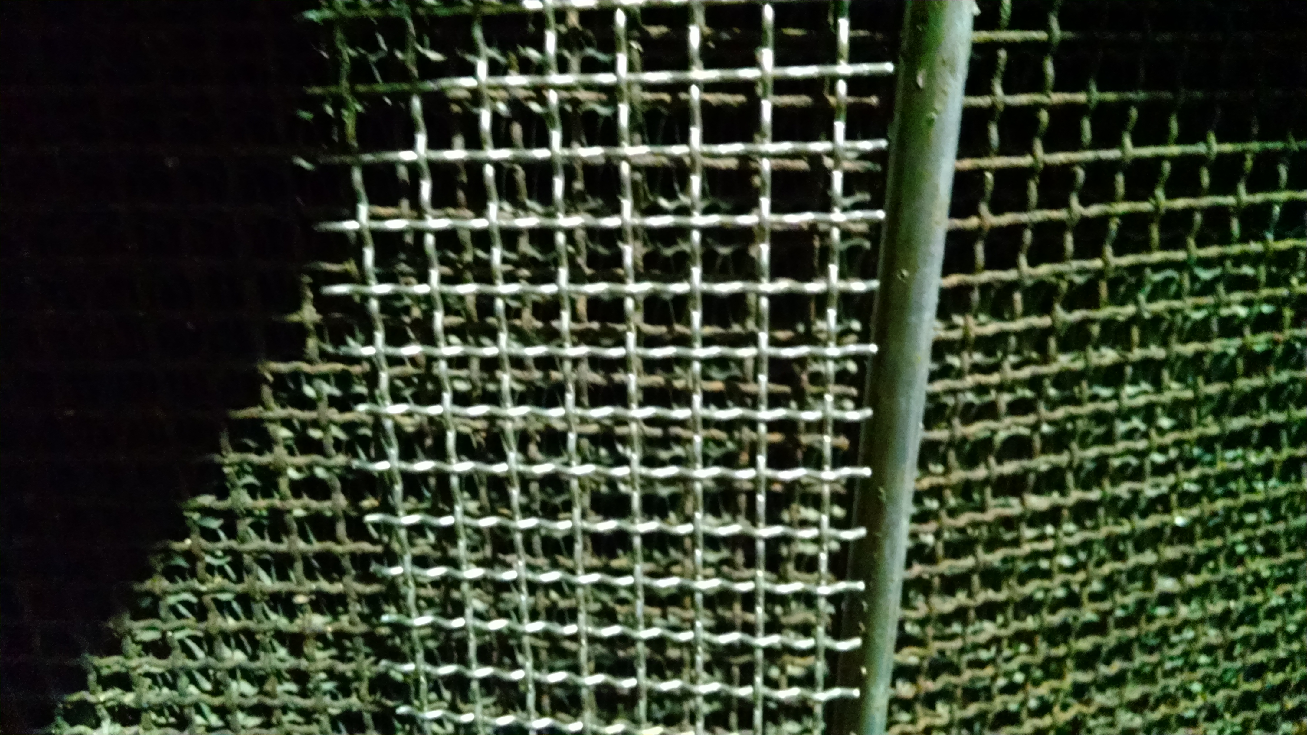

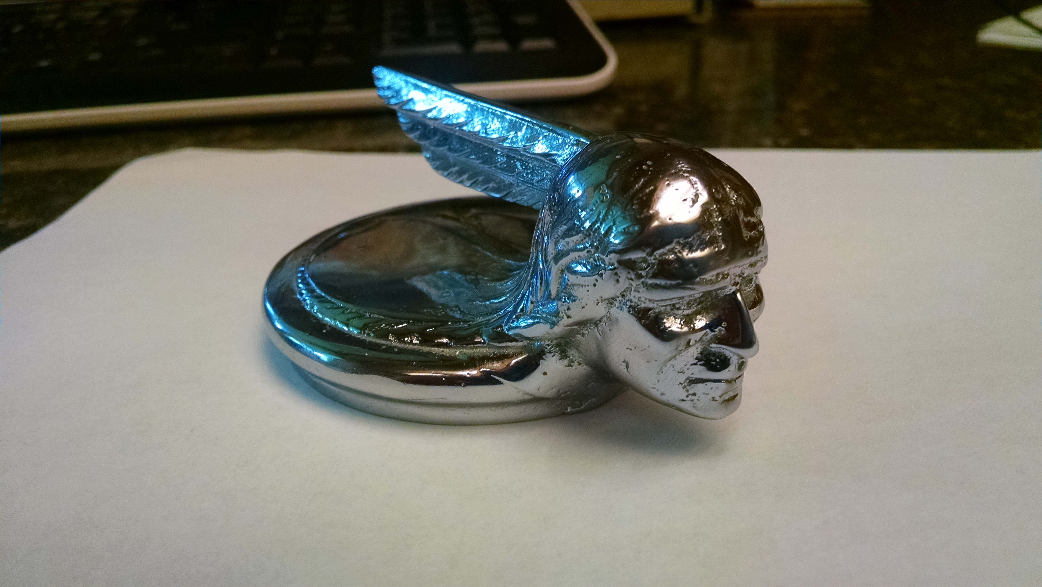

Ok so lets talk about the shroud. Amazingly one of my best friends had some stainless steel wire screening at work that he gave me that is a 100% match the the rusty plated wire in my shroud. So actually an upgrade! The plating has pealed off parts of the shroud. So what kind of prep work do I need to do to have this thing replated? The screen just unbolts as does the old radiator. Brassworks thinks they have a radiator that will work and we will put the fill neck under the hood and bolt the indian head radiator cap in place to the shroud.
The indian head already has a threaded bolt hole on the underside where the clip and gasket attached so its perfect dor bolting down. And this emblem is off a worse shroud that I bought just to get the emblem. Besides the bumpers this was the one piece I was missing.

Ok so lets talk about the shroud. Amazingly one of my best friends had some stainless steel wire screening at work that he gave me that is a 100% match the the rusty plated wire in my shroud. So actually an upgrade! The plating has pealed off parts of the shroud. So what kind of prep work do I need to do to have this thing replated? The screen just unbolts as does the old radiator. Brassworks thinks they have a radiator that will work and we will put the fill neck under the hood and bolt the indian head radiator cap in place to the shroud.imageproxy.php?img=&key=7a632d757925bc26imageproxy.php?img=&key=7a632d757925bc26
Cowboydanny, the chrome plating company will need to chemically strip the old chrome off of your grille shell. I have tried to remove it by sandblasting and sanding, neither of which worked very well. They should also be able to do any metal repairs prior to plating.  Also,  look for a shop with a good reputation and be prepared for sticker shock. For chrome plating, you get what you pay for.
Thankfully this car does not have a lot of chrome. Pretty much just this shroud. And I have some companies that we work with on plating so I'm hoping that will help.

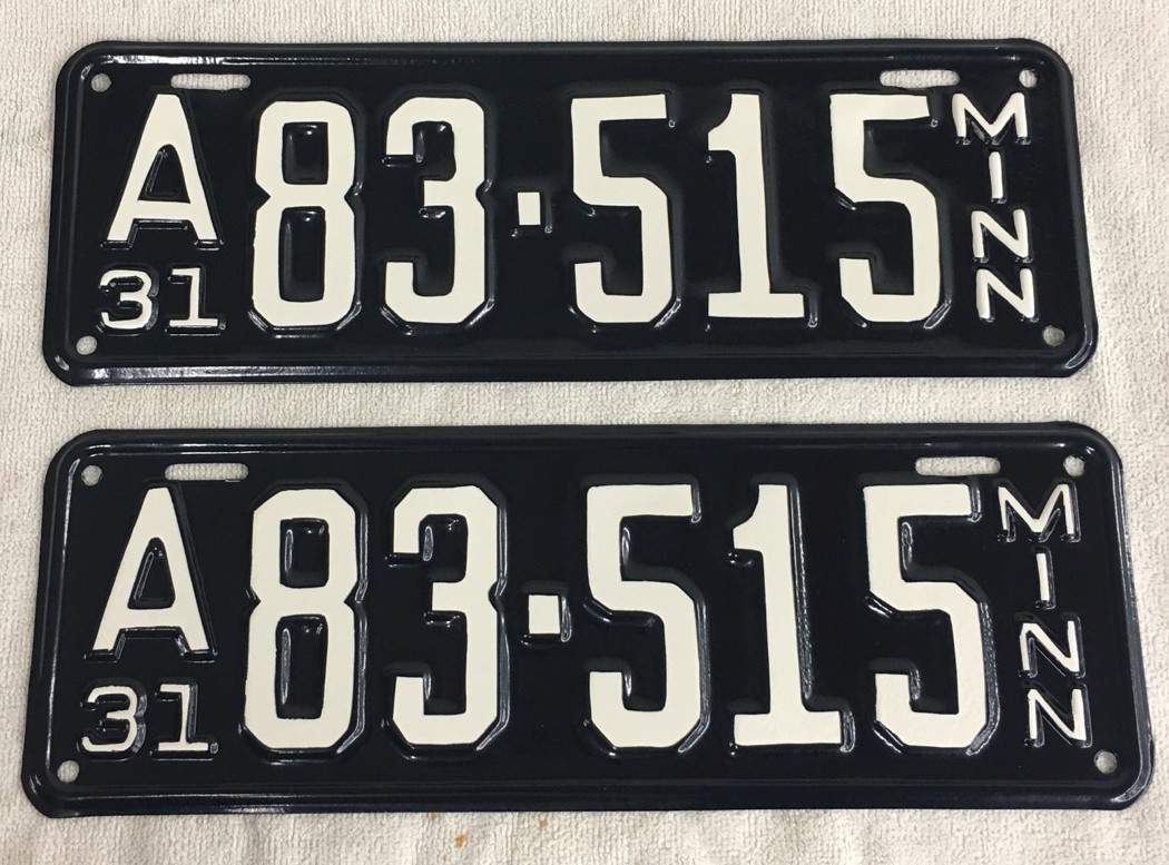

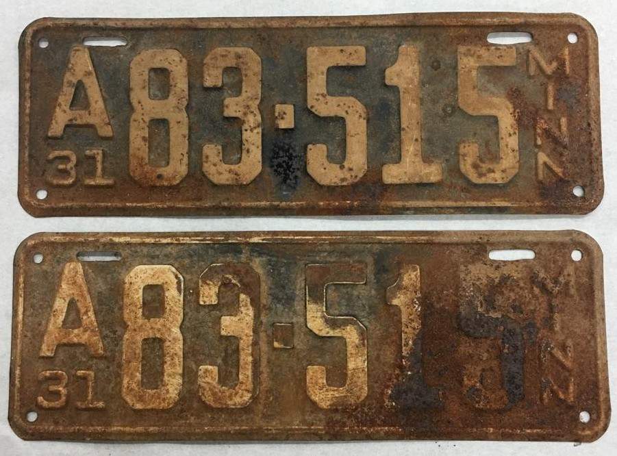

Found some original 1931 plates. Had then restored by the guy that will be doing my paint. I gave them to my wife for our anniversary and she loves them.
You have a really good painter there. He clearly took his time to sandblast, rust encapsulate, high build primer, and then paint it back to near new condition.

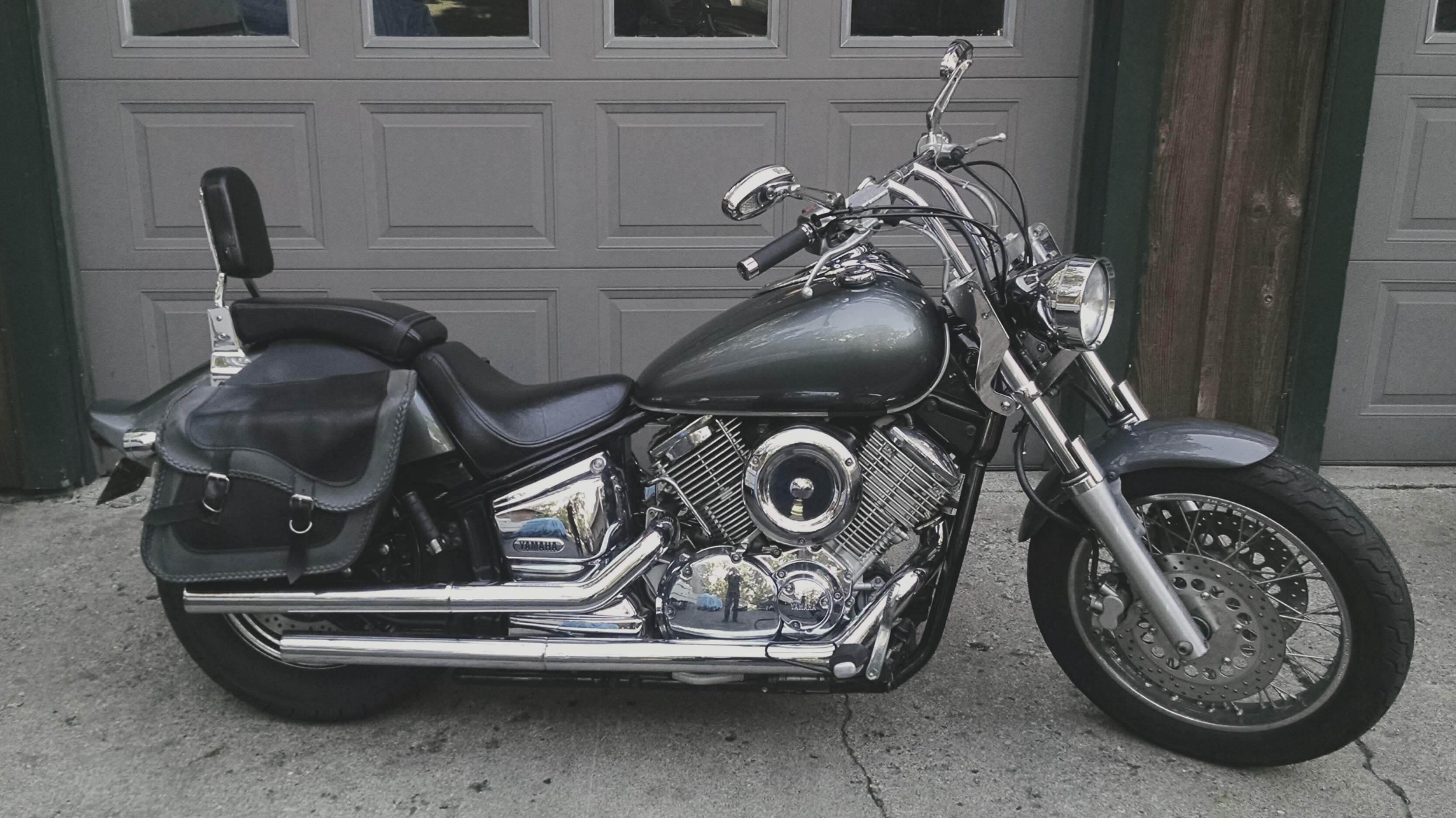

Yes he is very talented and under paid for his abilities at his day job. This is my v-star 1100 he painted a couple years ago. There was a large dent on this side of that tank he pulled out, pressure tested the tank and painted it and the fenders to a pearl grey. He will be doing the Pontiacs paint as well. Possibly the same colors. That is a 1931 GM blue and 1931 antique white paint colors.
