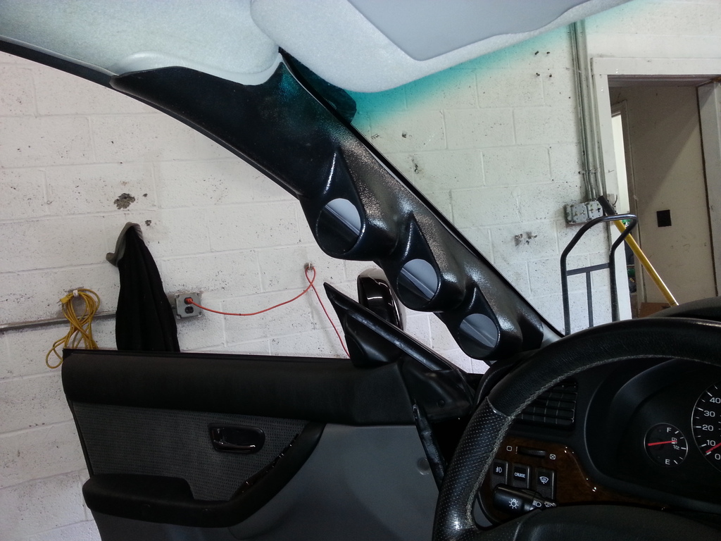

ok tossing a pillar pod in the outback and i'd rather weld the two pieces of plastic together than use screws or rivets.. anyone have any experience with epoxy or anything i can use to weld the two pieces together. one is a stock piece from a subaru and the other is a pillar pod..

the pillar pod is made from ABS plastic..don't have the pieces at my house right now. but what ever is used to make interior pieces in a subaru..
Mismatched plastics are notoriously hard to glue up. I'd pull the pillar, take a bit that's normally tucked under an overlap and on the inside of it, clean it with rubbing alcohol, abrade it with medium grit sand paper, and see if your favorite epoxy will stick. You've got to get all the mold release off it or nothing will stick. The sand paper will give it some tooth. Might be enough.
is it gonna be actual plastic welding or can JB Weld do it?
what ever works and will hold up and not separate later on.. i was planning on maybe using what ever it was to bond the two together and then color match the whole thing as close to the stock color as possible.. the black kinda stands out..if actual plastic welding is easier and will stand up better i'm not against buying a plastic welder within a reasonable price of course.

it's the light tan that's inside the car..the camera makes it look grey..i looked at semproducts.com and could not find what i was looking for/maybe i was looking in the wrong section..
well i found this place just now and it looks like i'm going to have to either go out to my car and bring the pillar piece inside or bring the one i got home to match the color.

nope can't find a thing listing the colors other than gray and beige..looking at my pic i'd say it's more along the gray side ...
i'm leaning towards the 15083 silver from the chart they sell for 1.00

the one from my car is the bottom piece.the grey one..
