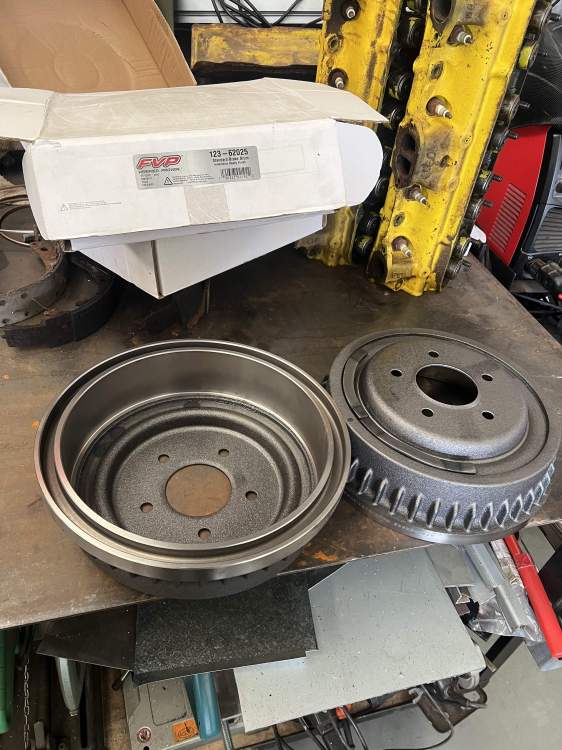

After a lot ! and i mean Alot for searching with mr googles help, i find that from mid 1964 all body pontiacs where fitted with the heavy duty finned drums !

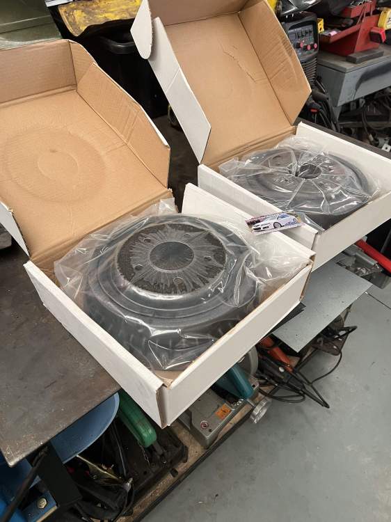

i hunted high and low for raybestos 2265r drums and no one had any ! seams that they have stopped making them !!! BUT fvp suply them !!
the part number for anyone hunting in the future is 123-62025.

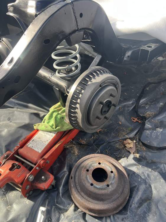

And thanks to rockauto, i have a pair of brand new correct drums for the rear of my 9.3 inch girl!!. they are the correct depth which is 100.2mm and thats very important ! as there is a 116mm version which is for later model diffs
these new drums are heading straight to my brake shop to have the shoes relinned and matched to the drums. so i am very excited to be making progress !!
