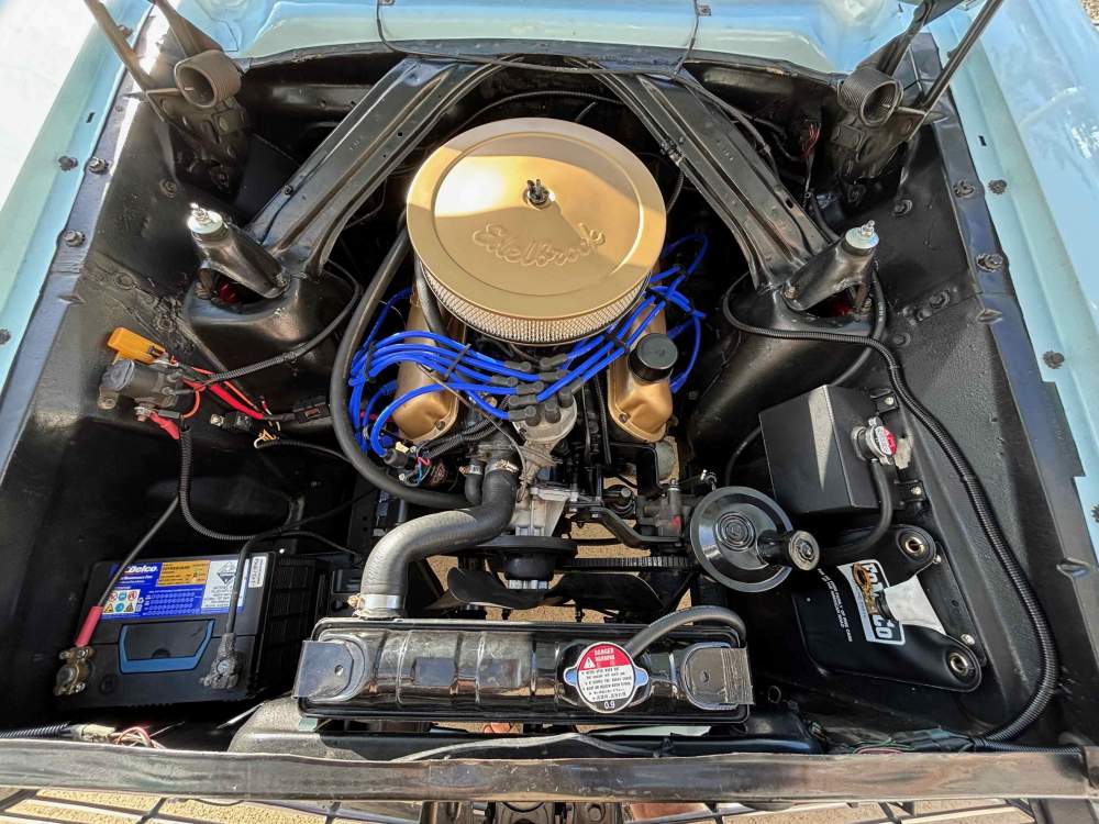

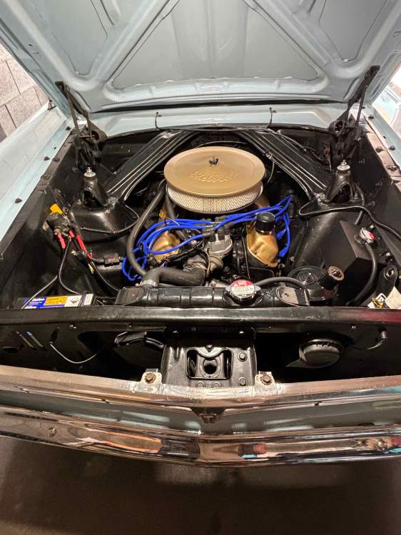

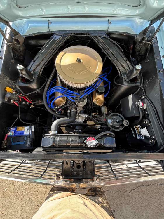

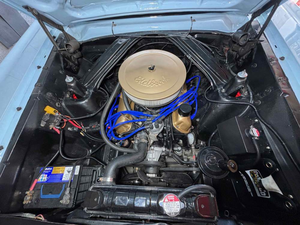

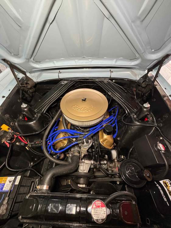

I've spent some time doing some upgrades to my new '65 Sprint, which have turned out really well.
  1. New front seat belts, as the passenger side buckle had been damaged by being caught in the door at some stage. Personally, I'm more than happy to keep my better half close to me, but evidently she was a tad worried about escaping in the event of an accident or fire. Fair enough, I suppose...
  2. Put on a set of Bangin' Headlights. As you'll all remember, I absolutely love these products. Plug and play (for real!), Aus made (great company to deal with), great price, amazing light output, glass lenses, look exactly like the originals, and are Aus complied (e-marked).
  3. Built a coolant overflow system for the car
  4. Installed a fuel cap lock, as the oem cap is pretty special (and I suspect regularly stolen as it is just a twist on)
  5. Replaced the standard plastic fuel filter with a serviceable 30 micron fuel filter.
  6. Fitted a Pertronix module to the car (after how much it improved the Bonneville, I almost consider it a necessity rather than a nice to have). I ended up doing a full install, so the improvements included a new 100A 1 wire alternator, Pertronix Ignitor 11, a 45,000v Flame Thrower coil, new plugs, and a set of Eagle 9mm leads, and a drop base open air cleaner.
  7. I also ran new fused wiring through a relay, to minimise the load on the oem ignition (I didn't do this with the Bonneville).
  8. Oh, and I repainted the oem rocker covers and painted the new air cleaner lid to match.
  9. Had a couple of new mufflers installed, and some decent chrome tips (sounds much deeper now)
  10. Finally, tidied up a lot of the wiring in the engine bay to neaten things up.
    Wow - what a difference. It feels soooo much quicker off the mark, pulls a lot harder and idles so much smoother. It seems even the auto shifting has improved a little?
    Spec changes are:- plug gap .044" (up from .032"), timing 14 deg BTDC (was 8 deg BTDC), 36 degrees all in at 2800rpm.
    The cart only weighs about 1300kg, so you can imagine...

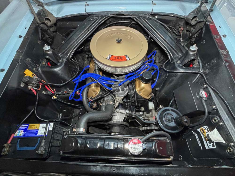

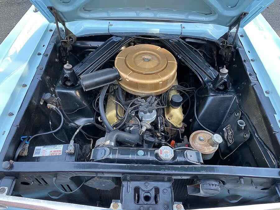

    Photos of the work attached, of course. I've also included a pic of what it looked like before I started, for reference. Plus a few more photos of the car for you to admire, simply because it's so cool.

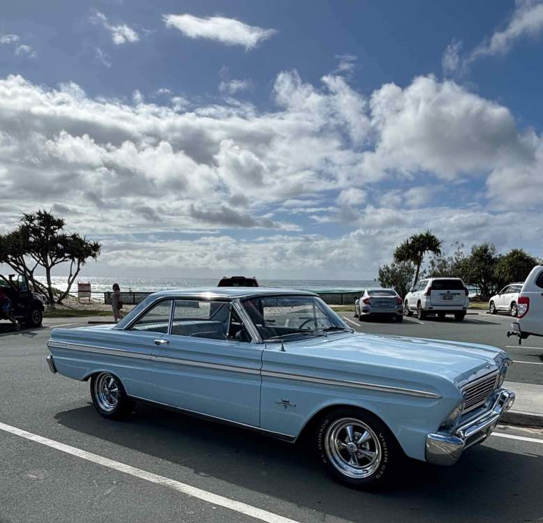

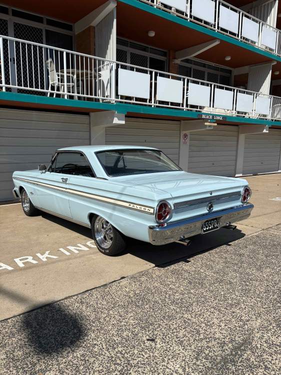

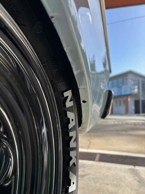

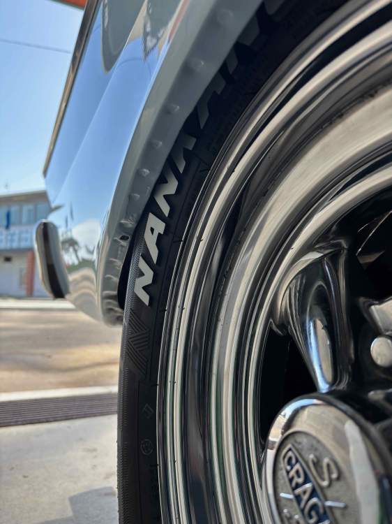

Just wanted to show off my new tyres - had a failure with one of the tyres it came with😬
I ended up fitting 215/60's (up from the 195/60's, which fill the guards so much better, but I now have a rub on the passenger rear I didn't have before🙄
After a lot of measuring and comparing there is no more than ¼" difference between left right, so I'm suspecting that the bigger tyres have just highlighted a minor issue I already had🤷‍♂️
Given I've done a bit to stiffen up the front with the 1" lower HD coils and 1" sway bar, I figure I've transferred a lot of extra movement into the rear, which is original and standard
Planning to get the rear springs reset and stiffened, which will hopefully give me back enough to stop the scrubbing🙏🏼
Photos because you like 'em😎
