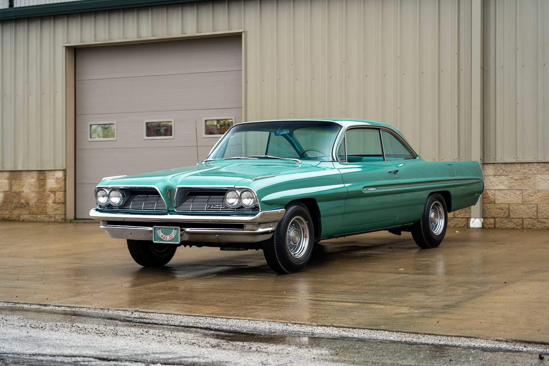

How to match JADESTONE green 1961 Pontiac paint?
Folks, after several tries, including some company in the UK, I cannot source a rattle can aerosol to even come close to the original Jadestone green.
Solved by B52bombardier1
  • Solution
That would be Ditzler paint code "DDL 42837". Take that code to any reputable automotive paint store and they can mix you up a rattle can in maybe 20 minutes. They can give you a sample on a spray out card to take home for comparison and possible adjustment to the color before they actually complete your order. This would be a single stage mix, not a base coat / clear coat recipe. This will NOT be in lacquer which was the original chemistry of GM paint back then.
Around here, that would be maybe $35.00 and their recipe for this blend will be printed on a label adhered to your can for future reference. That paint code will also probably cross reference to a Sherwin Williams code or maybe a Dupont code.
Rick
