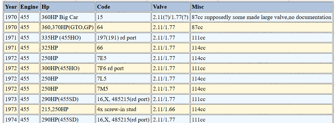

Stock cylinder heads:
You 4xs are 2.11" intake/1.66" exhaust valves at 114ccs. The '73 HO 455 heads, 16x, are round port and have 2.11/1.77 valves and a 111 cc chambers. Here are some stock 455 cylinder heads you can look for and perhaps had some porting done to them as well. I tend avoid the heads with a 1.66 exhaust valve since the 1.77s are available. The HO heads, if you can find them, will probably go for the most money on eBay, Facebook Marketplace, or Craigslist.

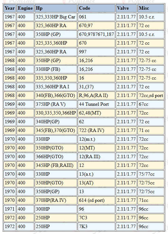

Here are the 400 heads you can also use.....I have a set of 7K3s on my 455. Again the Ram Air and HO heads will command the premium price if you find a set.

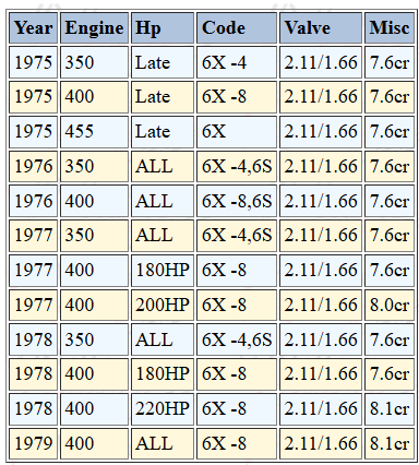

Thanks Frosty for your great info. What do you think about the 6x-4 and 6x-8 heads for my application? Also, given the cam specs of my Butler kit, do you think that this kit is compatible with higher compression heads?
Hi Bird Chief
Here is the stats on the 6x series of heads.
They are a fine head but you are not getting any added exhaust flow compared to the 2.11/1.77 heads. Therefore, my first choice would be to find a set of 2.11/1.77 heads. Now if you can't afford a new set of heads, then using what you have is fine. A lot of guys use these heads.
In order to increase compression, you will need to change your pistons, mill the heads, use a thinner head gasket, or some combination of these strategies. This costs more money and means pulling the engine out and effectively rebuilding it to gain the compression you want. 9.5:1 or 10:1 is a good goal for your engine and it is worth while driving on today's modern pump gas. I do believe that you can re-use your Butler cam. However, if you mill the heads and/or go to a thinner gasket, you will have to double check your pushrod length to make sure they are not too long.
