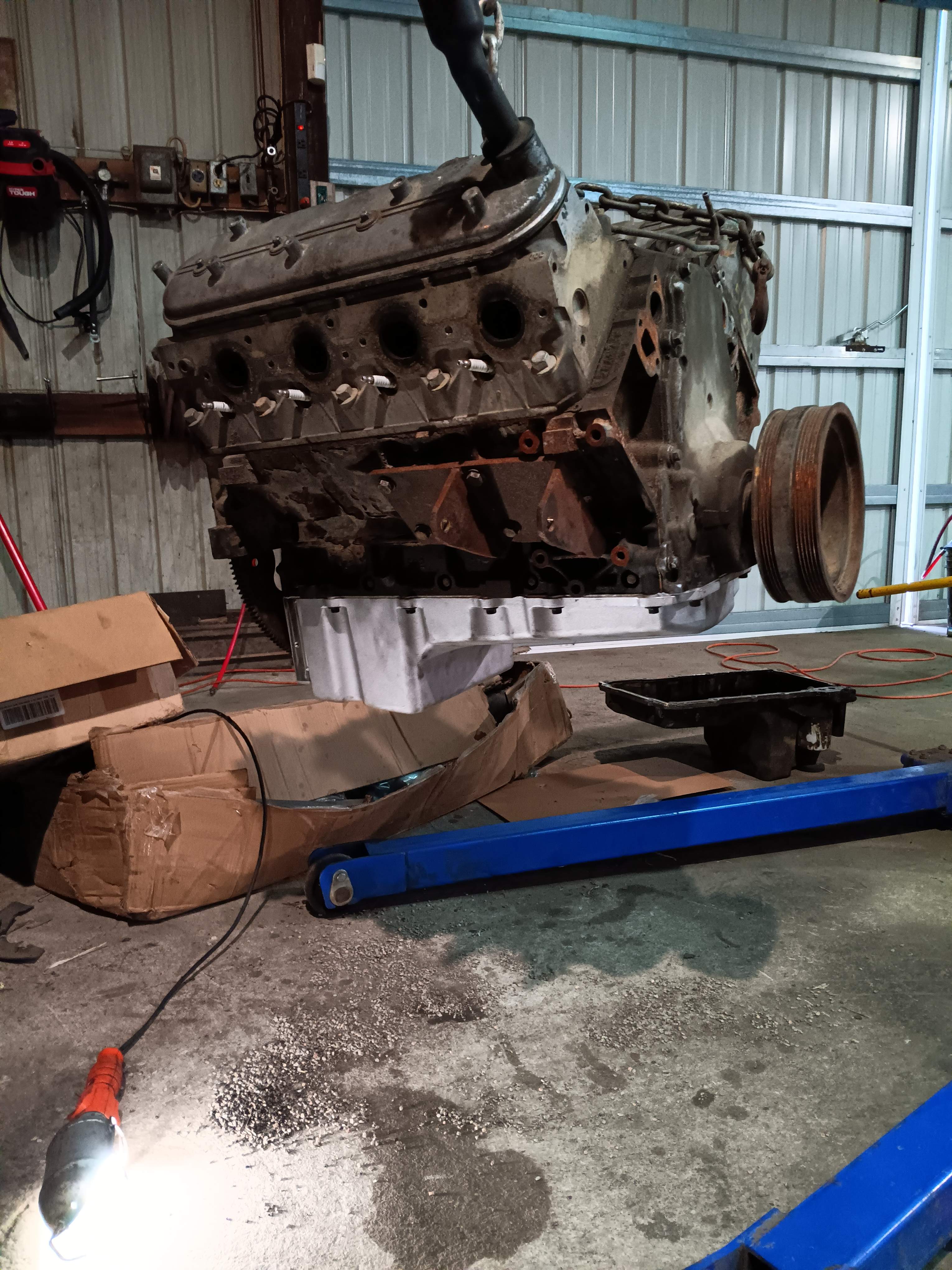

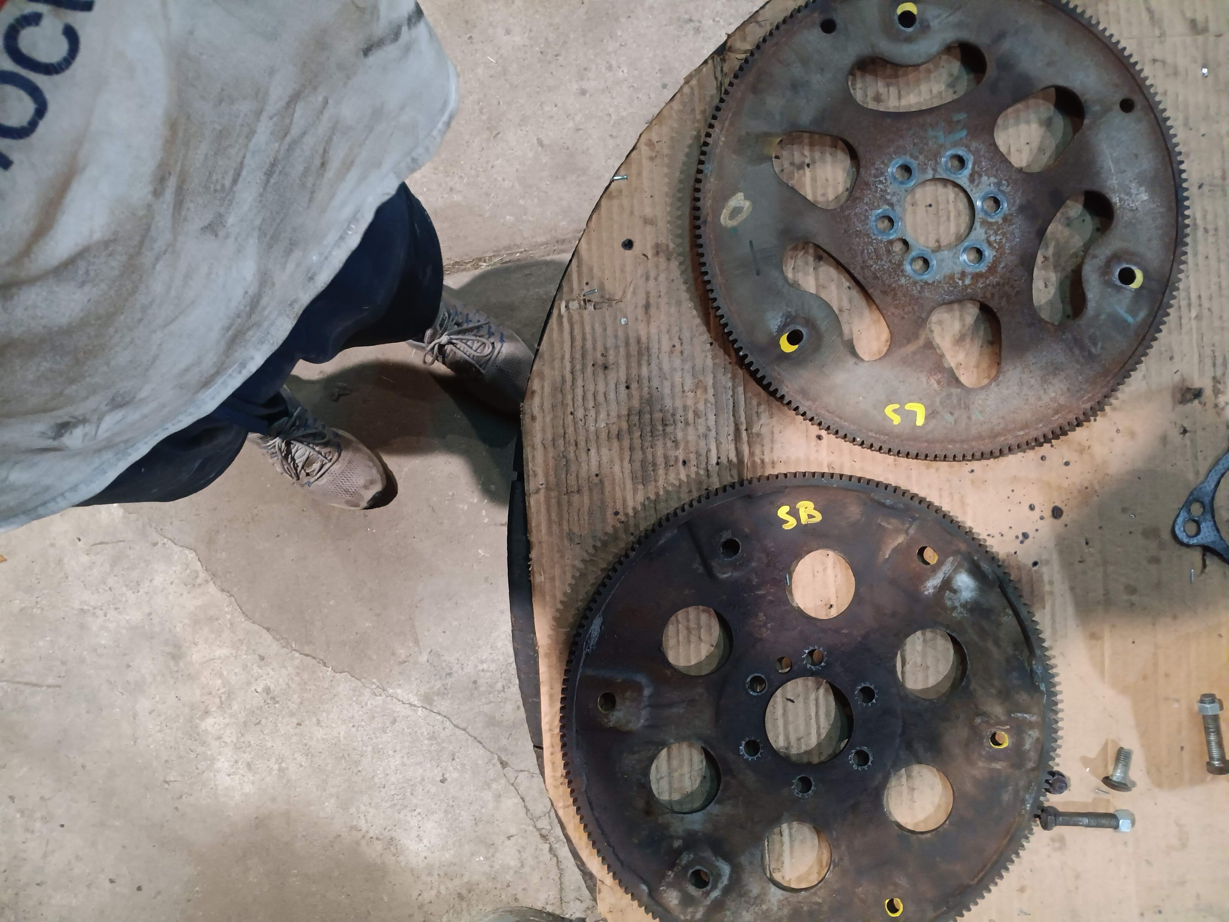

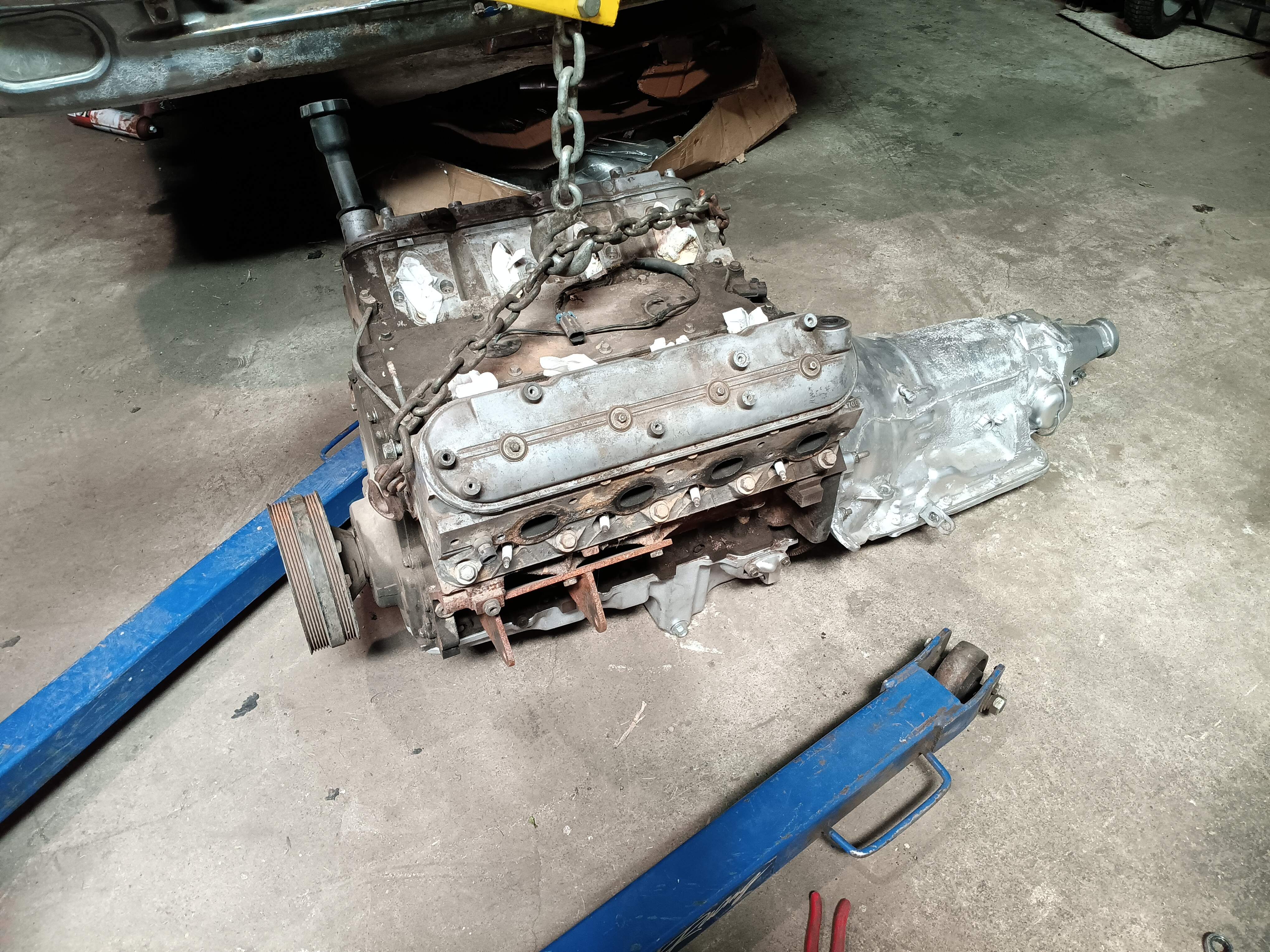

Friday was a pretty un productive day but I got my flywheek all marked up and ready to be sloteted to fit to the tourqe converter on my th350, and I got the underside of my hood fogged down in black, on Saturday I finished sloting the flywheel and bolted the motor and trans back together ready for install, I got the seat back in so I could start mocking up the ammo box I'm using as a center console and got the brakets started.
