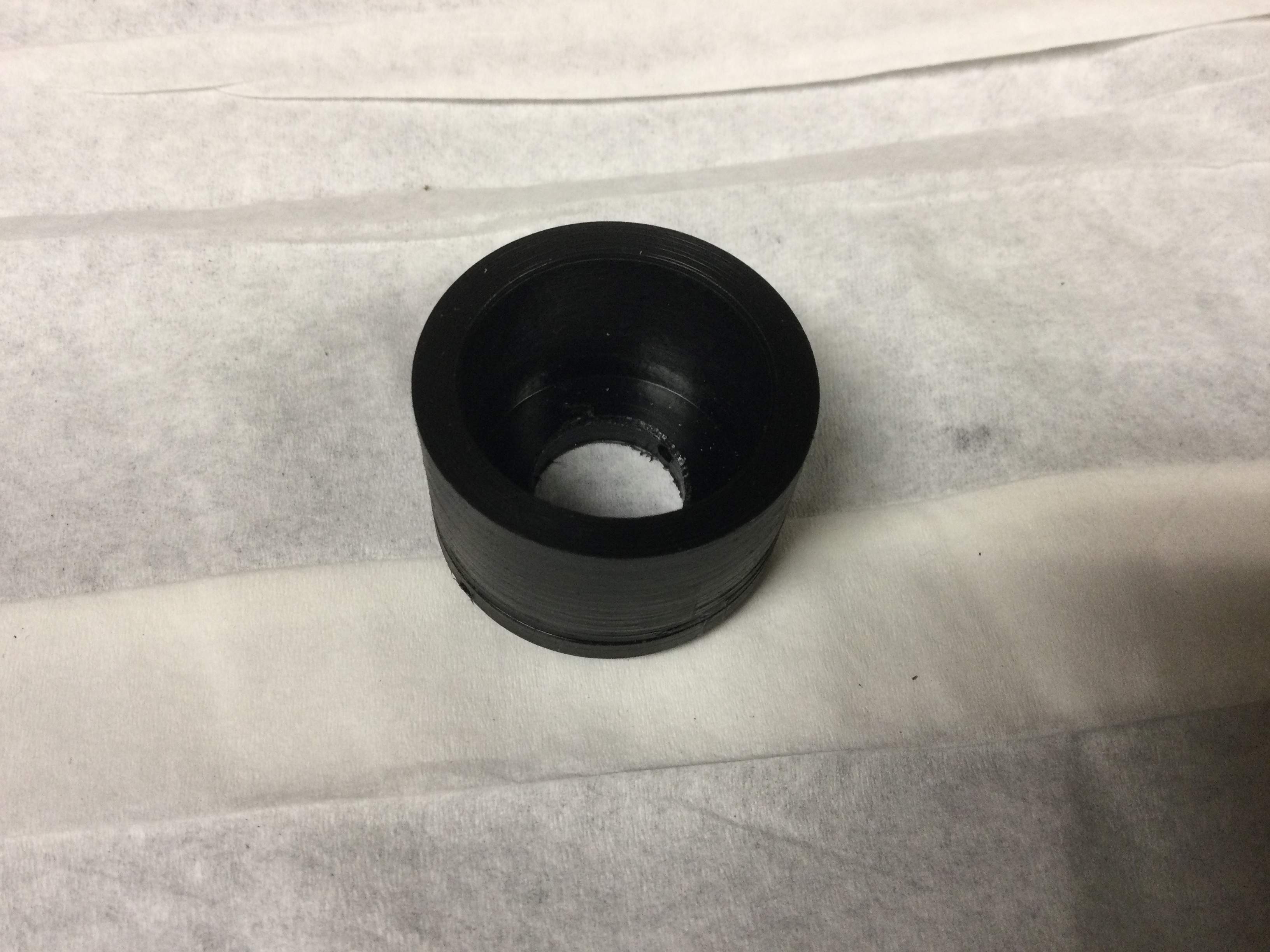

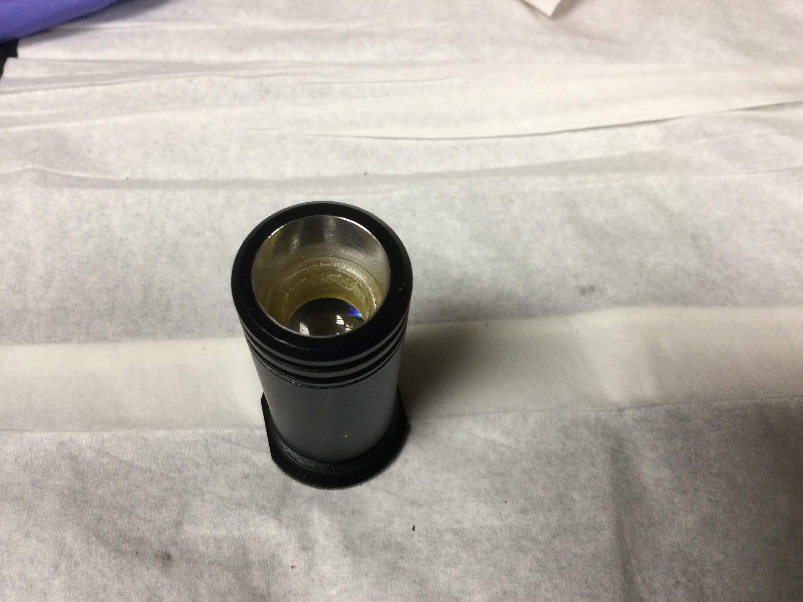

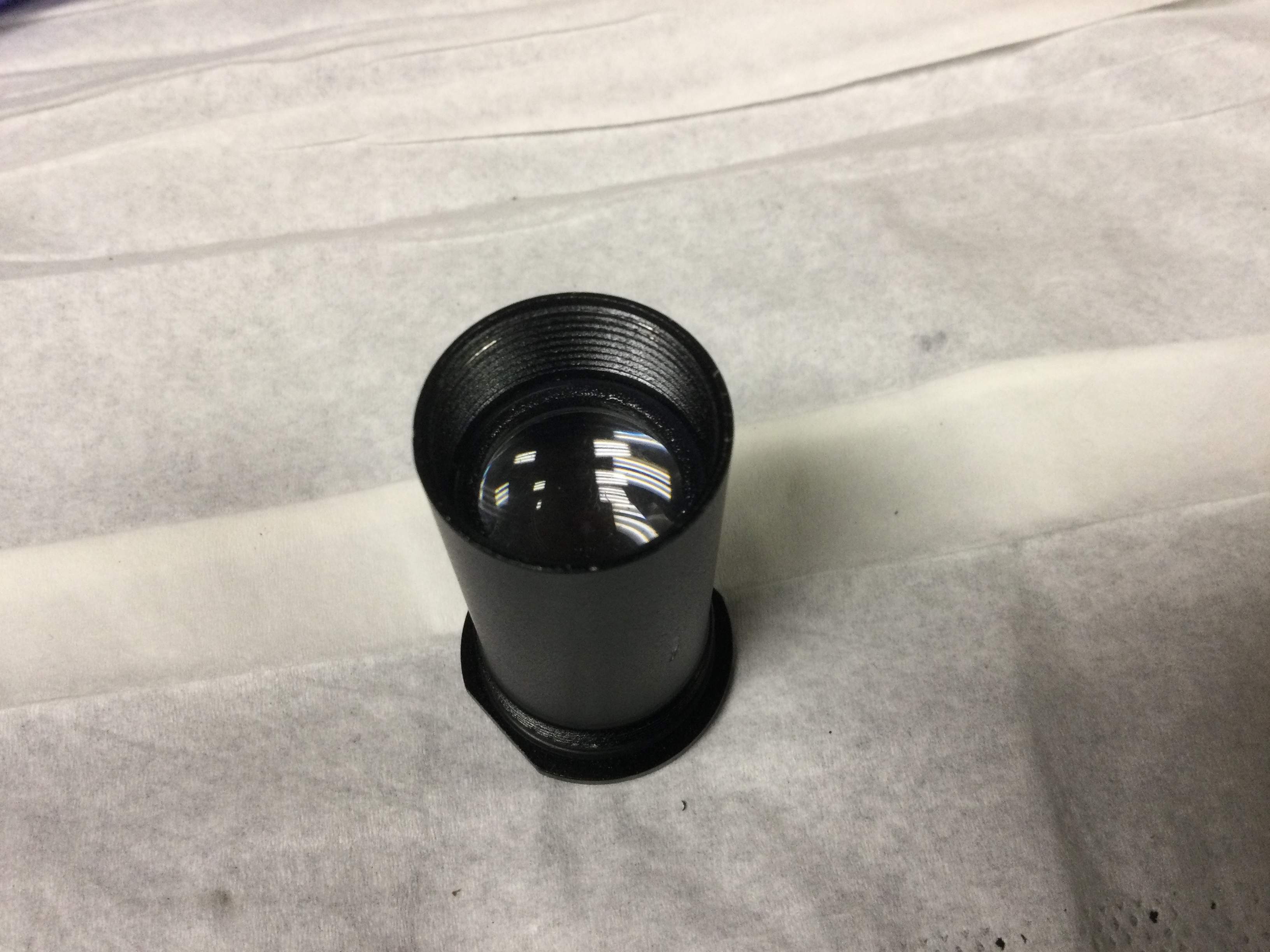

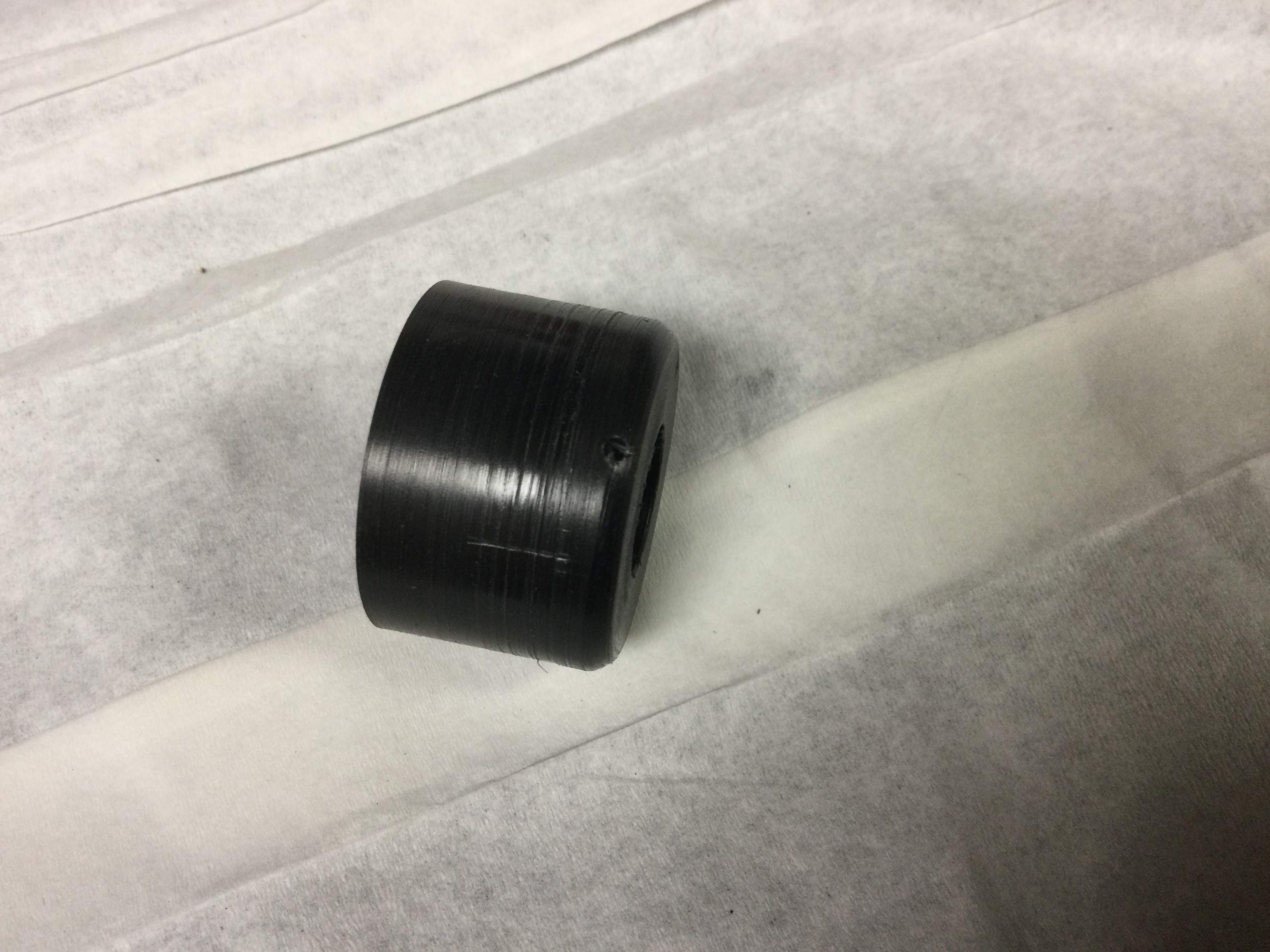

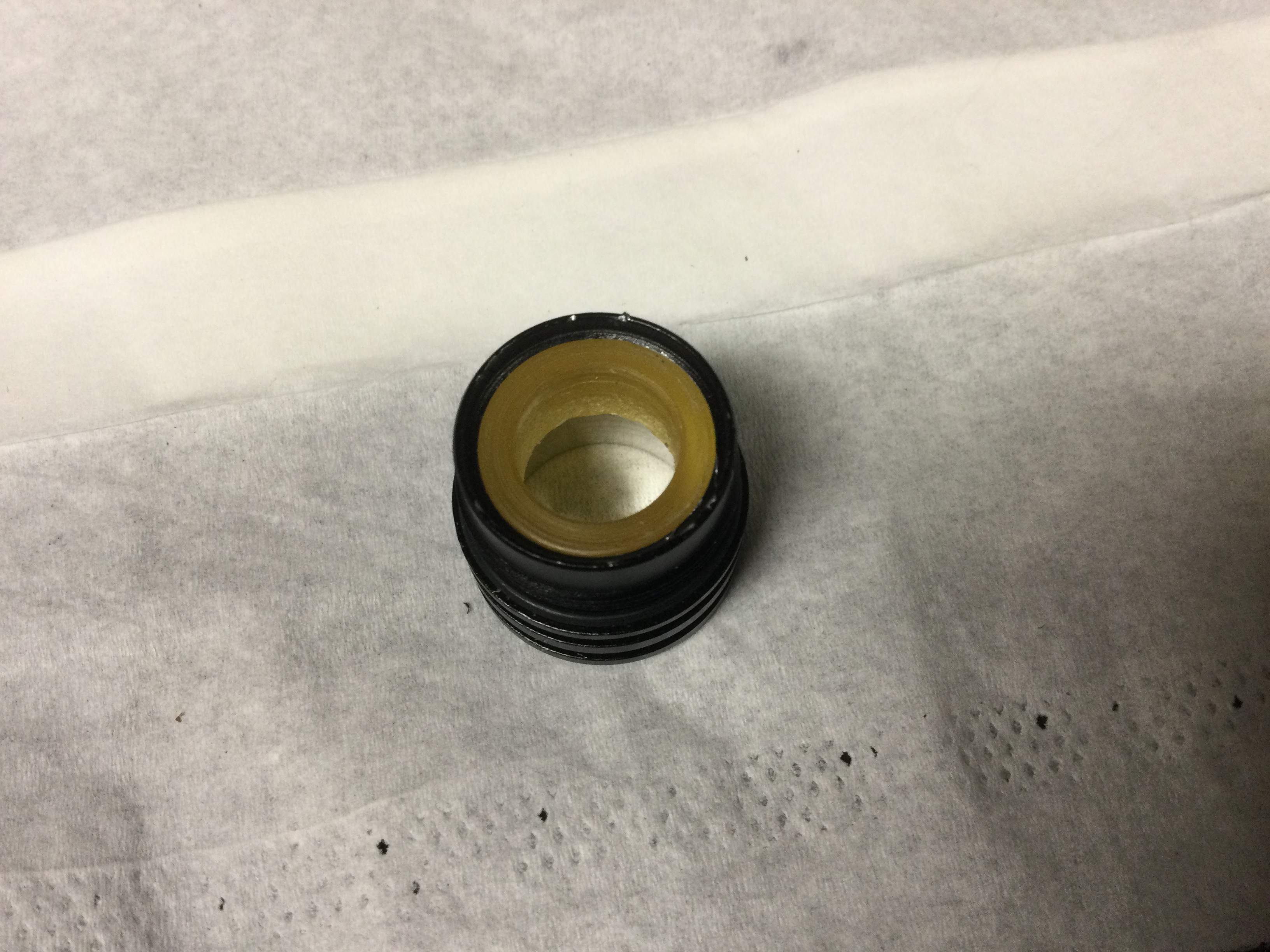

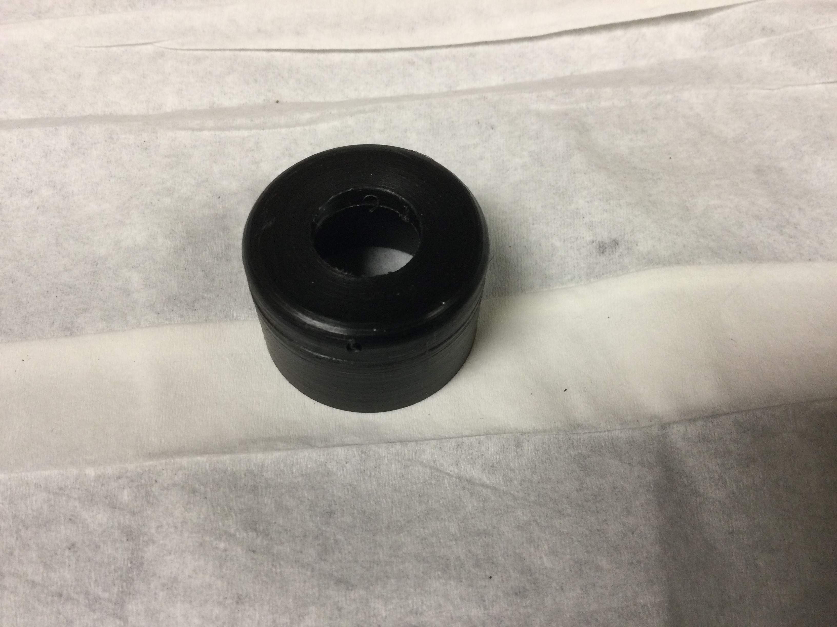

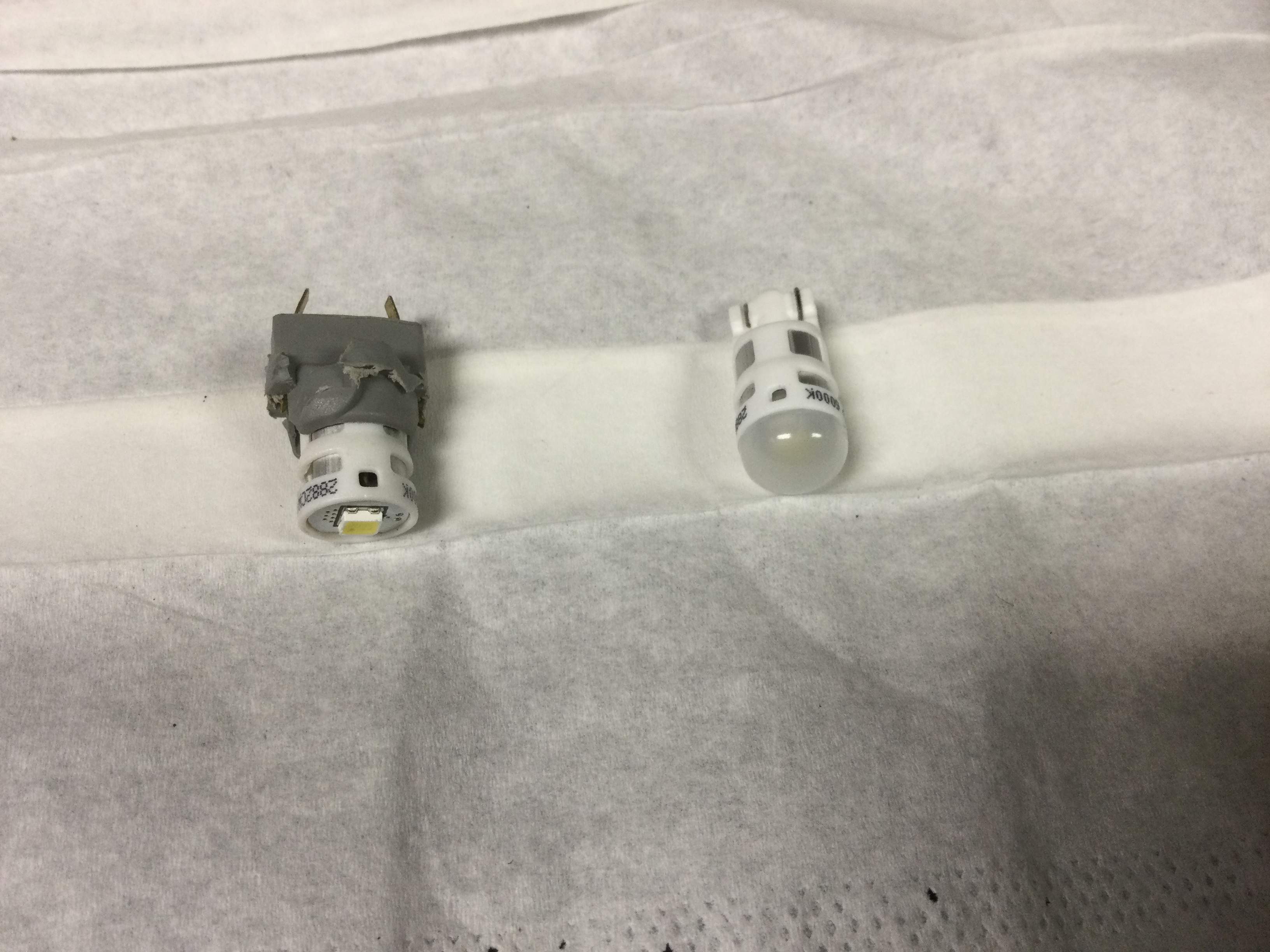

Thought I would post this so if somebody needs to fix one of these door projection lights.

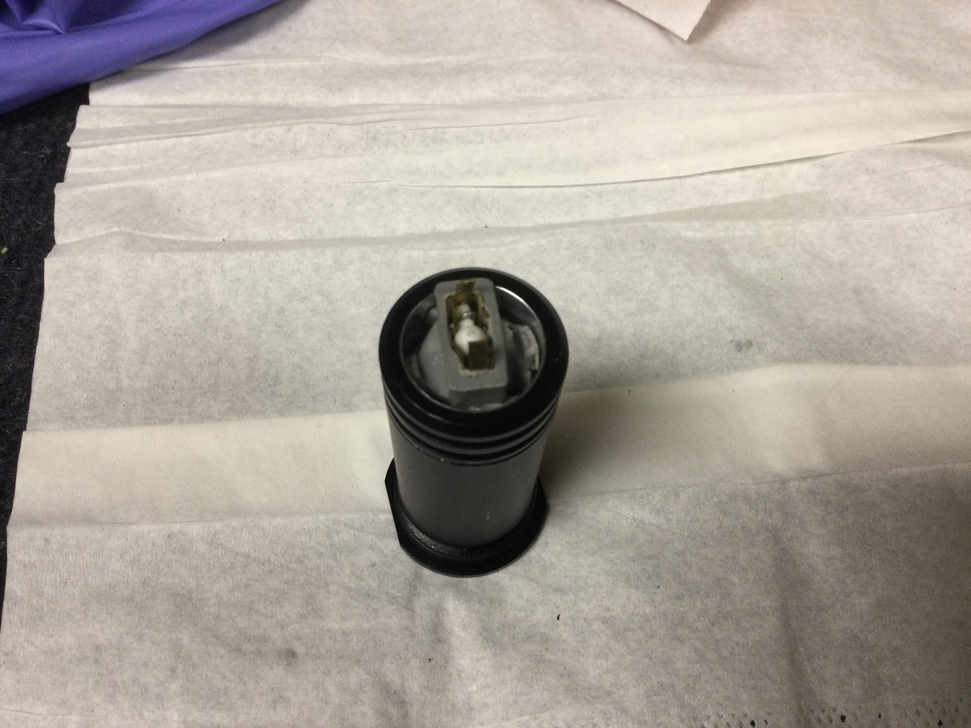

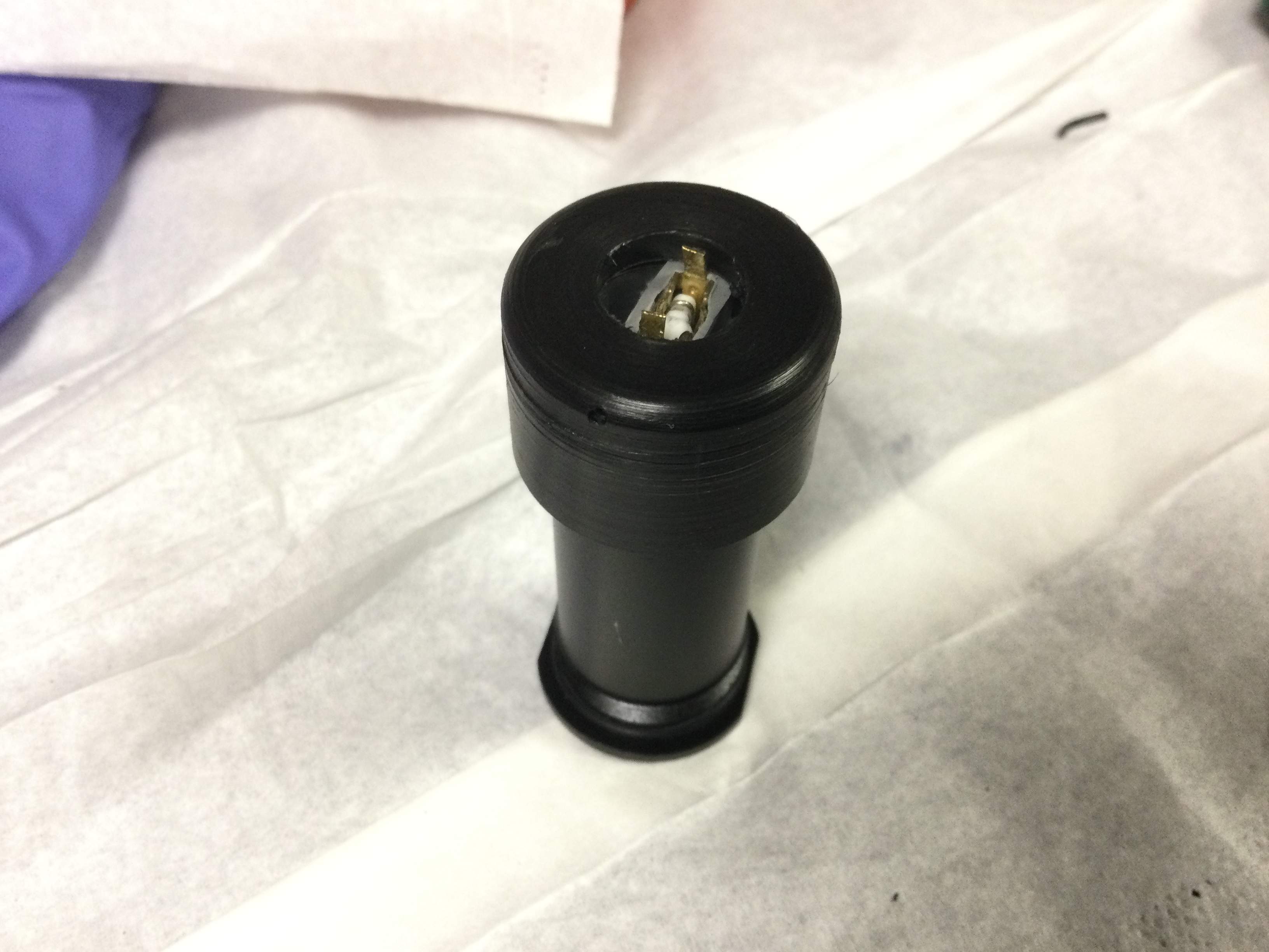

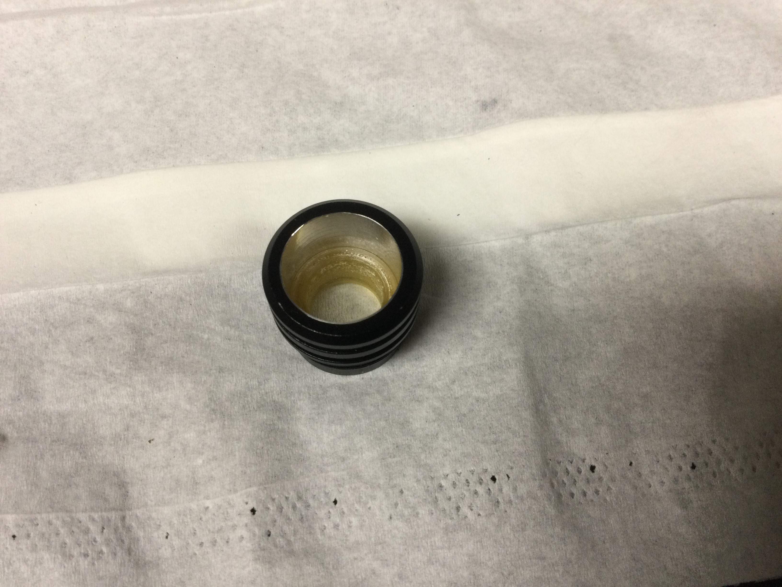

Machined out back threaded cap & made locating insert.

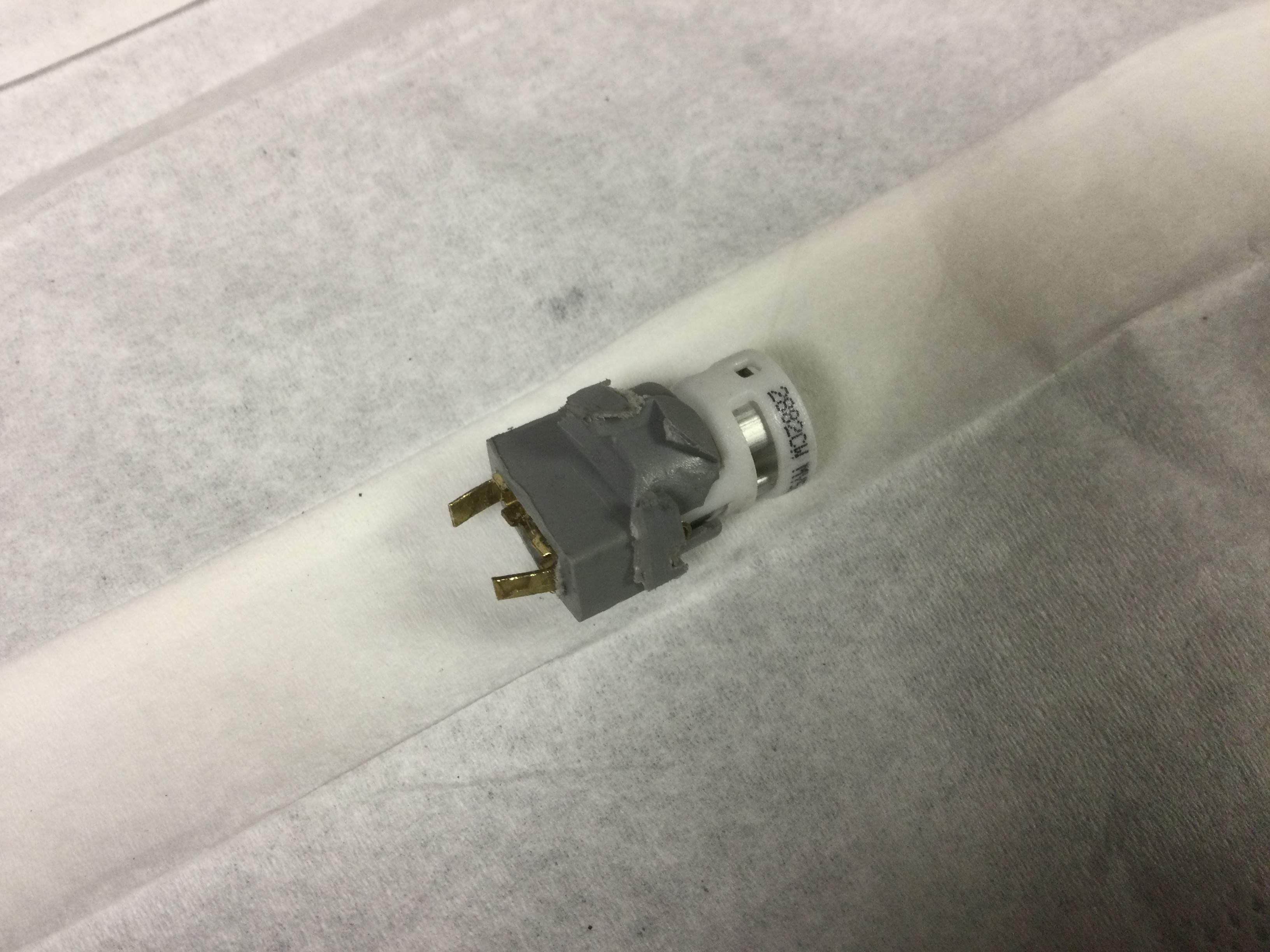

machined plastic retention cap to hold light & socket + attaching wires.

You gave me two. This is for the passenger side. For some reason there appeared to be a break somewhere in the circuitry. Sometimes it worked other times it didn’t. Finally it just stopped altogether. So this was my fix so I could use it on the passenger side.
