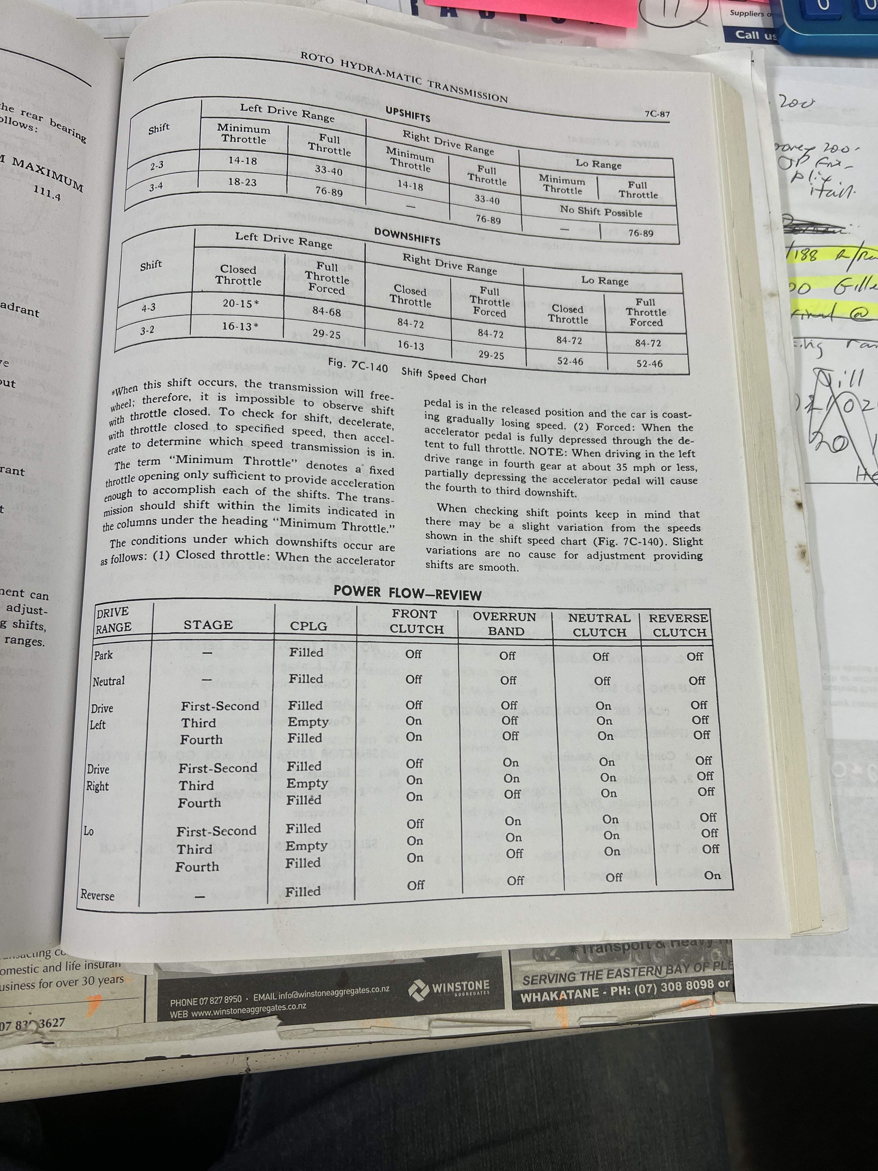

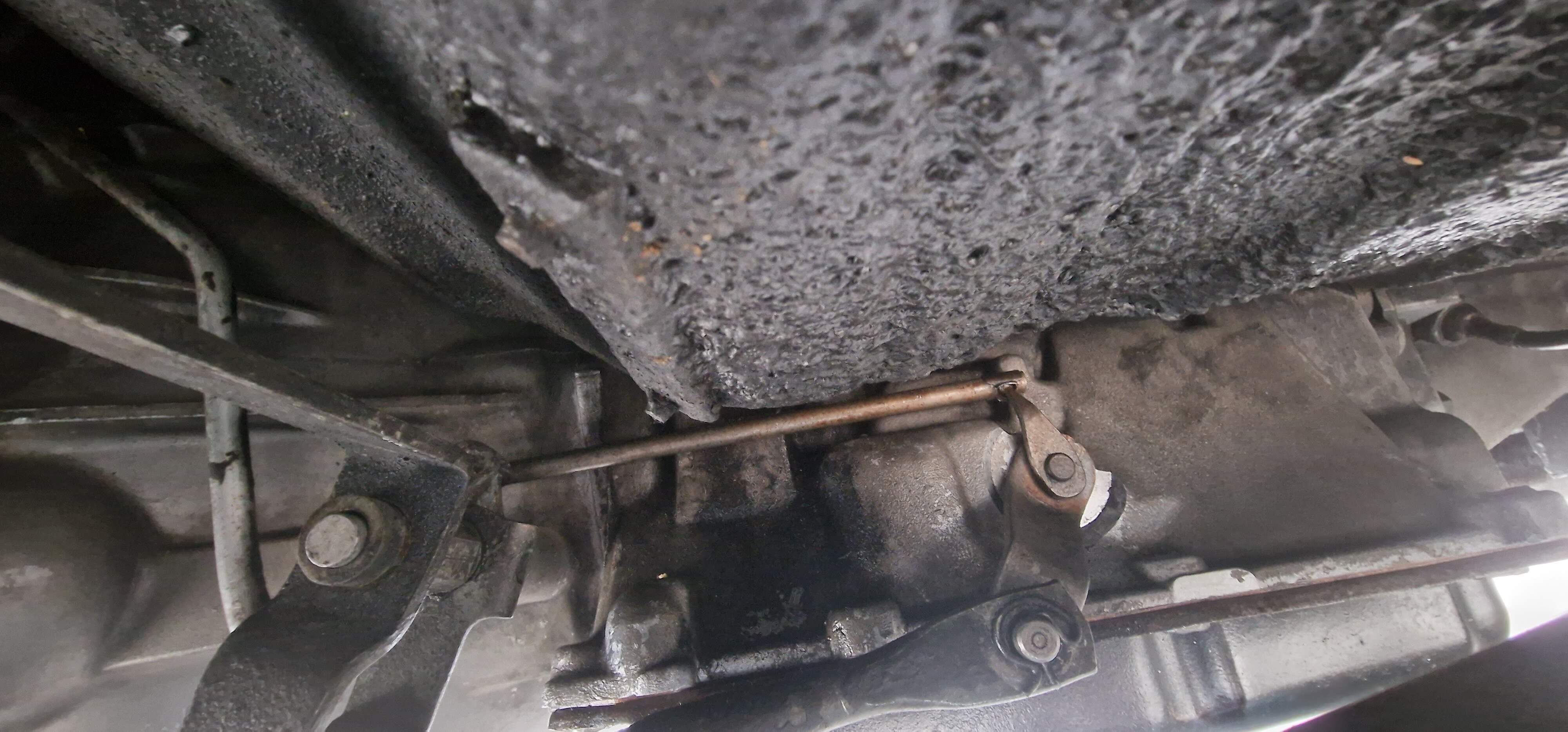

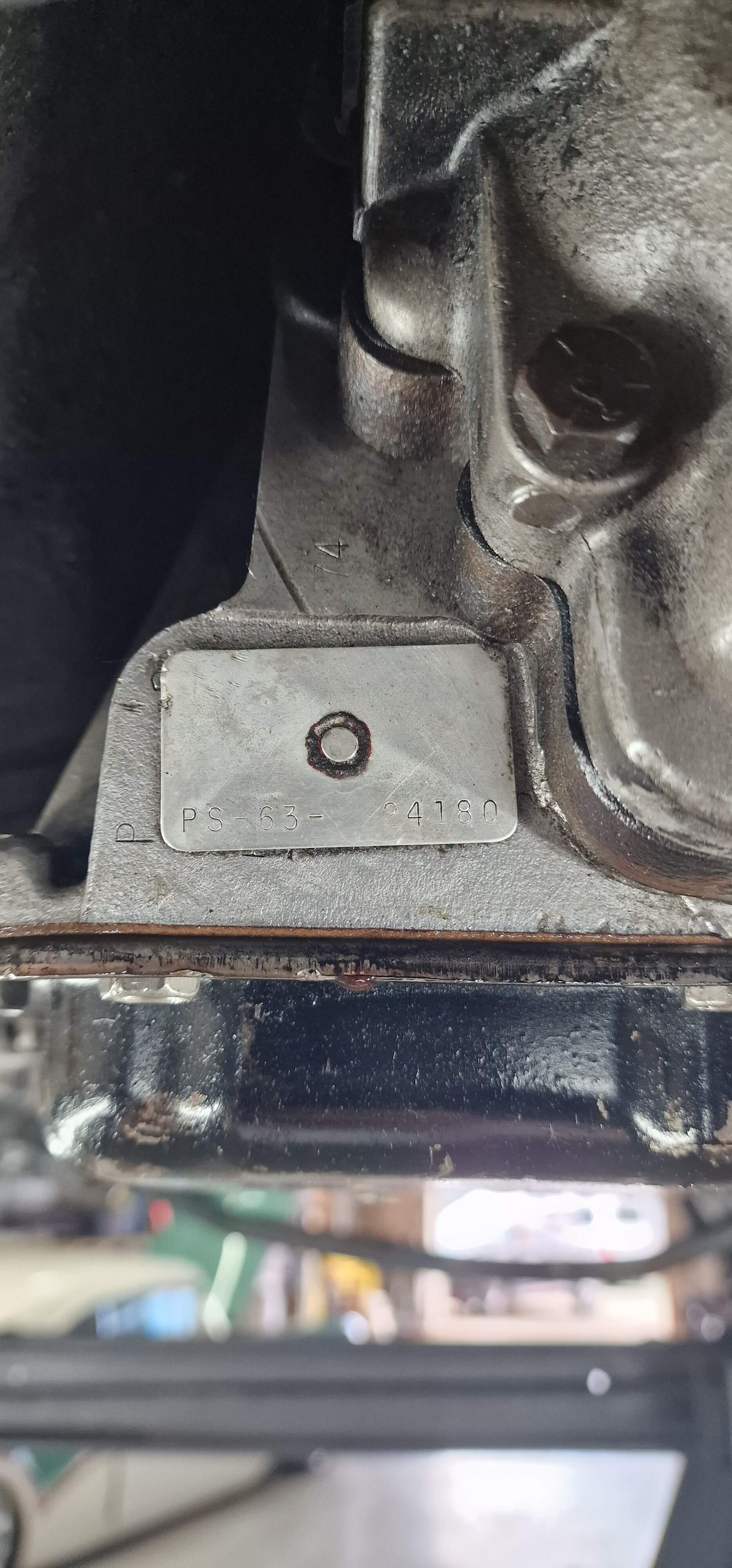

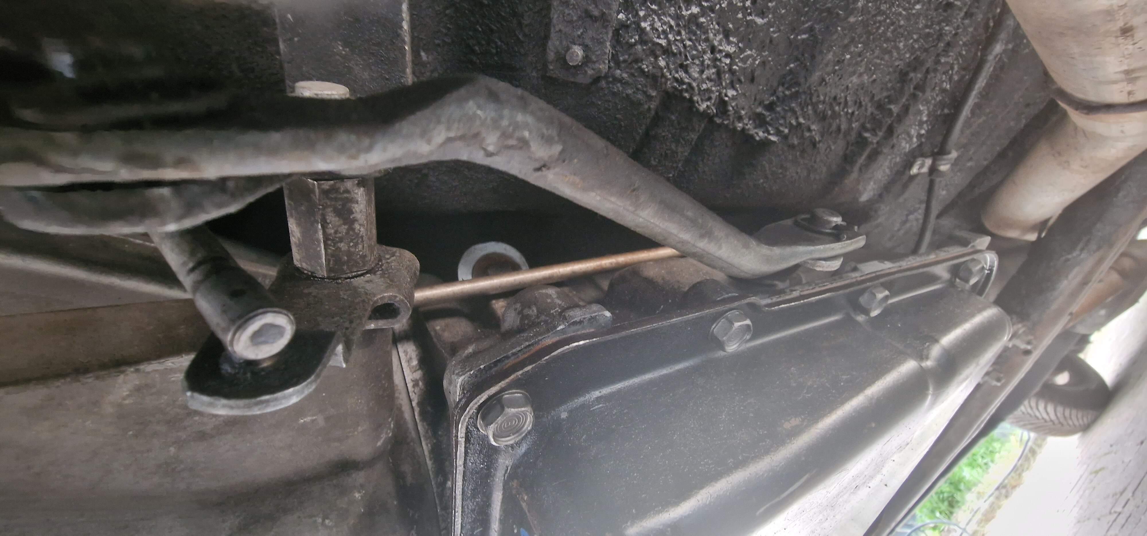

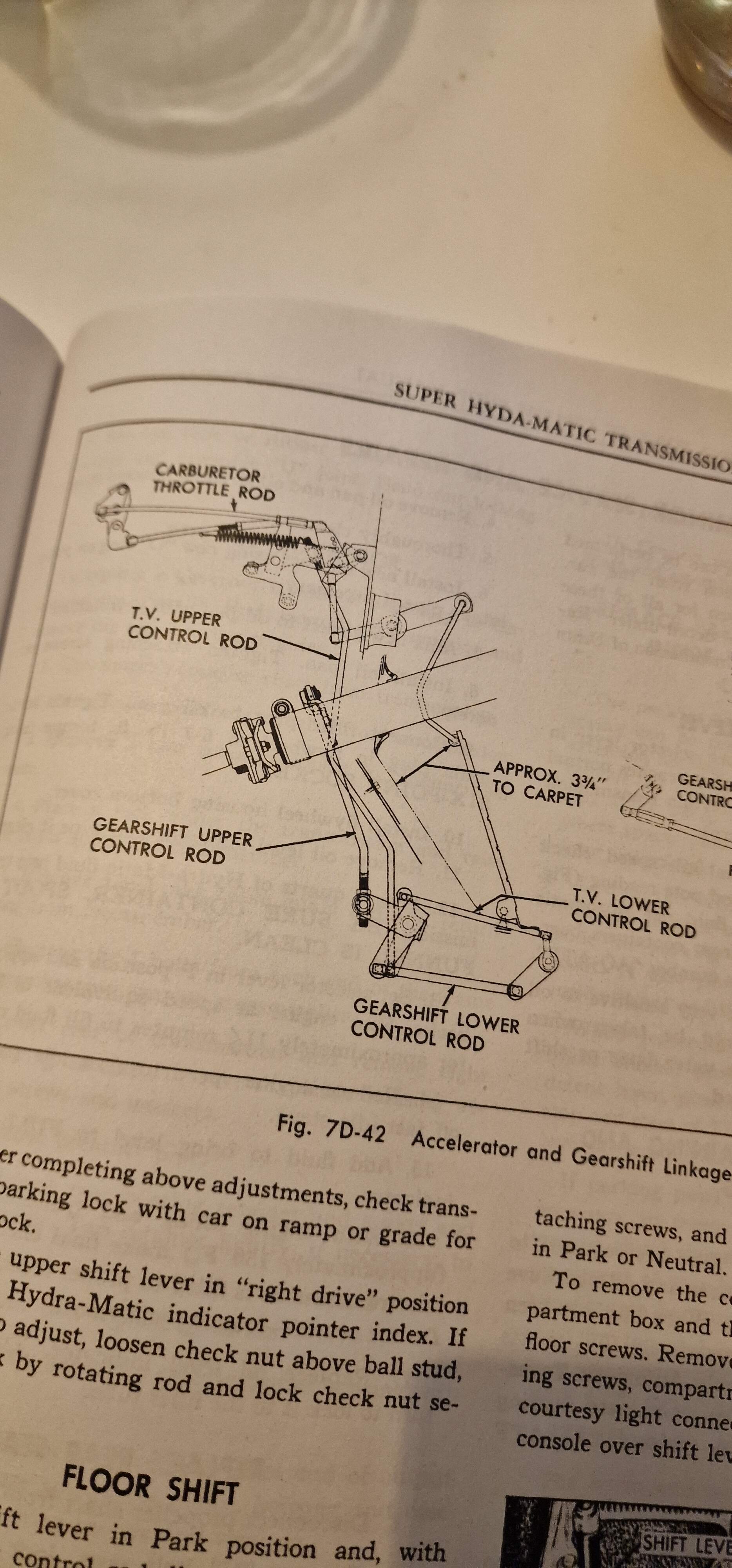

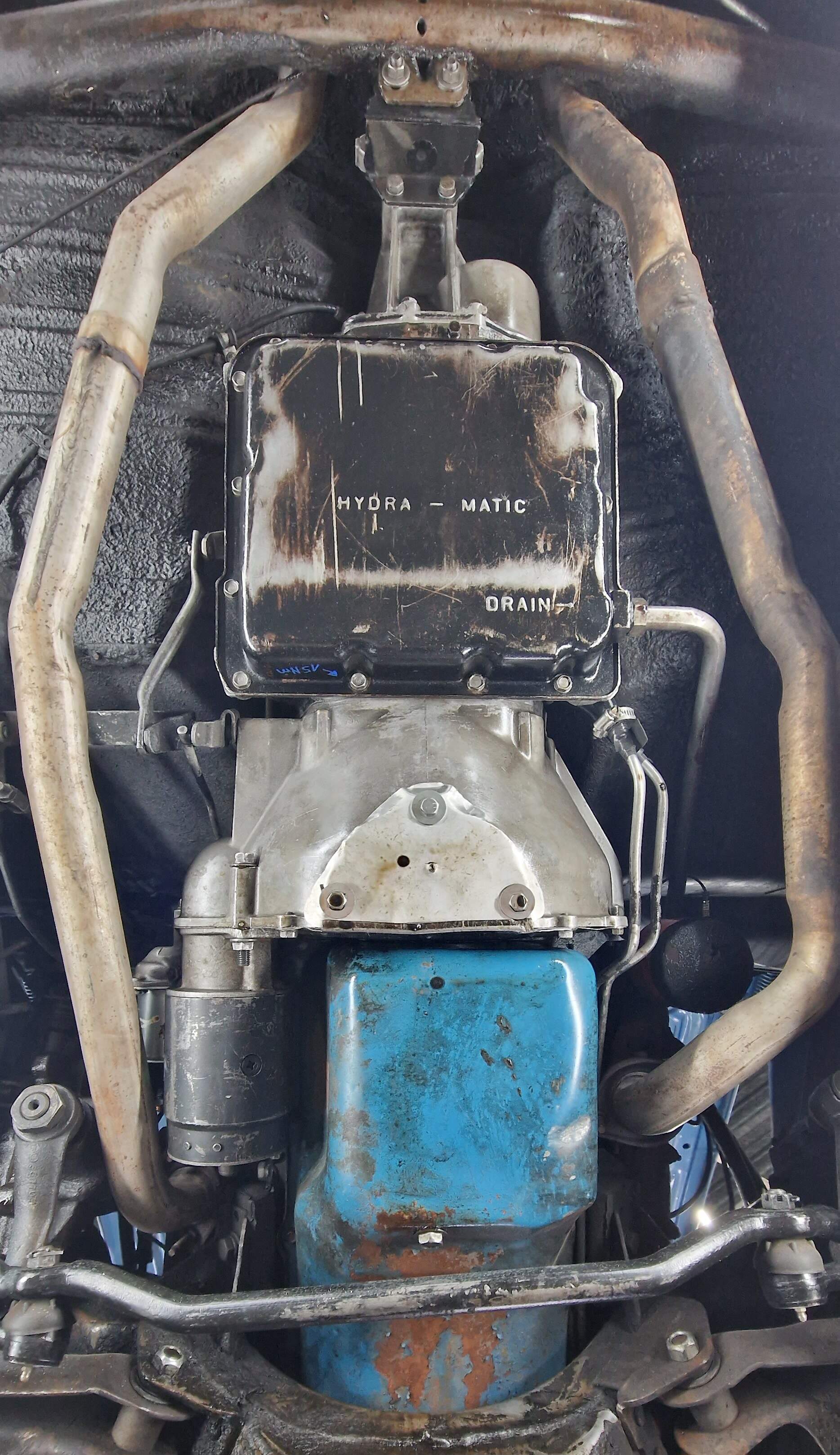

Hey again...everthing on the rods look firm and i changed nothing....my english is not the worst but when i read the Shop manual i feel like im in elementery...heheh....this is how everthing looks and i dont kniw really where to start....i will check and spenden some more time after my vacation...thanks for your help
