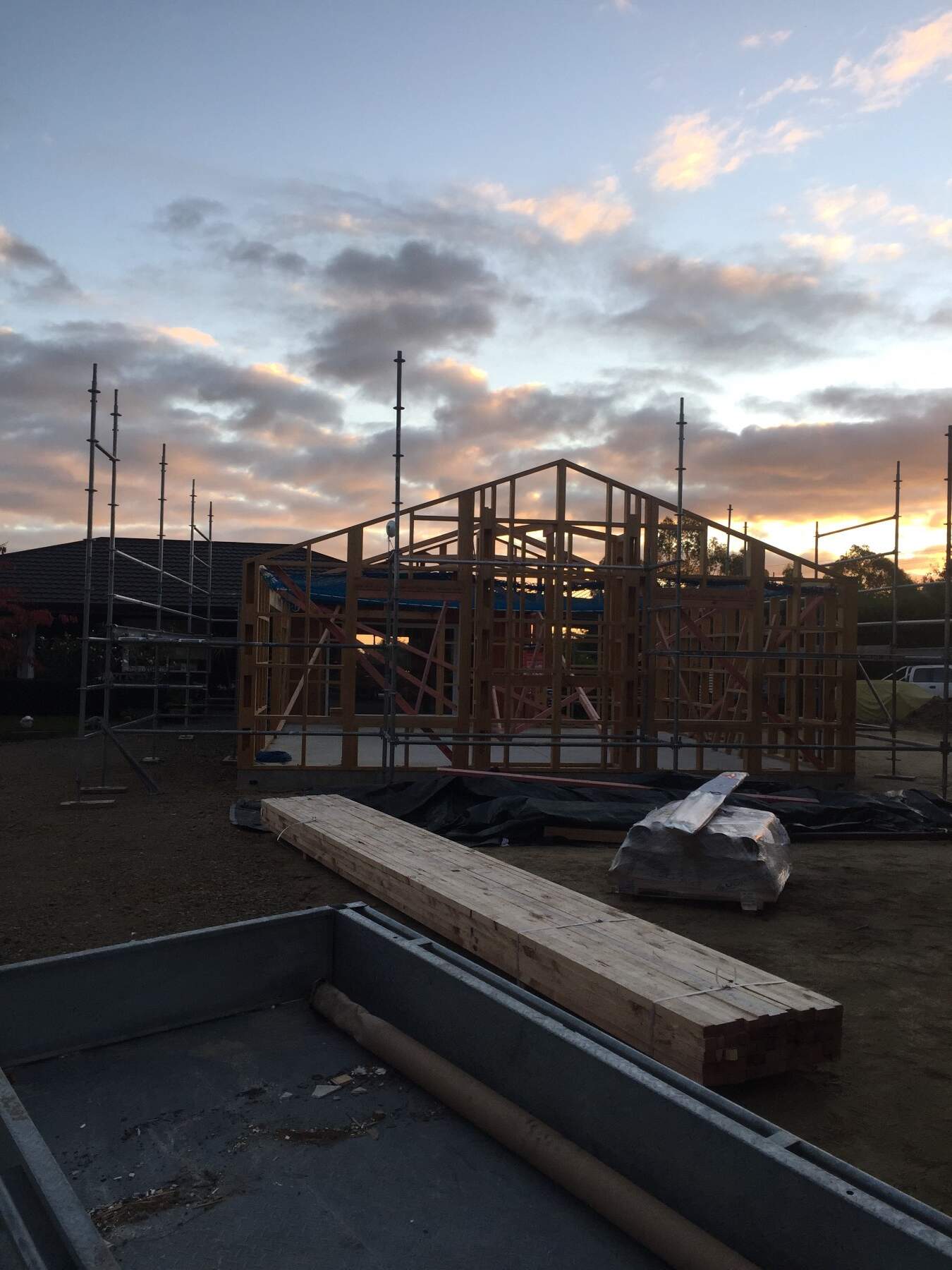

Progress on the additions !
frames up
and trusses are next
but waiting on scaffolding To go up first
I have a mate who I bought a trailer off to sit the spare 64 Pontiac body on and he is doing my scaffolding for a suitable beer price 🍻🍻🍻🍻

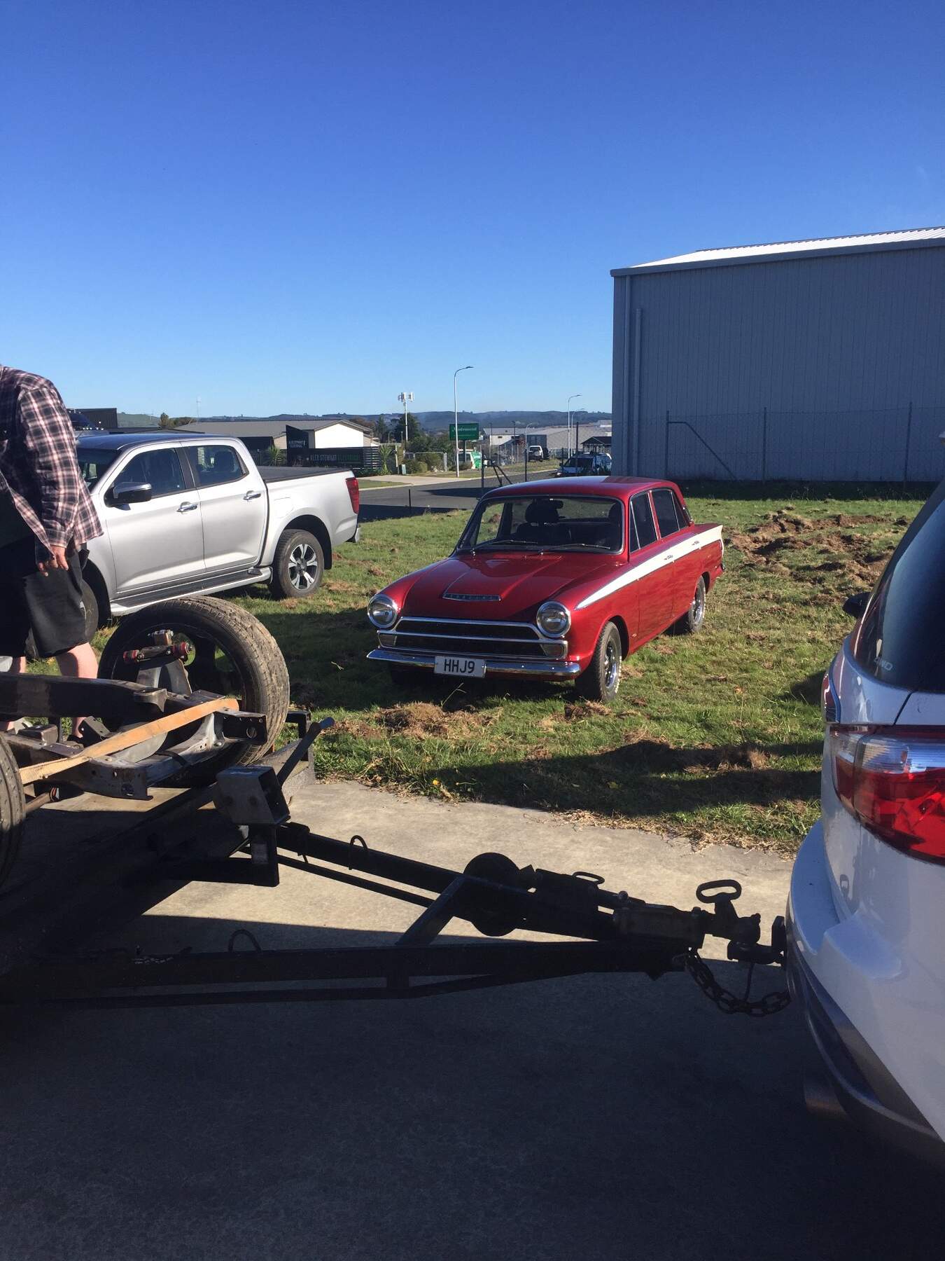

well today i spent from 8 am till 5 pm standing around waiting my turn to get the Cortina through its first lvvta inspection....
in this car it has a non stock engine and gear box, diffrent diff and a whole change for front suspension.
i came away with a list of 4 items to rectify , none of which where what i would consider major things to change, i had used a bolt instead of a pin for the brake pedal to push rod pivot, i had  washers spacing the wilwood front calipers and they want that to be a single bush.
they want a rear drive shaft loop to stop the drive shaft from cutting the flow and return fuel lines.... i had piped the line in the drive shaft tunnel and already have a front drive shaft loop.
and the guy did not except my aftermarket single circuit brake master cylinder,,,, if it was a factory Cortina one i could keep the single outlet system otherwise it has to be a dual circuit master cylinder.

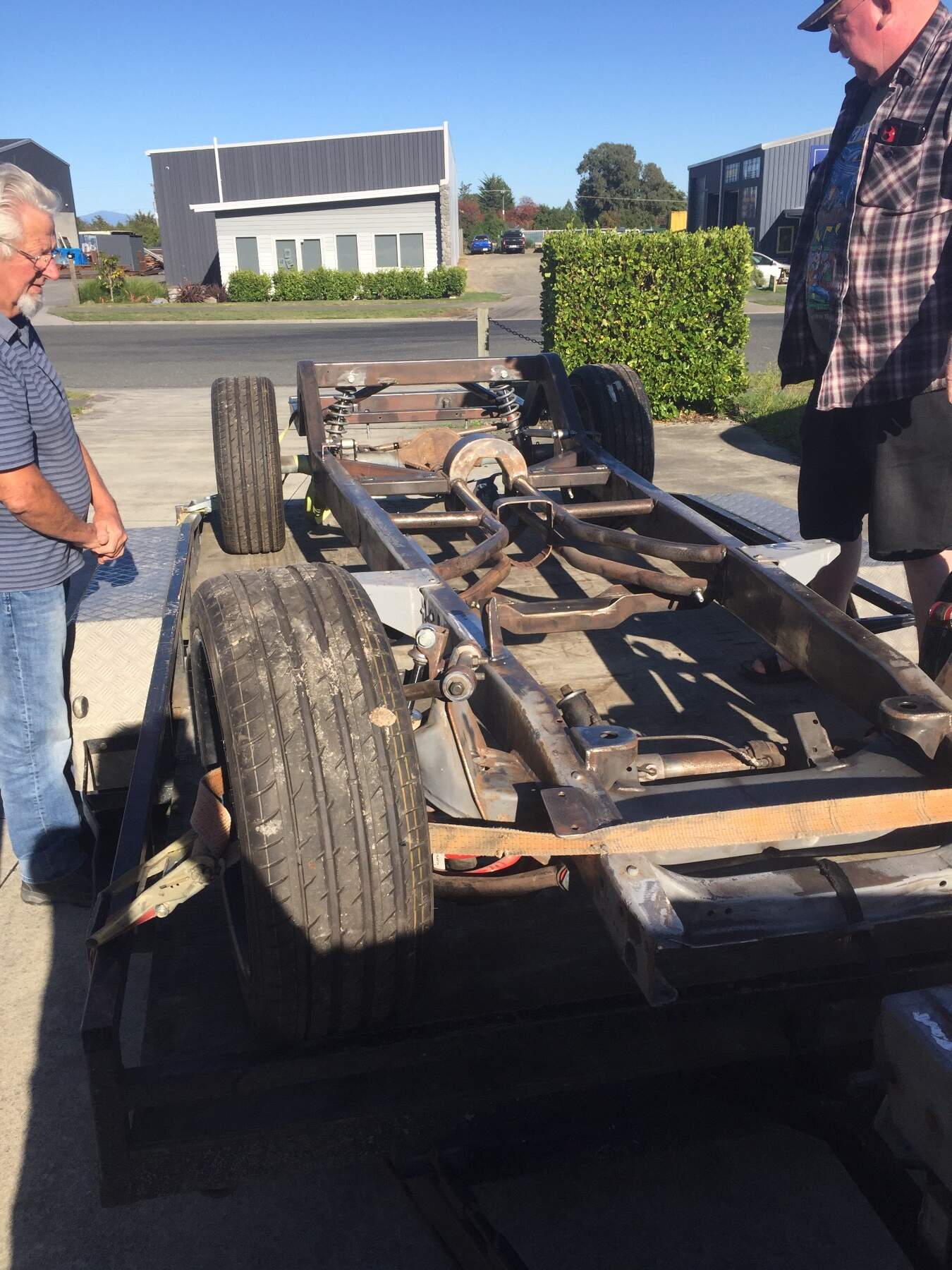

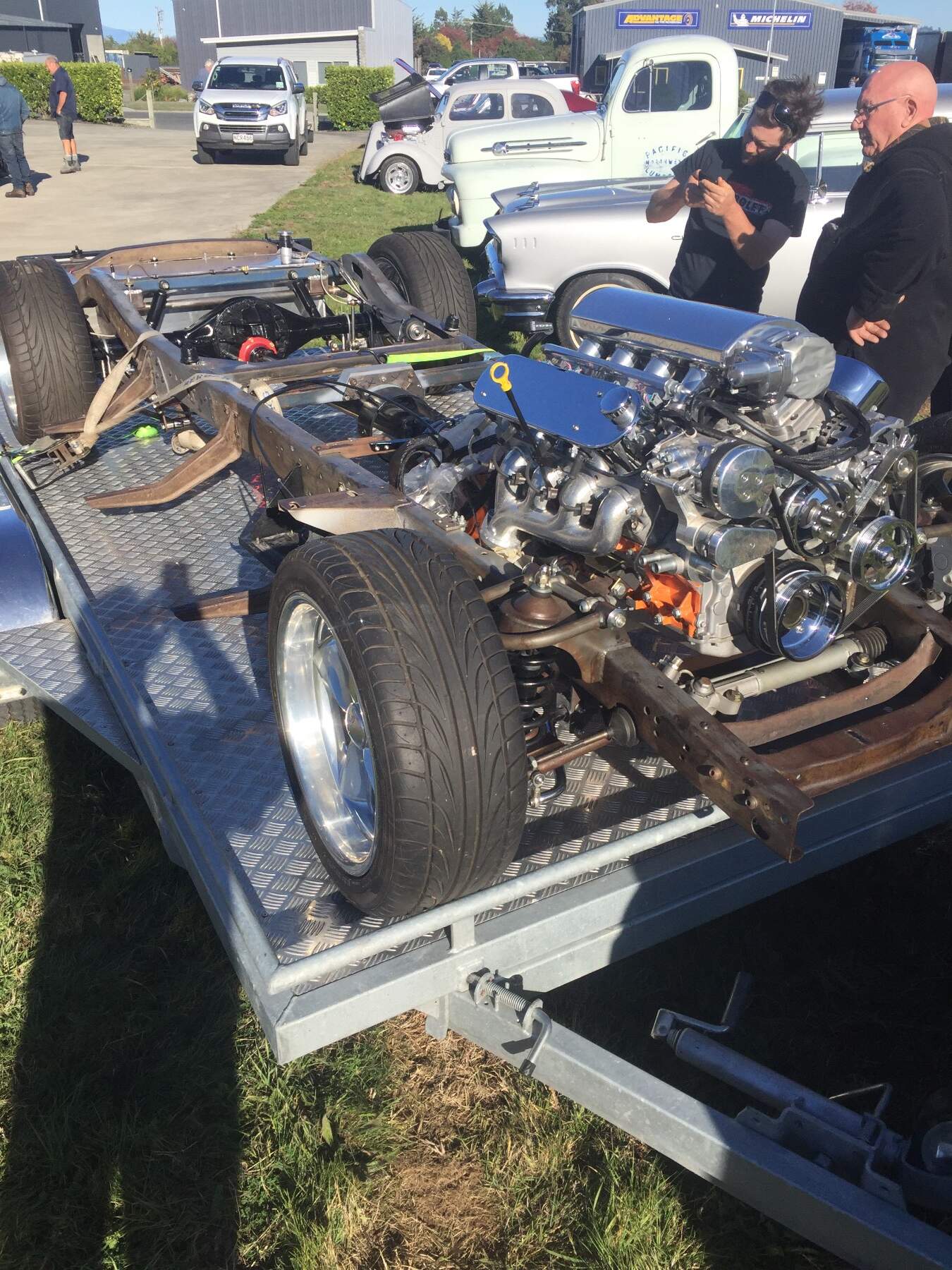

some of the projects where chassis inspections like my mate Johns 56 chev truck chassis,
some where there for seat belt mount certifcations

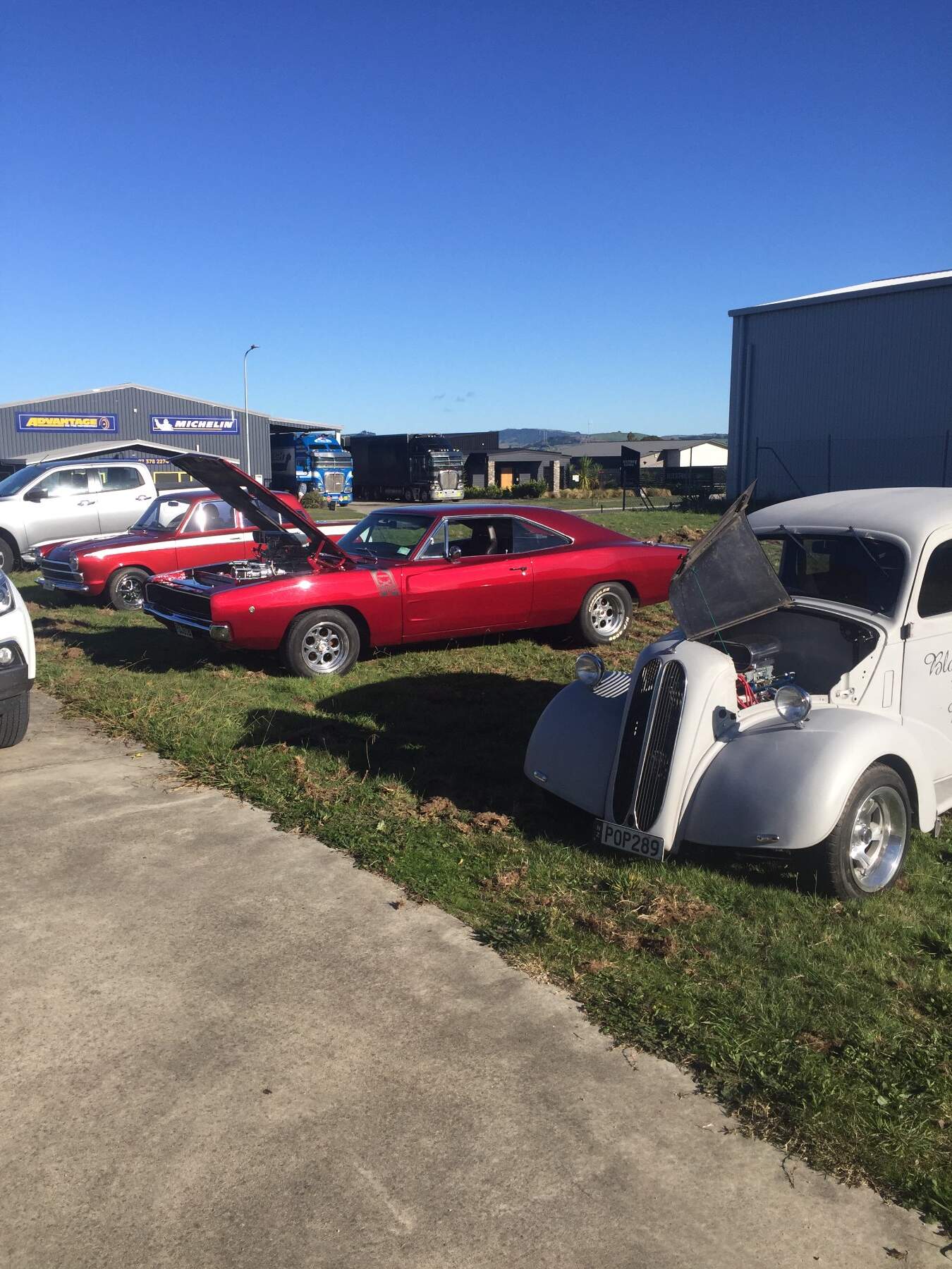

this guy with his brand new purchase had no idea that even though he paid big money for a dodge charger it was a real mess under side and the list of things that need doing is LONG ,, i will not elaborate.

Kiwi - because my car is essentially stock I got out of it lightly. It turns out the reason why they wouldn't register my car the first time around is that the old style chassis number needed to be manually inputted into the system and that was it! Modern VINs are 17 digits but not the old 1965 Pontiac one. So: no inspection (apart from Safety Certificate) no engineer, no mod plate. They have a new rule now where the Qld Transport staff are not allowed to go outside and physically check the car for details like chassis number & engine number because they might get skin cancer. This is true!
Anyway, they sound like minor mods except for the master cylinder which is a good one to do, anyway. I should have done that as a priority when I first started doing my car.

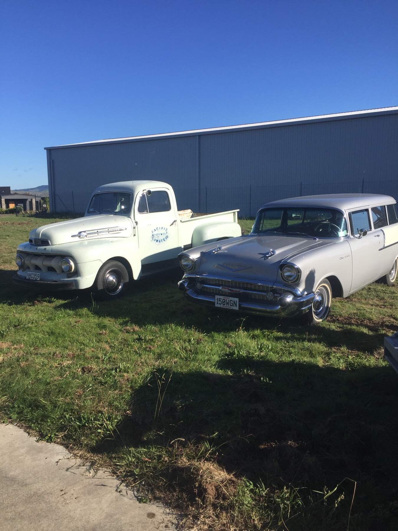

Lots of old cars in those pics - that damn place must be chockablock with old cars! I'm forever astounded as to how strong the old car scene is there.
yeah mate, kiwis are truly petroheads !! Taupo is just a little place and yet we have dozens of cool old cars here!
