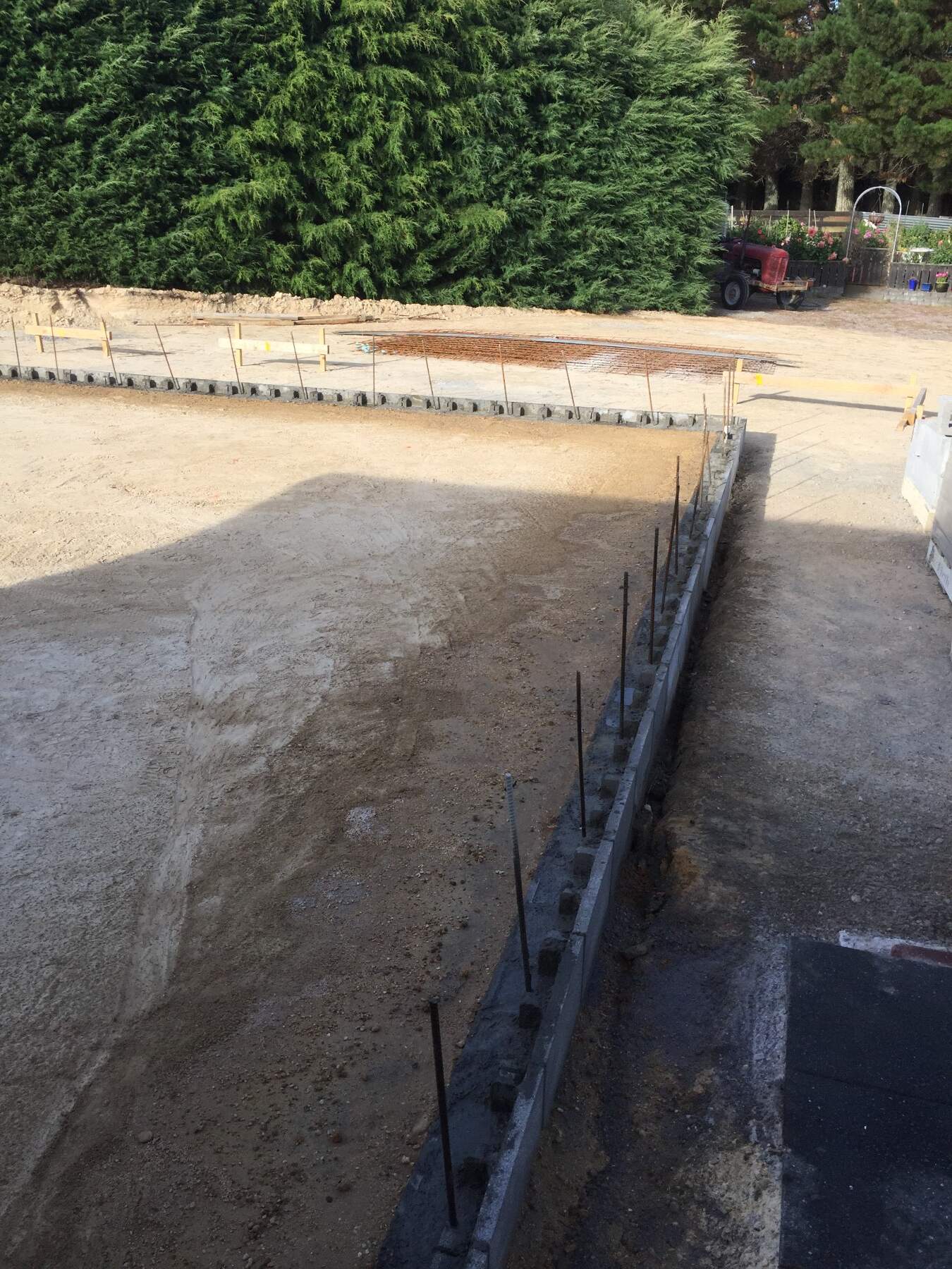

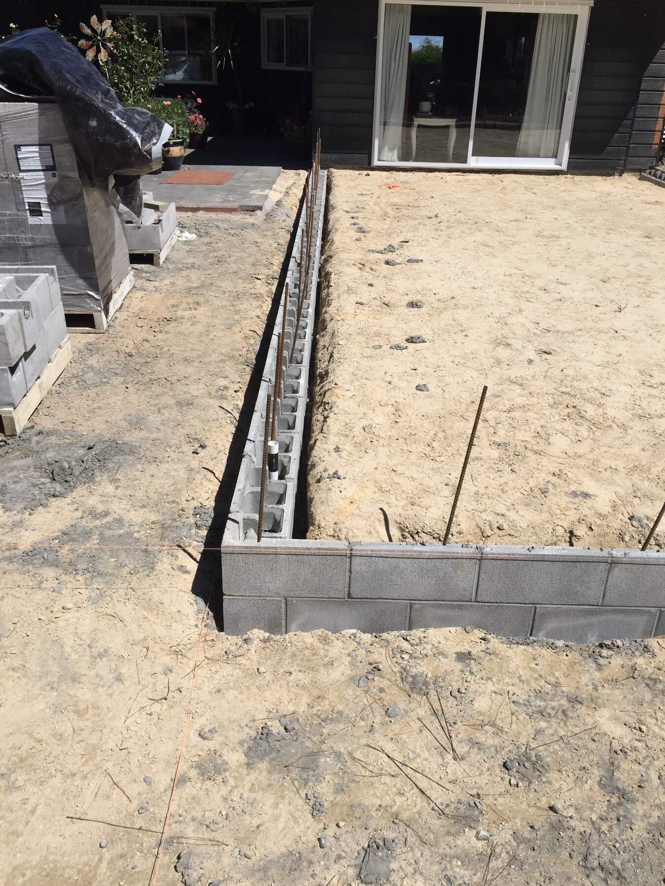

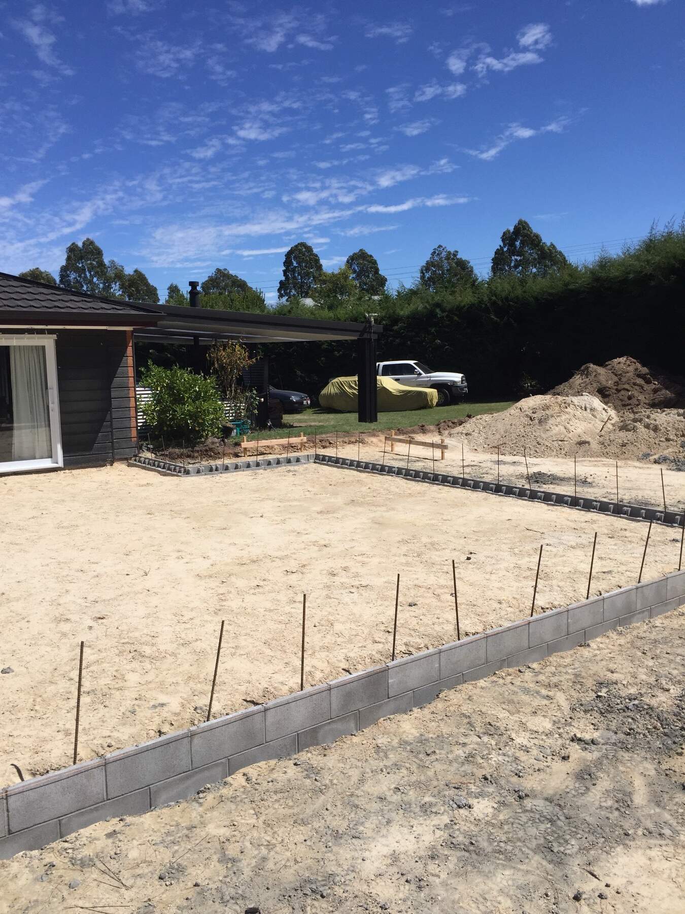

Footing poured and block layer turned up on Saturday morning
we went to a 1 st birthday party for a family member 2 hours drive away and when I got home they where done
So Sunday I fill the blocks with concrete
was a easy job as it was only a 1 m3 of builders mix and 6 bags of cement
Today
after work I have back filled and compacted behind the blocks
and tomorrow is polythene and mesh down
I have a concrete placer doing the floor pour on Thursday
Nice progress. Footings & foundation work is where all the hard yards are done and little to show for it, BUT you gotta get that bit right. I've done my share of renovations & repairs and am well & truly over it. I wish you well. In fact, I'll come and inspect it in person once God Himself declares that we can come over there unhindered.
Yes mate by the time you get to visit I should be done !!! 🍻🍻🍻

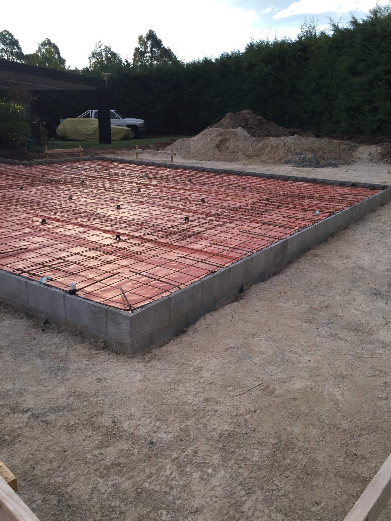

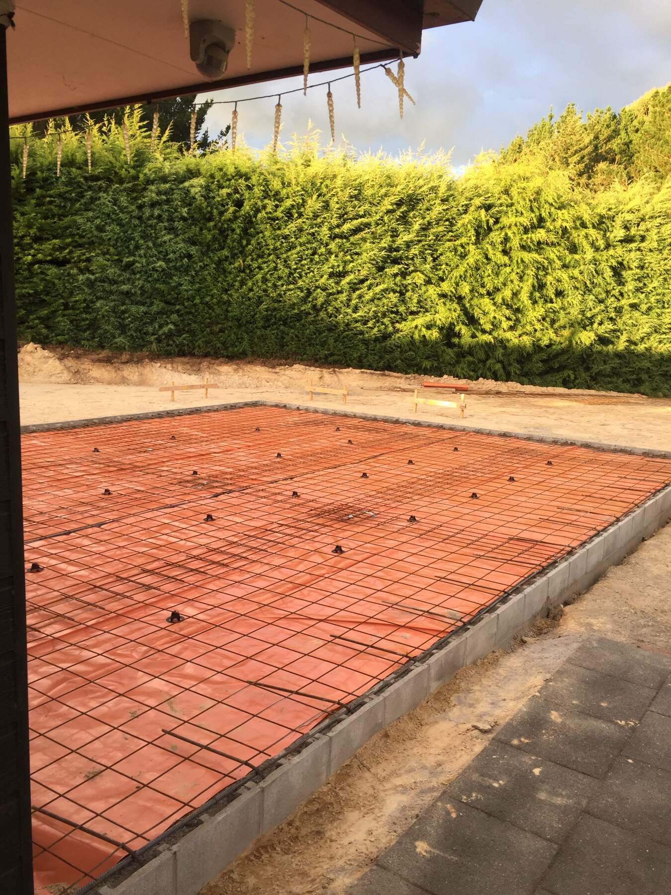

Today got the steel mesh and vapour barrier down
ready for council inspection tomorrow
and concrete placer is locked  in for Thursday
1
2
3

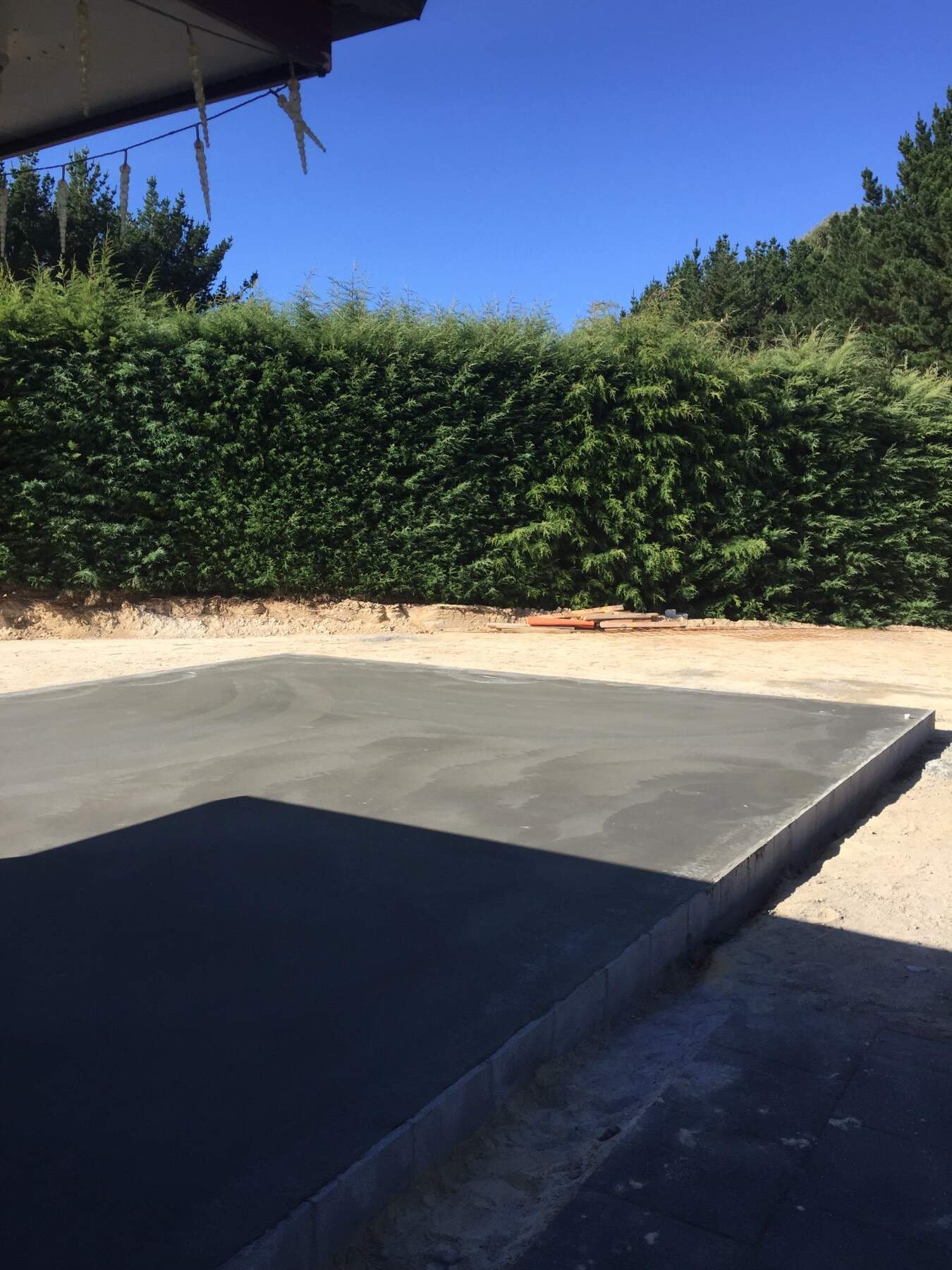

FLOOR !!!

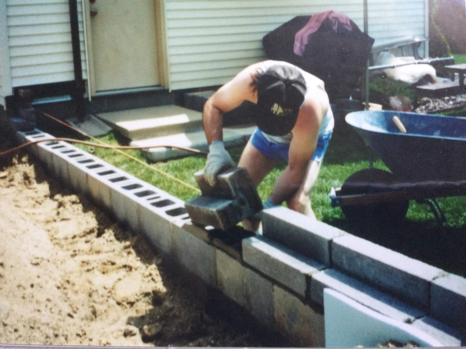

Hey! Wait a minute! That’s bloody cheating! When I put mine up in “96” I did everything all by my lonesome. Workin 10 & 12 hour days, 6 days a week at LZ flying around the country, Little Rock, Omaha, Wyoming, Chicago. No damn birthday party! I’m jealous.

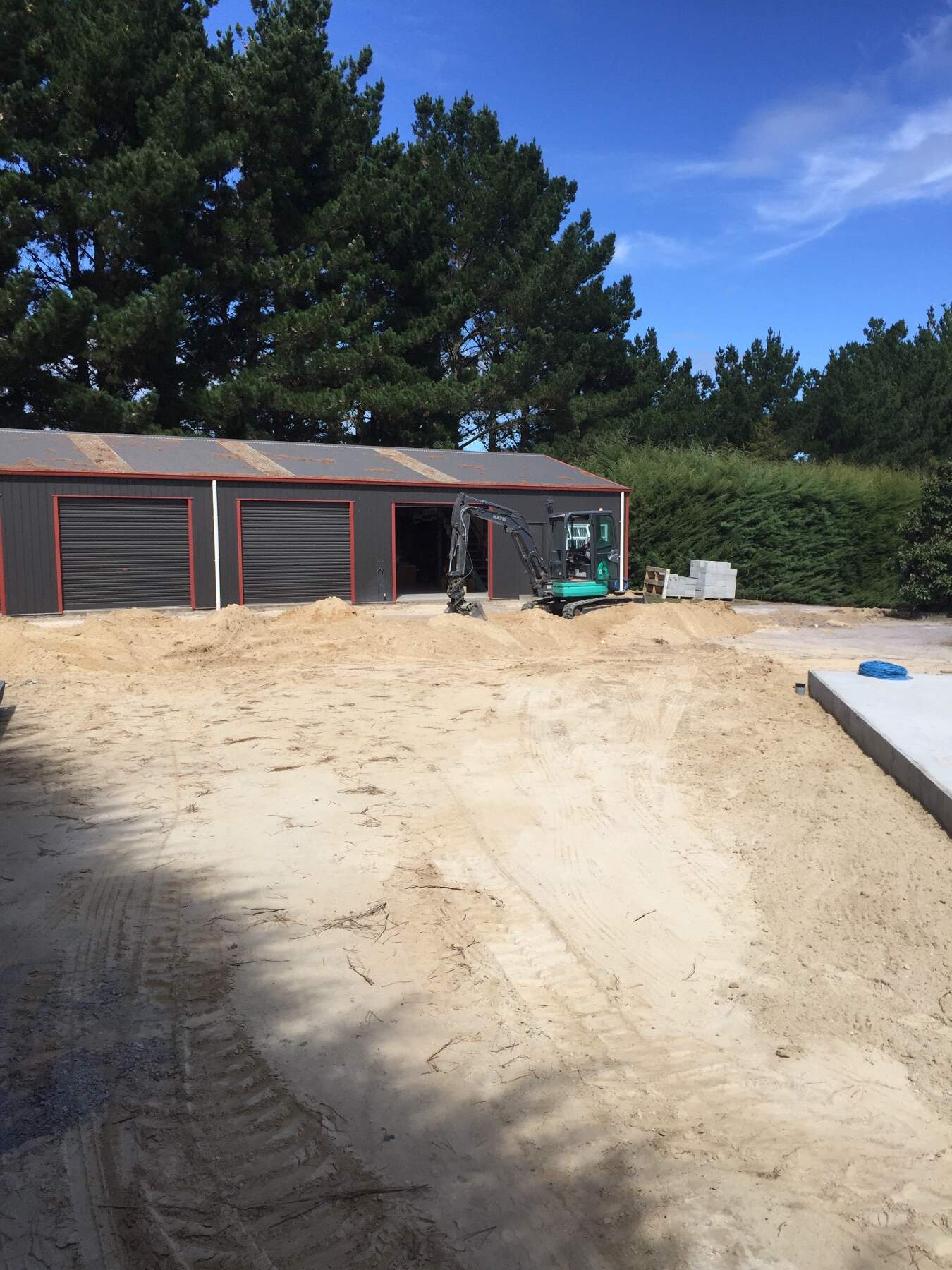

So I have locked in my digger mate for next week and I will lay stormwater drains back to the rain water tanks
and while I am doing that I am going to get 4 x cad 6 data cables in the trench from the additions over to my garage to future proof for things like cameras etc back to my modem in the house

Stormwater system dug and covered including a duct with 4 cad6 data cables  for future
then a whole lot of pumice moves around to form the new driveway and car park
