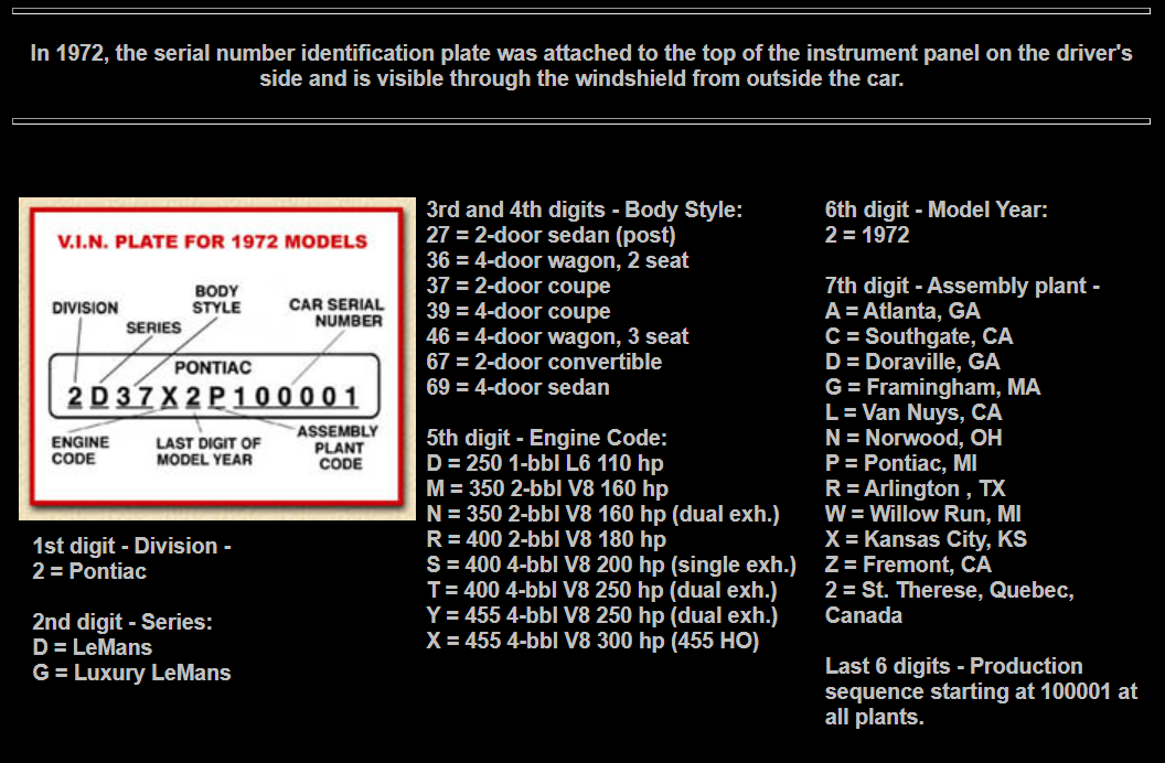

Thanks, it is a 1972 not a 1971.
Okay that changes thing a little bit. Starting with the1972 model year, the VIN included the original engine code. So the 5th position will tell you what the car originally came with.
Again to validate that you still have the original engine in the car, look for the machine pad on the passenger side of the front of the motor near the water pump. The sequence number or serial number stamped on the engine should match the sequence or serial number portion of the VIN. If not, the engine has been replaced with something else.
