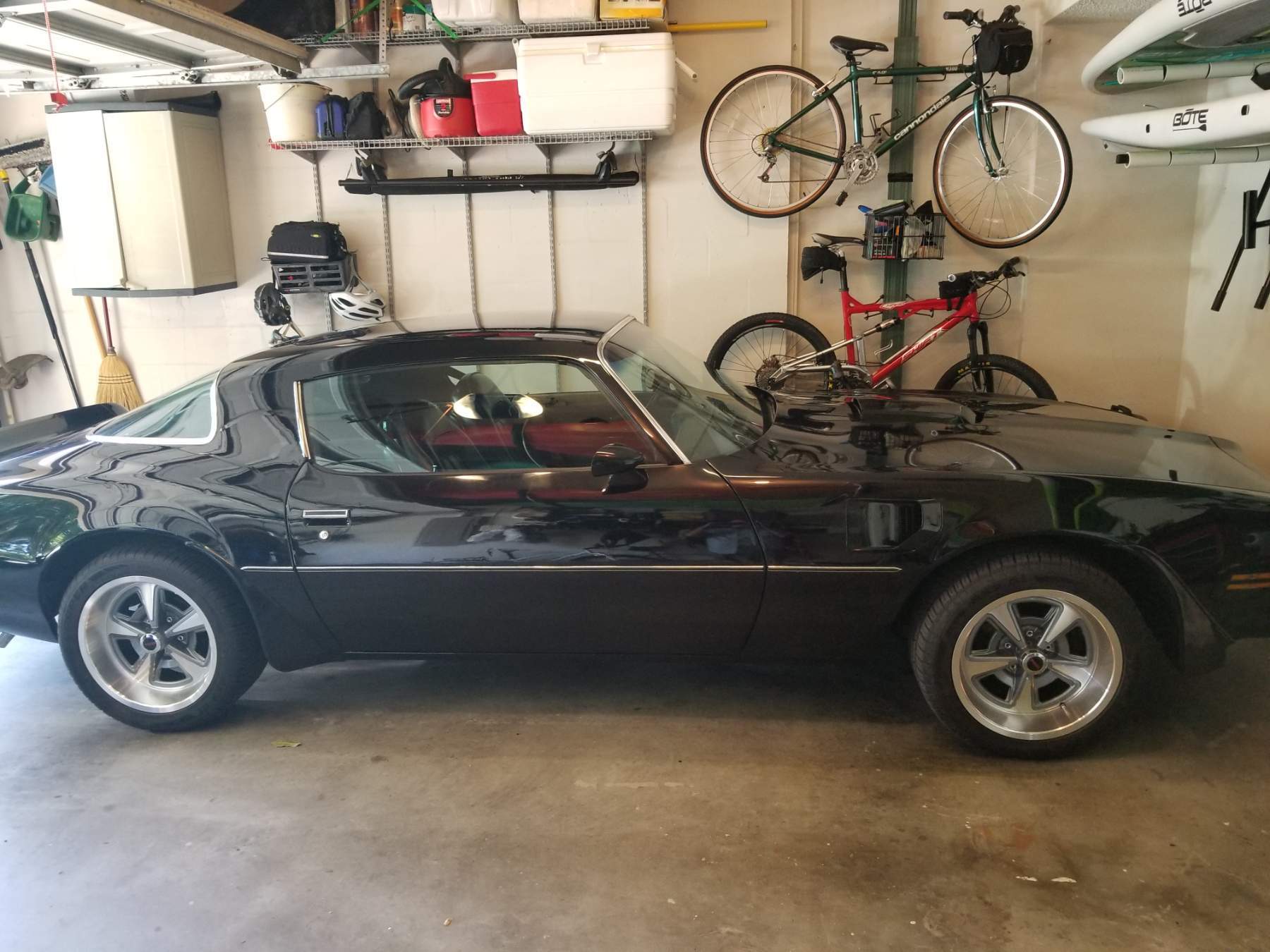

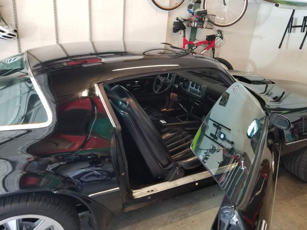

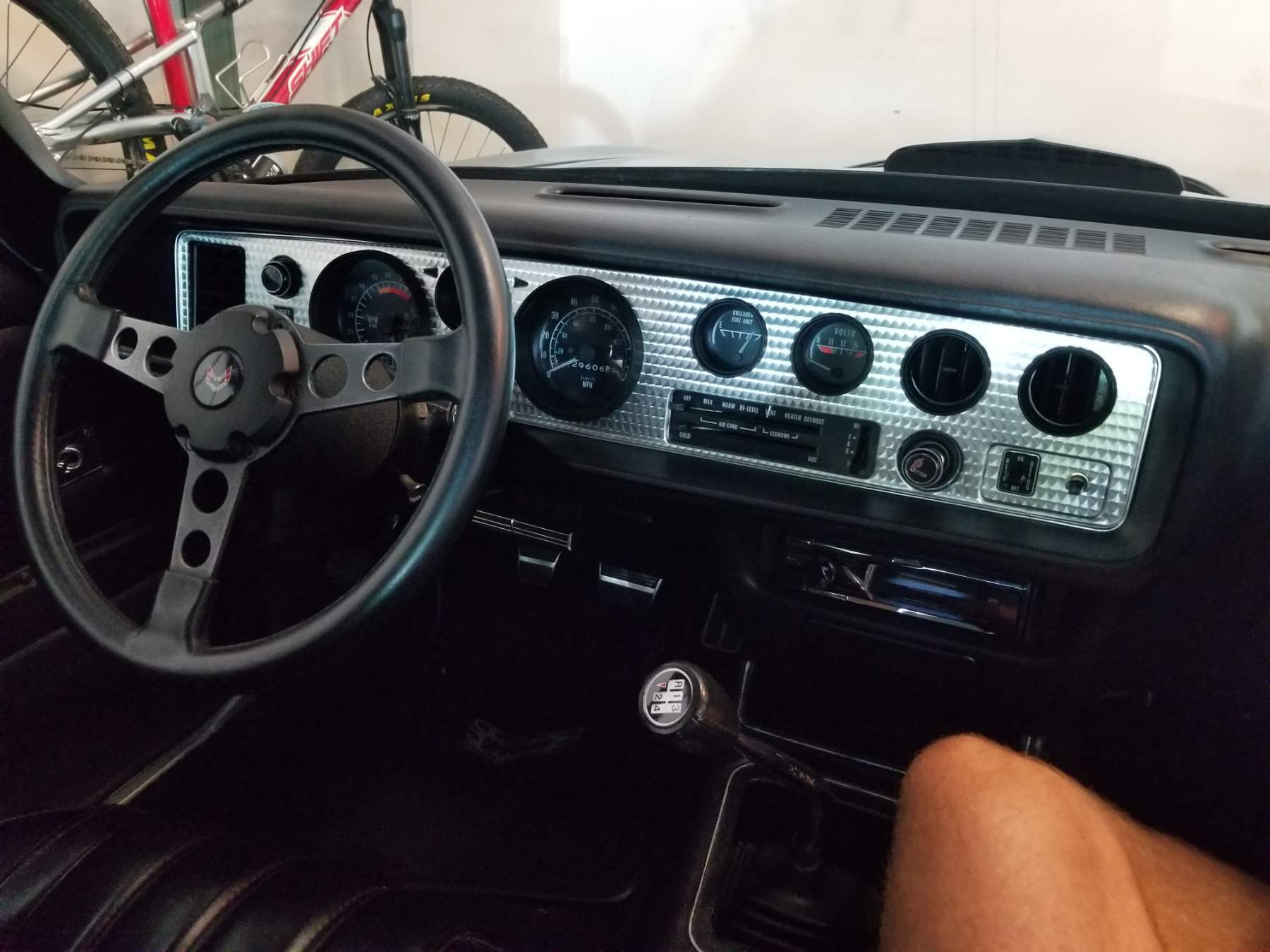

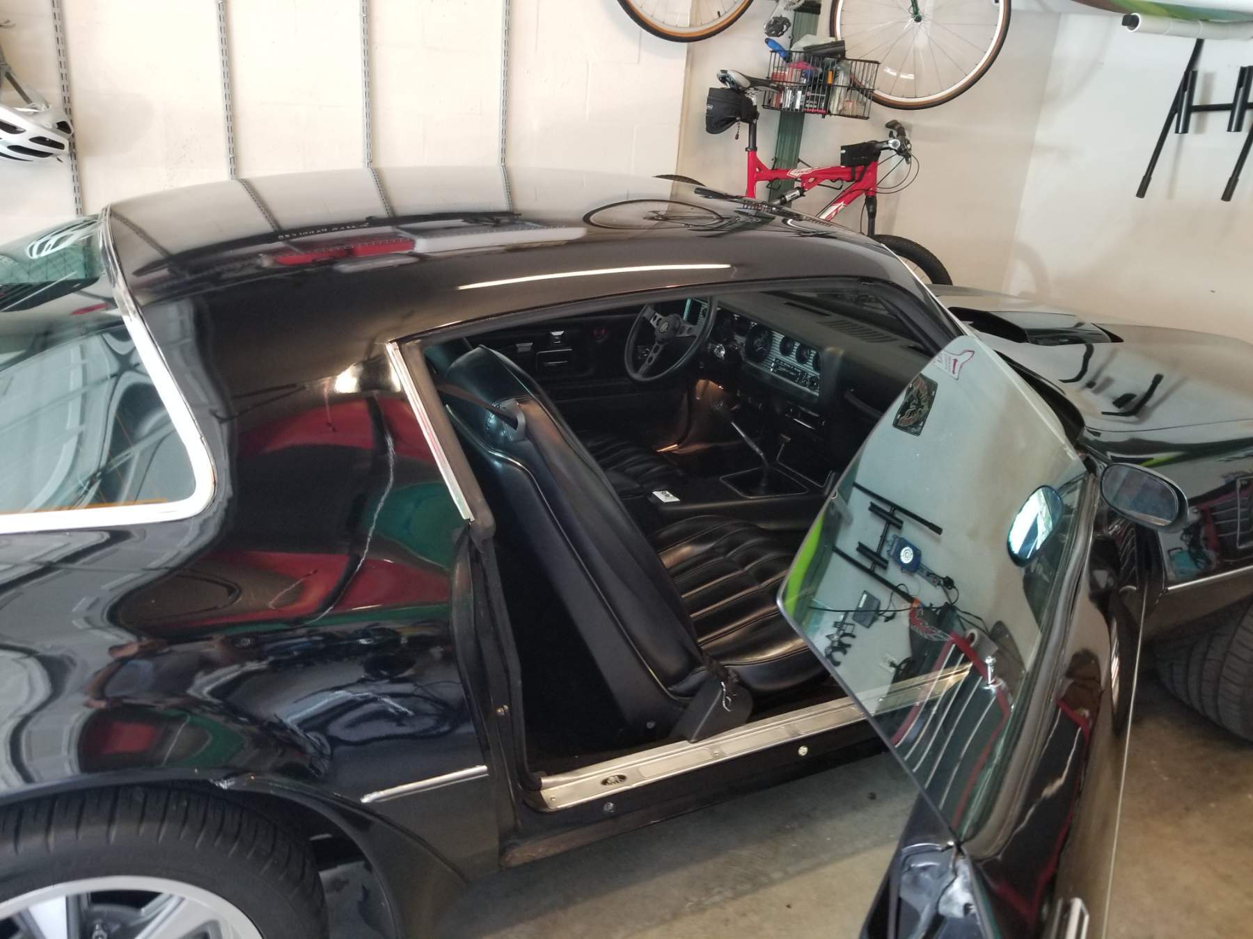

Thanks again. I've attached some resent pics.
Sweet looking ride. I hope you drive it look you stole it from time to time!
