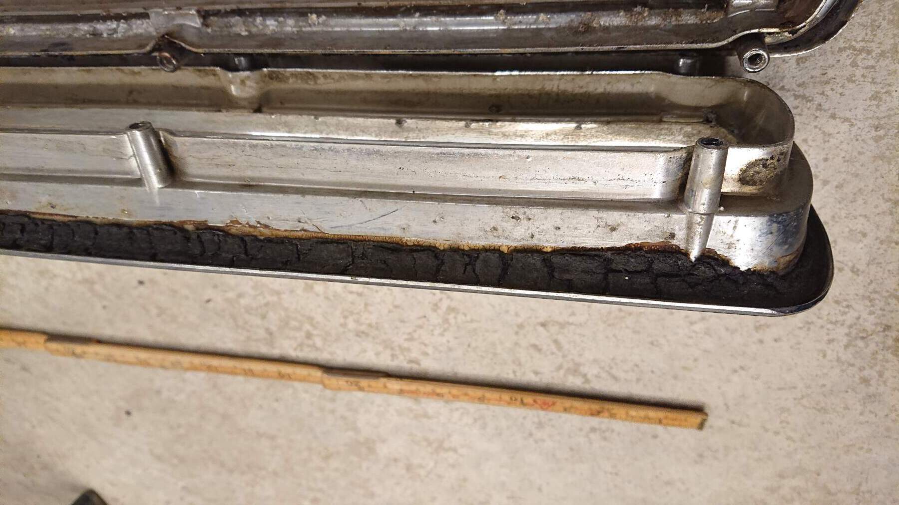

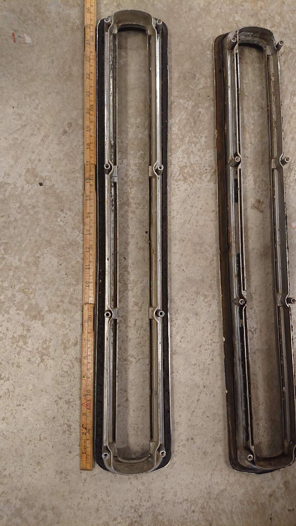

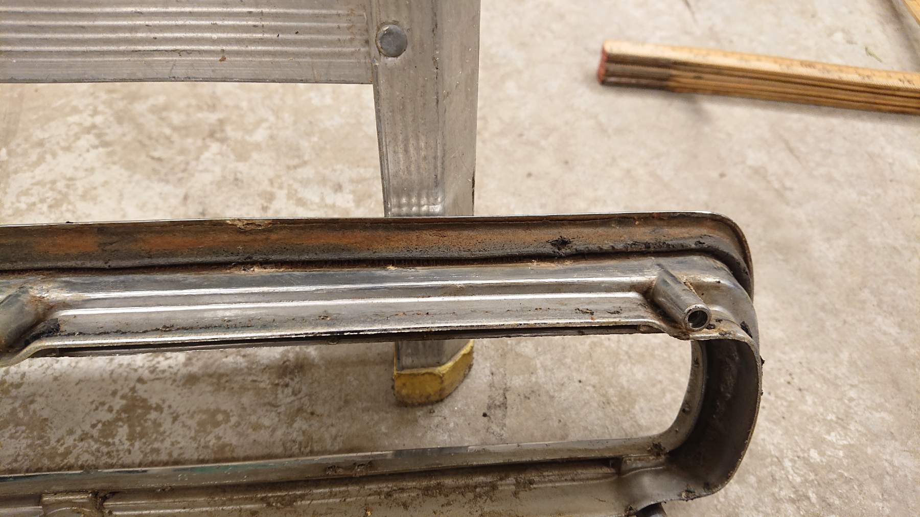

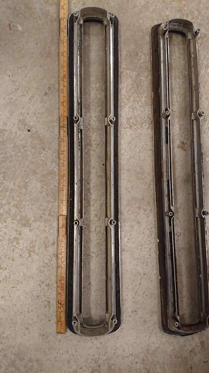

The ones I'm looking for sit between the taillight and the body
Goes around the taillight housing , like butyl rubber
Do you have a picture of your old ones Gurra ?
This is how the backside looks like, on the taillight frame
I've checked OPGI, Ames Performance, no look so far.

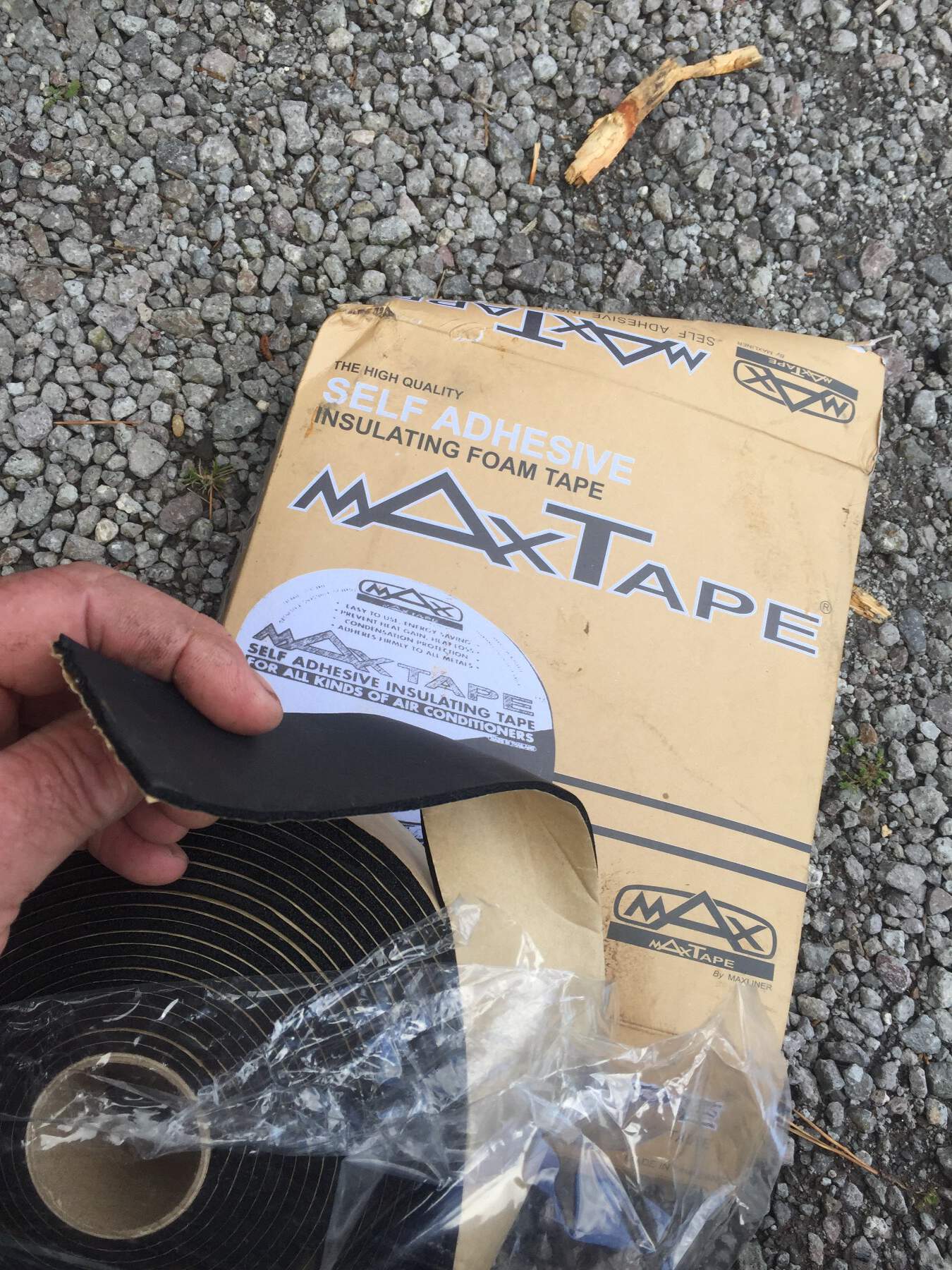

You might be better off buying a roll of butyl rubber from the likes of Amazon. Just be sure to a small strip around all the mounting/alignment pins to complete encircle the pin so water cannot leak in.
Thanks for your help Frosty 😃 👍
Frosty is bang on, just make your own seals. :cheers:
Here is what I would use, just cut too the width you need and stick it on, this stuff is what we use to insulate pipework, and its super sticky backing so it wont come off in a hurry
