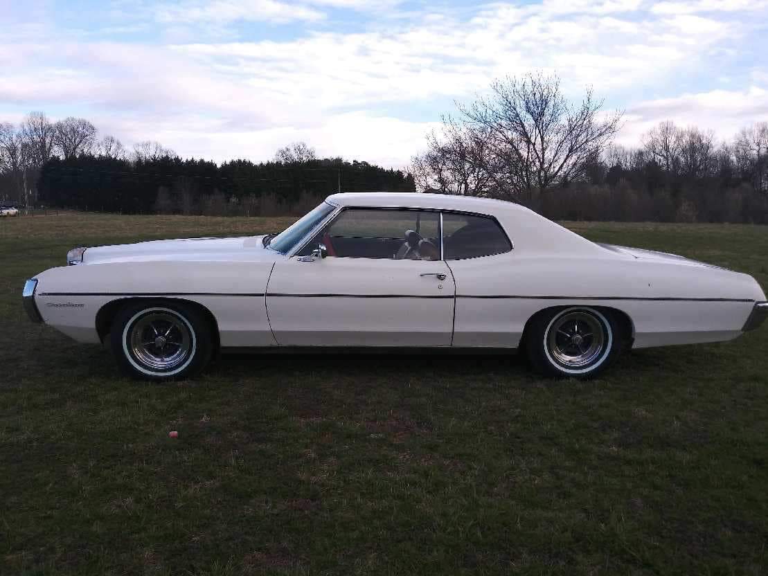

Pontiac 400 Header for a 1969 Catalina
Hey there!
I am in search of some headers for a 400 Small Block Pontiac engine for a 1969 Catalina. I'm really interested in finding long tube headers to help not have much restriction for more HP. Feels like an impossible tasks in finding the right headers and getting them to fit. Been searching for quite a few days, maybe a week and haven't had much luck. I know the space is very tight to fit a header between the frame and head. Can anyone help me with their experience and/or suggestions? I don't know if I have to get some custom fitted, which is highly possible. Any help would be greatly appreciated!
Thanks,
Nick.
Also need to note it is a column shift. May need to convert to a floor shifter to find any headers that would fit
