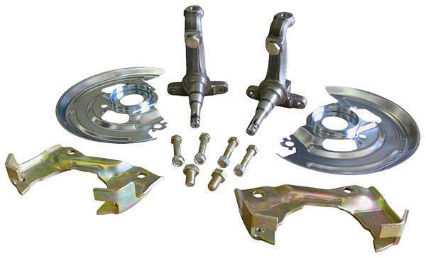

Now disc brakes! Depending on what you want and how much effort you want to put in, you can do basic and easy OEM style front disc with drums out back and run standard 15” wheel maybe 14”, depending on the rim. I’ll cover the OEM avenue! GM, better than any other manufacturer, built interchangeable components that spanned car models, divisions and years. Even when they were not intended for a particular model, often with minor modifications you could and still can get what you want. The attached photo shows a OEM front disc setup of parts. This setup bolts on/replaces a drum brake front end setup. You may need to add a spacer to one of the attaching bolt areas or machine down a boss to square the bracket. You might even have to take the brackets and modify them while maintaining the integrity of the area were the caliper goes, but in the end this setup takes one of the most reliable disc brake caliper ever used. It has a massive 2 15/16” piston, more than enough to stop any boat! You will need to change the master cylinder and if you add a power booster to the master cylinder, you will have a great braking system. If you have additional questions just ask there are a lot of competent folks here, like Frosty, JustA6 and Indymanjoe to name a few, who are always ready to help!

I like Last Indian's viewpoint on the disc brakes. When I actually did this for a living 25 years ago I had the luxury of seeing most of the cars that were on the road and being able to take dimensions and make notes that I could use to mix and match parts successfully. Things like OK this rotor has the correct bolt circle and setback but do the bearings fit my spindle. I always found a lot of satisfaction in taking a pile of scrap metal and turning it into something useful. Sitting here thinking, maybe I just need to take detailed measurements off of the Catalina and plan to spend a day at the local pick a part. whadoyathink?

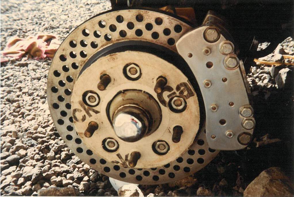

That said, I don’t have all the specs, but with respect to the brakes, I think the front spindles of the Catalina are pretty darn close to my Zs spindle configurations. If you could get a hold of a spindle for the first Gen F body you could compare. They used that spindle on 67-69 Camaro’s and 68-79 Nova, Omega, Phoenix, Apollo, Venture. So honestly I think the setup I spoke of just might work for you. Likewise the air shocks from the back of the Z just might work on the front of the Catalina as well! I think they will fit inside the spring I.D. and they would have the threaded stud setup at the top to attach at the frame bracket. If that were to prove out, you would just have to make the dog bone to go through the lower eyelet for attachment at the Aarm. You would also have to install the shock at the same time as the spring due to the air shocks size.
I didn’t take a lot of pictures in those days, but this is one taken of the front brake setup I designed and built for the Z. The back was very similar just thinner rotors. If you look close you’ll see that they were a three piece rotor, sorry I mean caliper. They were full floating with the actuating bolts set in double shear. The are also an all aluminum caliper.
