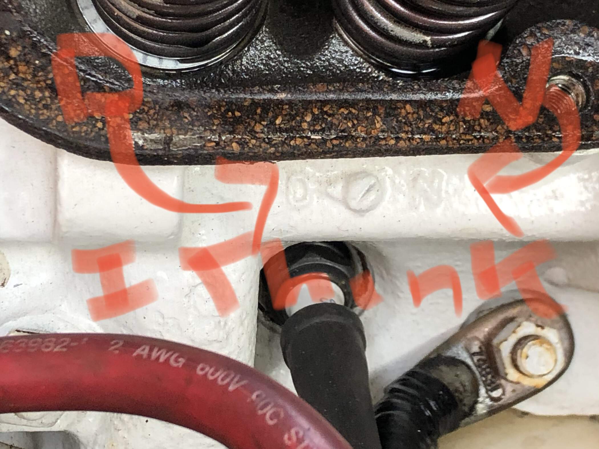

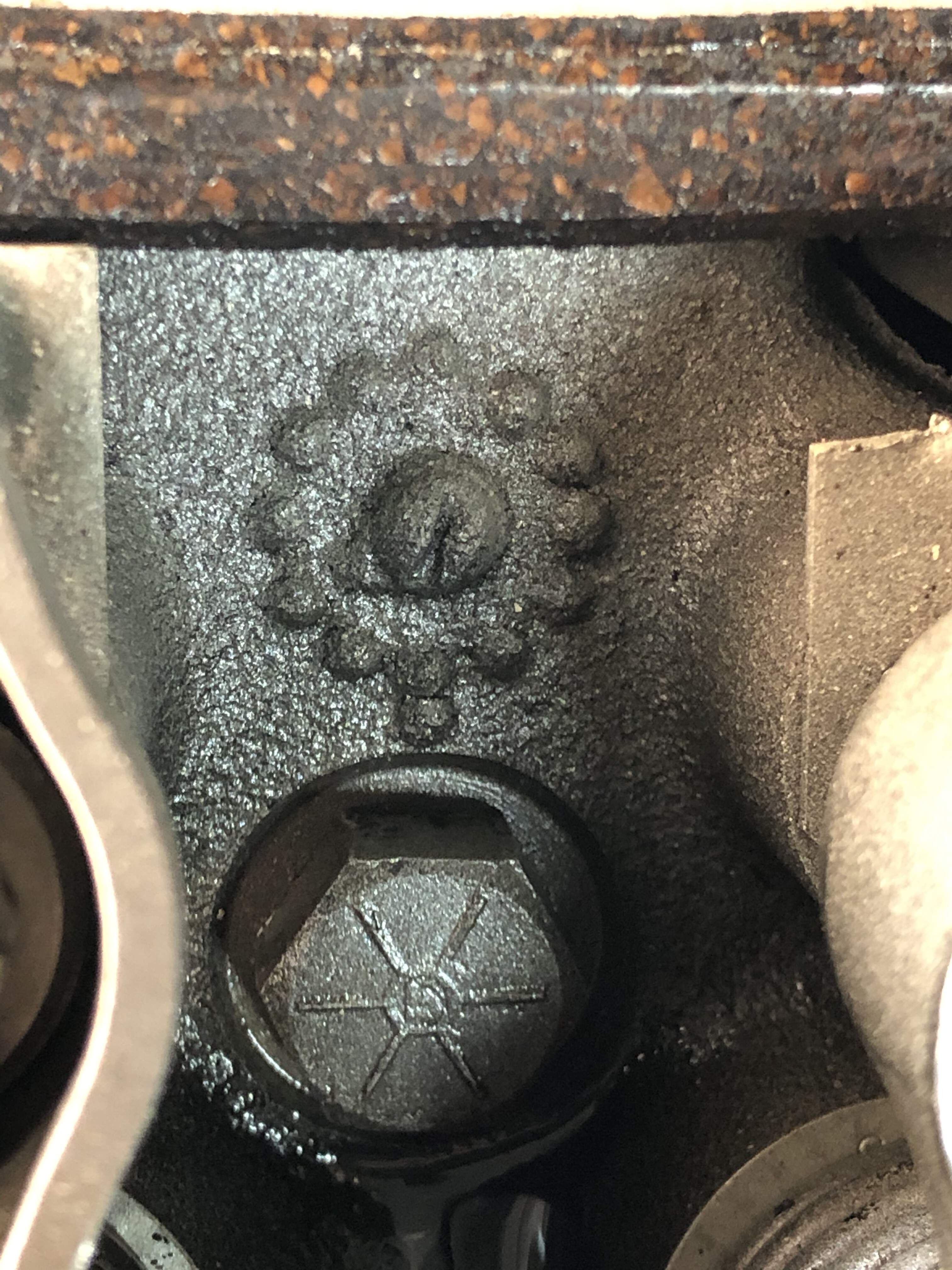

After reading the HP difference between those 2 heads I'm curious to know what heads iv got. I'm looking at the pics of when I put it all back together and there's multiple numbers on it. Which or where are the set that I'm looking for?

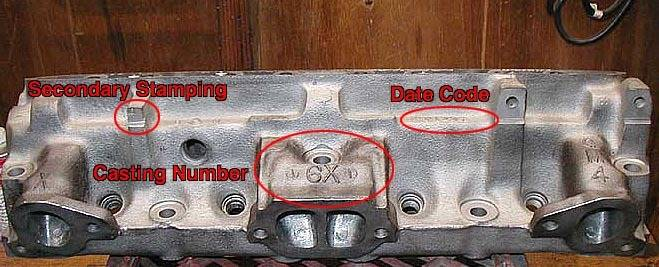

Wrongway - see the photo below. Let us know what you find. The Casting number is key here.

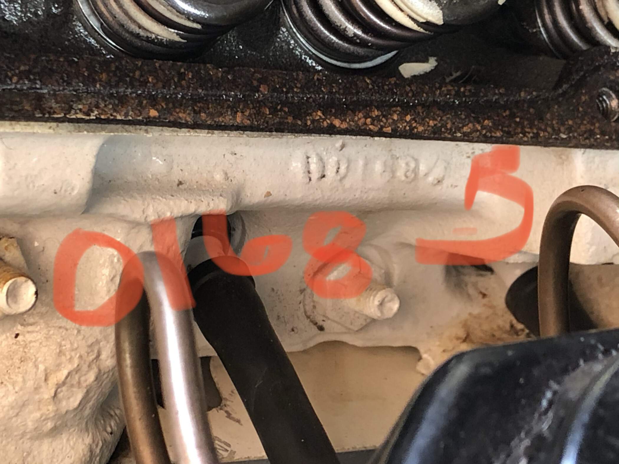

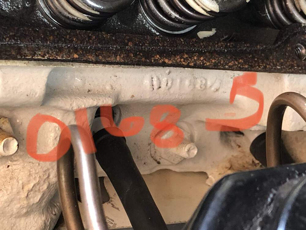

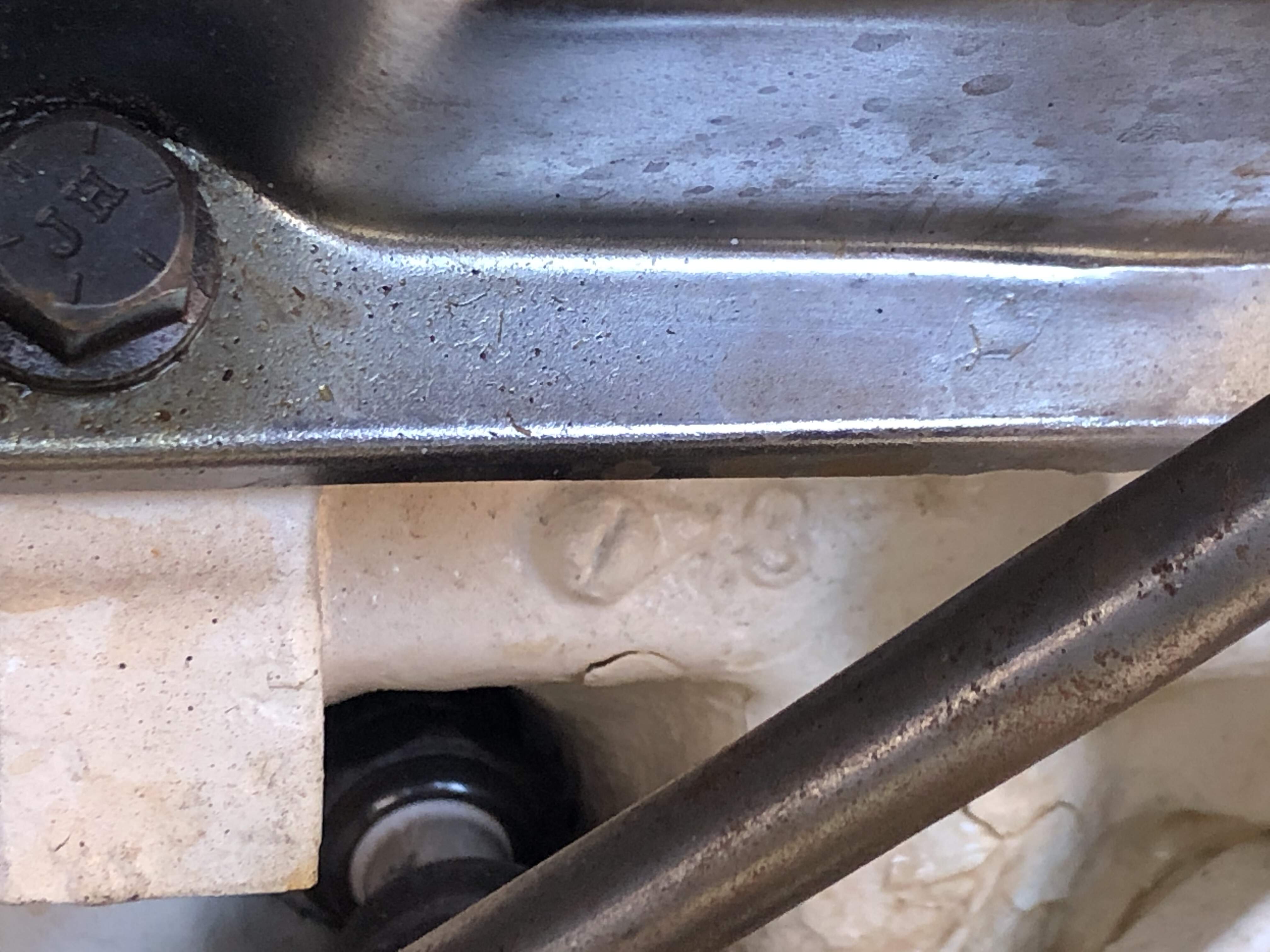

Ok Frosty, that looks like a 3 to me.
0168?
That is under the valve cover on the head right above the center bolt
Hope that helps Frosty. If not I can remove paint if need be or take other pics. Just let me know. Thanks again bro

I agree that the heads are definitely 1968 based on the date code. The head identification is not clear based on the given pictures with only "6" showing. Now that said, it can be one of two heads for '68 that ended in "6". On the Ram Air II GTOs was the "96" head. I doubt that this is that head. The reason I say that is because Wrongway states this is a 428 engine.
A 428 in '68 would have had the more common "16/216" head. This head has the more desirable 2.11" intake and 1.77 exhaust valves. This head was installed on all the 400s and 428s except the RAI and RAII engines. The RA I heads were "37". So it is unlikely to be a RA I head.

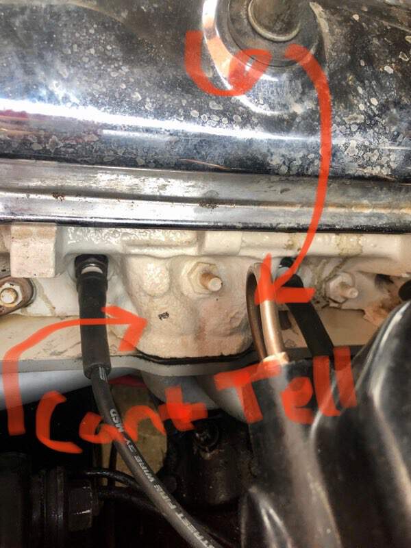

Wrongway, check both heads for numbers on the center exhaust ports, I suspect there is "1" and a "6" if you look closely.
A 428 with "16" heads back in the day (1968) was rated at 375-390 HP.
Ok Frosty, on both sides the numbers are unclear do to the paint. But if you run your fingers on the ports I did feel what felt like a #1. I can say for certain it was not a #9. I didn't want to say that originally because I was unsure. When I had the heads rebuilt the machinist did say they had 211 valves and that if it were him he would just rebuild them with new parts but not change anything. So that's what I had him do. Is there anyway of guessing the HP and torq with the cam and other things iv done? His guess was between 406 and 410. the whole 406 number just seemed odd to me lol. Especially when he didn't know what cam was going in. Thanks again Frosty
