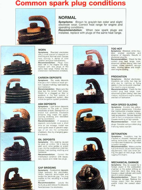

I would start with the basics. I would check the timing and make sure it's within either stock specs, or your engine builders recommended spec. Next, could the engine be way too lean or way too rich. You can adjust the carburetor accordingly. Check for vacuum leaks or unplugged hoses or ports on the carb or intake manifold.
If none of that helps, pull your spark plugs, they usually have a story to tell.
