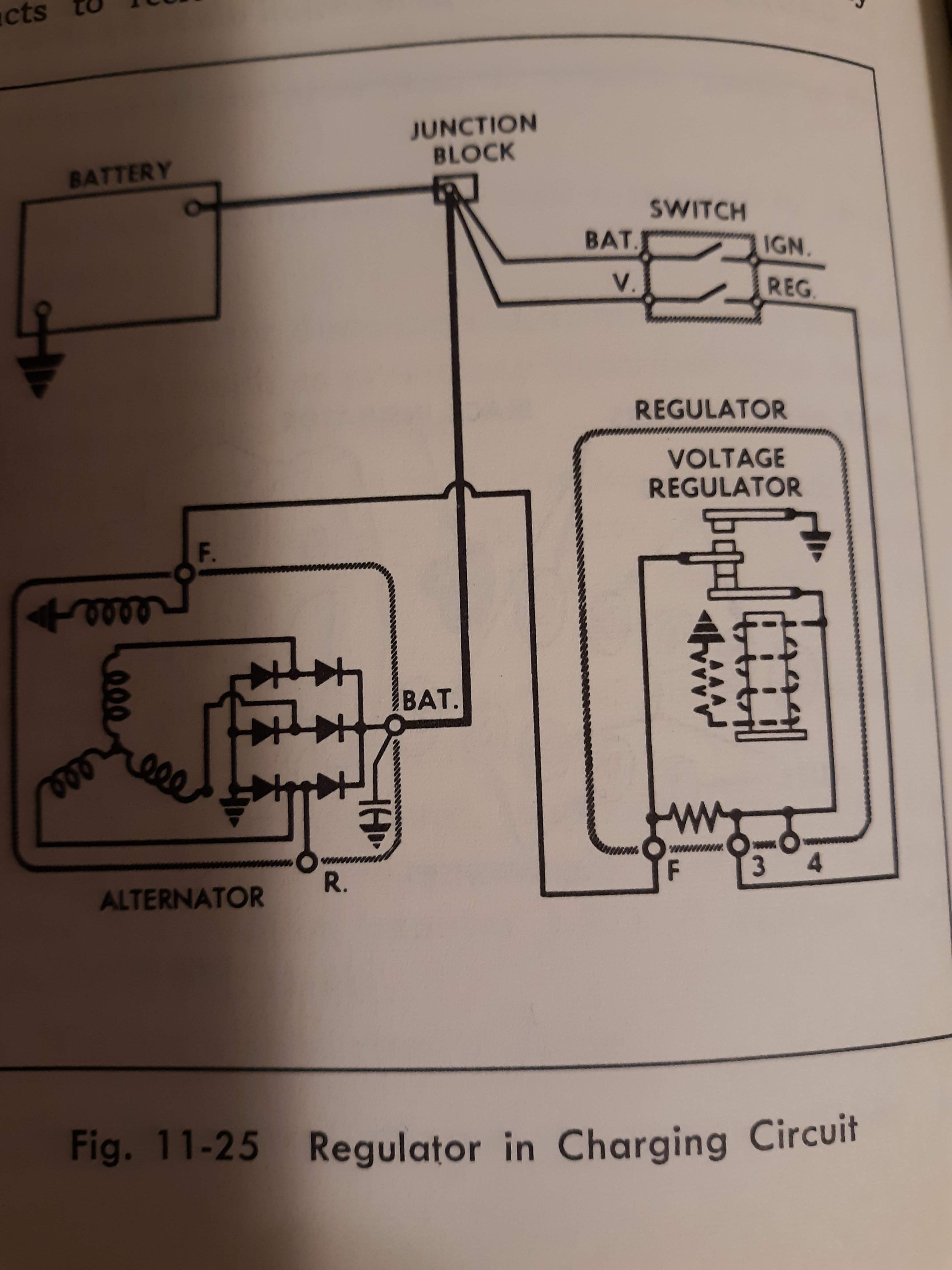

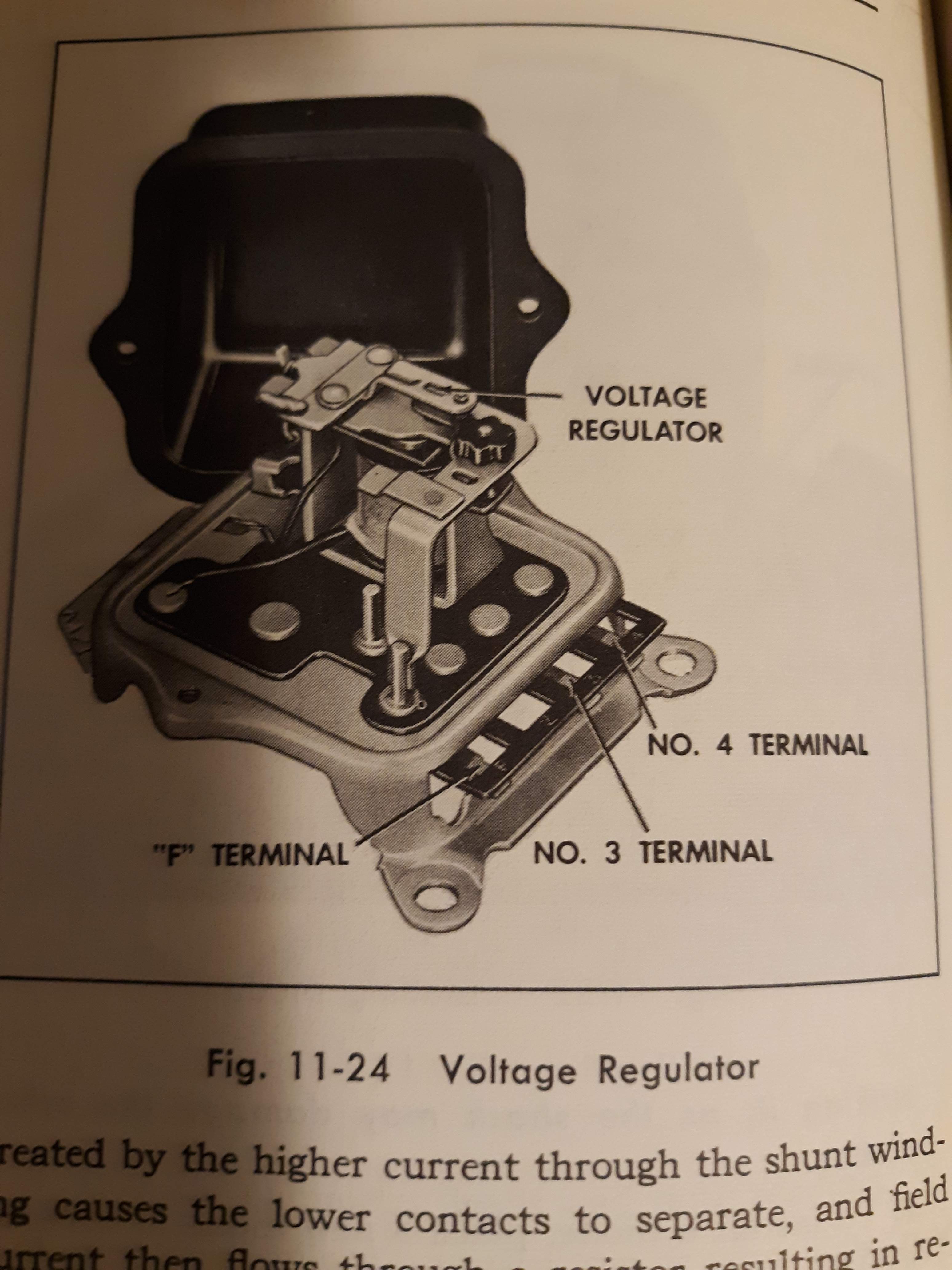

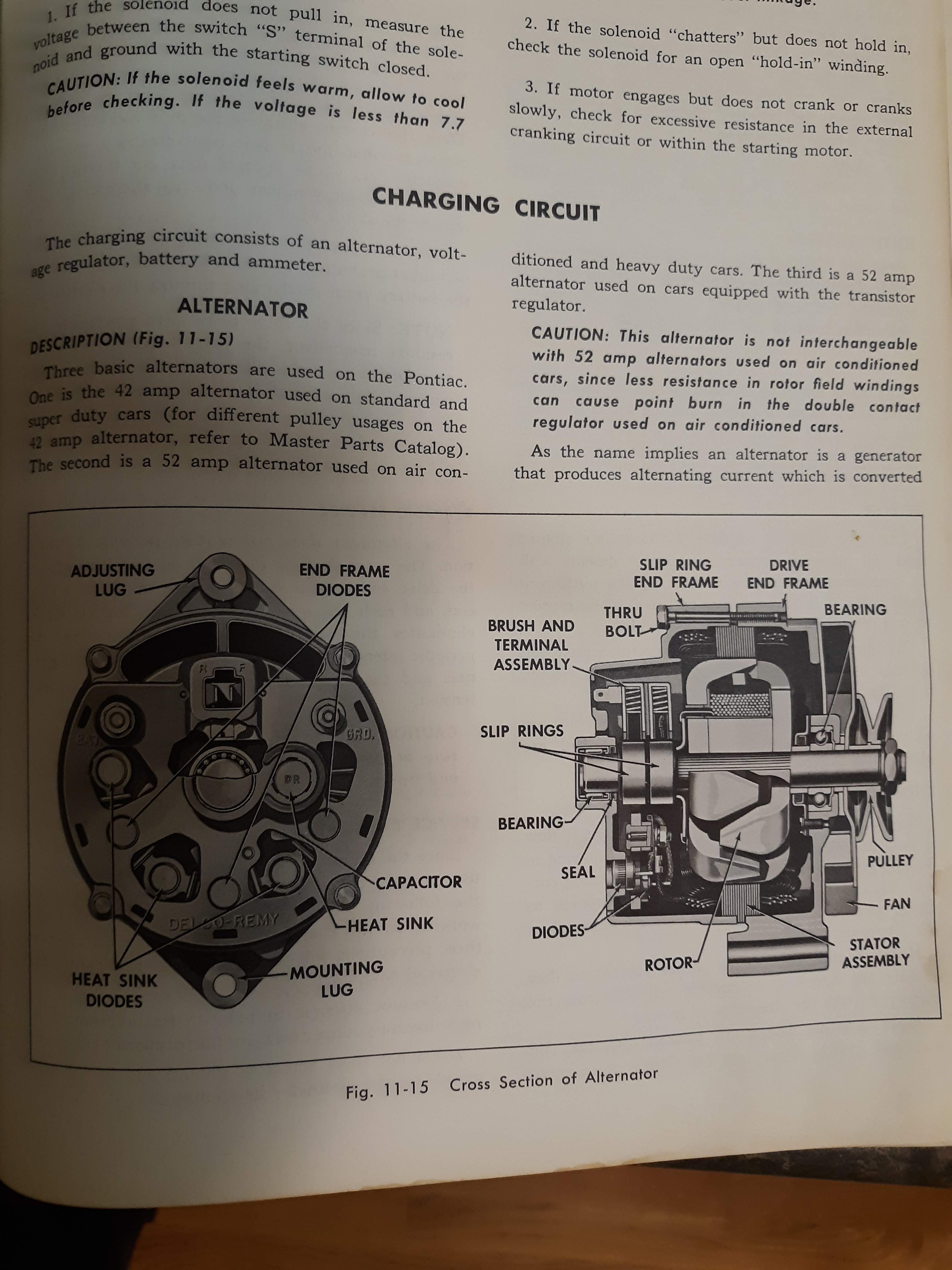

I Have an actual GM factory pontiac manual from 1963....(not a reprint) has at least 15 pages worth of info on how to trouble shoot ,test and repair the whole complete charging system...Adjust the voltage regulators Both types  standard and transistorized voltage regulators...Complete wiring schematics.....Tried to take photos but they ain't coming out clear and legable with my phone..I have a way that I can scan the pages and send them directly to your Email..If that is something you would be interested in...

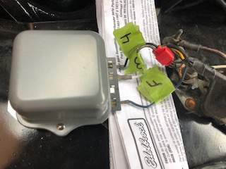

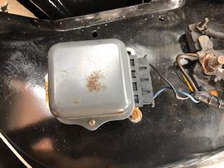

 Its an external voltage regulator bro. I called the alternator manufactures tech line and ran a bunch of tests. I think you're on the right track with the regulator bro. I don't think that the alternator is getting excited. The plug on my regulator is marked  F 2 3 4  indicating each terminal. Terminal 4 has power but terminal F does not. The tech said that both should be hot. It looks like the blue wire at terminal F on the regulator goes to the R terminal on the back of the alternator and nothing is plugged into the F terminal on the alternator. I asked the tech if that was connected correctly and he didn't know. Seems to me that the F terminal on the regulator should plug into the F terminal on the alternator, but I don't know that may be too logical lol. The voltage regulator is still under warranty so I had the parts house order me another one and it'll be here tomorrow, figured it couldn't hurt. Any idea what plugs into the R and F terminal on the back of the alternator?
It appears to me looking at the schematic that the F terminal on the regulator does connect to the F terminal on the alternator....The #3 terminal on the regulator runs through the ignition switch...and would be hot with the key turned on...The #4 terminal is used on cars with a radio.... A condenser is connected to #4 and is not used if there is no condenser.....this is the diagram hope you can see it clearly
Great pic bro, so I'll hook the F to F tomorrow after I get the new regulator. My car does have a factory radio so I'll keep terminal 4 hooked up, but I don't remember anything hooked up to terminals 2 or 3 so I'll double check that also and then retest and let you know.

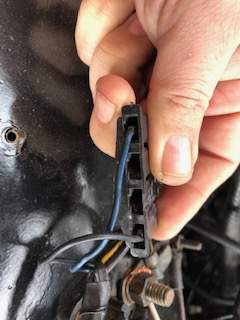

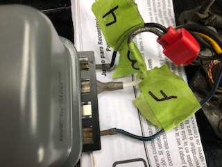

Ok so I replaced the regulator and still only had 12V at the alternator. I DID NOT have a wire in terminal 3. I couldn't find one loose or laying around either so I connected a jumper wire from the #4 terminal which is 12V keyed and connected it to the #3 terminal. The blue wire F terminal is now hot when the key is switched on as it should be. But I still only had 12V at the alternator. Once I moved the blue wire (F on regulator) at the R terminal to the F terminal on the back of the alternator she got excited. I checked it again and 14.5V at back of the alternator! I'll post pics to help explain everything.
