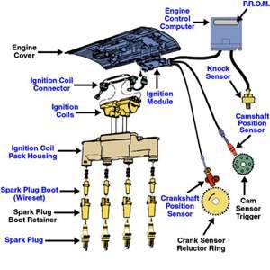

2.4l twin cam. No mass air flow. It kinda has wires (springs in boots) .. it coils are just hide from sight . Yes replaced wire set one bad coil pack and spark plugs.

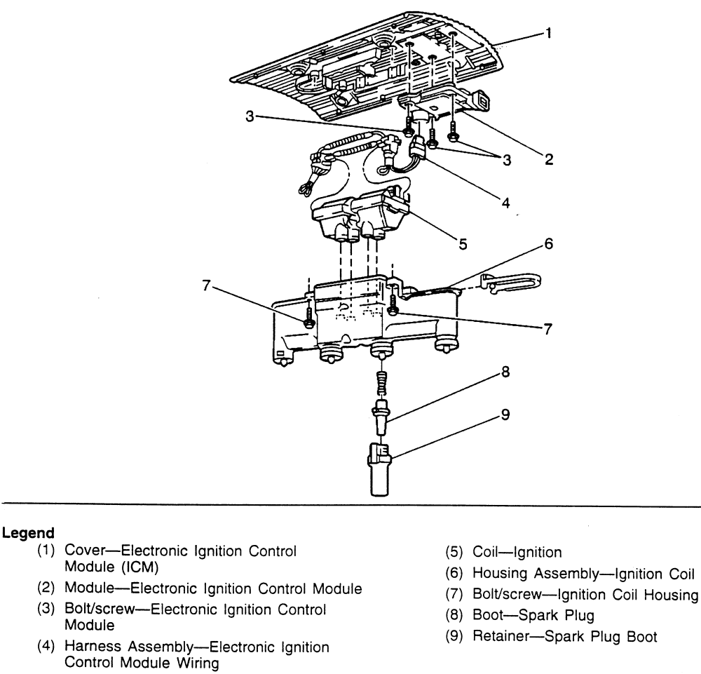

Those are known to get cracks in the coil housing you need to turn in over and inspect it for cracks that is your most likely cause. I'm going by memory on this but I'm remembering a fuel pressure regulator on the fuel rail with the car running pull the vacuum hose of and make sure no fuel sprays out if it does replace it. If that is good check the fuel pressure under load, I dont think that is your issue though since under load it would it would miss worse then at idle.
My money in on the coil housing
Ant
One coil pack read 10k ohms one pack reads 6k ohms physically they seem fine. It could be the housing ill have to get one to try it out. The one I have I pulled from a junk car. The one that was on the car didn't read at all out of one channel. The one I have now reads fine seems fine and I could tell someone replaced it cuz it had a sticker on it and was a different color. Doesn't really mean anything tho. Cuz you know it could have a hair line crack and a volt meter doesnt touch 60,000 volts. You know. I see what you mean about the fuel it would make since ... Since more is req to go faster. Thanks 🐜 ant
