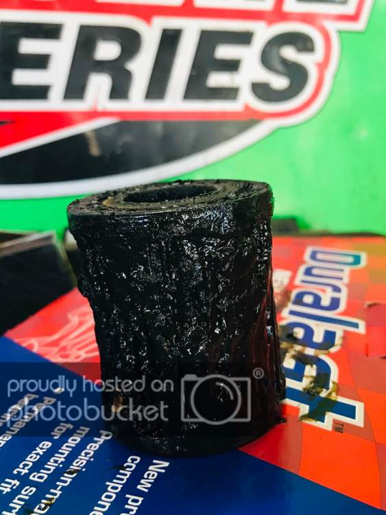

In other news, came across this filter on one of my stops today that came out of a Toyota Camry with 147K miles on it. This could possibly be the original filter.
