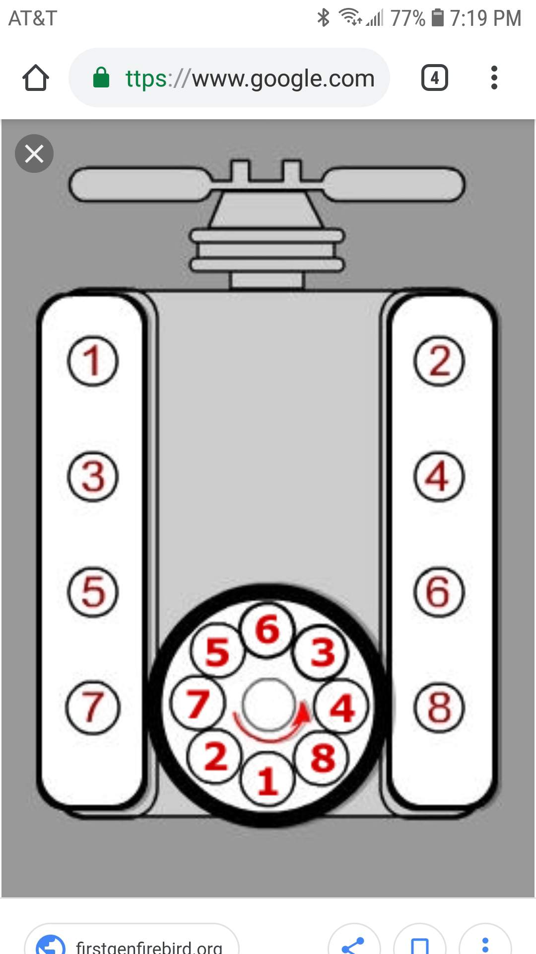

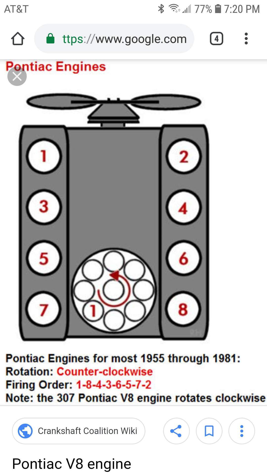

I didn't get an opportunity to check for spark after I rewired the distributor since I was by myself, but I know I need to do I can at least check that box off. The fuel pump was replaced and it is moving fuel so I know that part is working.  I can't even get it to try to fire, I tried finding a diagram or picture to confirm exactly which port corresponds to the #1 cylinder to make sure I do have things in the right order but i wasn't able to find anything clearly defining, like the #1 plug is "x" ports clockwise away from the rear cap screw or something similar.
In regards to the two auxiliary wires on the ignition coil, does the positive or negative wire go to the distributor?
Thank you
Can either of you tell me which one of these diagrams shows the correct #1 distributor location?
Update: I moved the distributor wires one port counterclockwise to match the diagram that showed the #1 port in the very back, I'm now getting puffs back thru the carb, no firing yet, but this is at least some signs of life!
