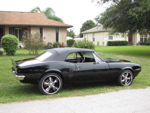

I have a 69 428 stroker/455 crank Dport heads, 4 speed m-21....in a 67 firerbird convertible...its a ground up restoration ...just cant get it to run cool...always 220 or higher especially if I step in it...I have a 4 core alum rad...elec fans...checked the water pump..timing etc...any suggestions...im told maybe a block restriction?....giving up hope...lol...may just bite the bullet and drop an LS.....anybody have any ideas....
Sweet Car!  Off the top of my head i would of mentioned timing but since you have already checked that, gotta ask the basic, have you tried changing your thermostat? Ive seen brand new ones stick and restrict and its a cheap thing to try.  I have also seen restrictions come from intake gaskets with  blocked off ports.
