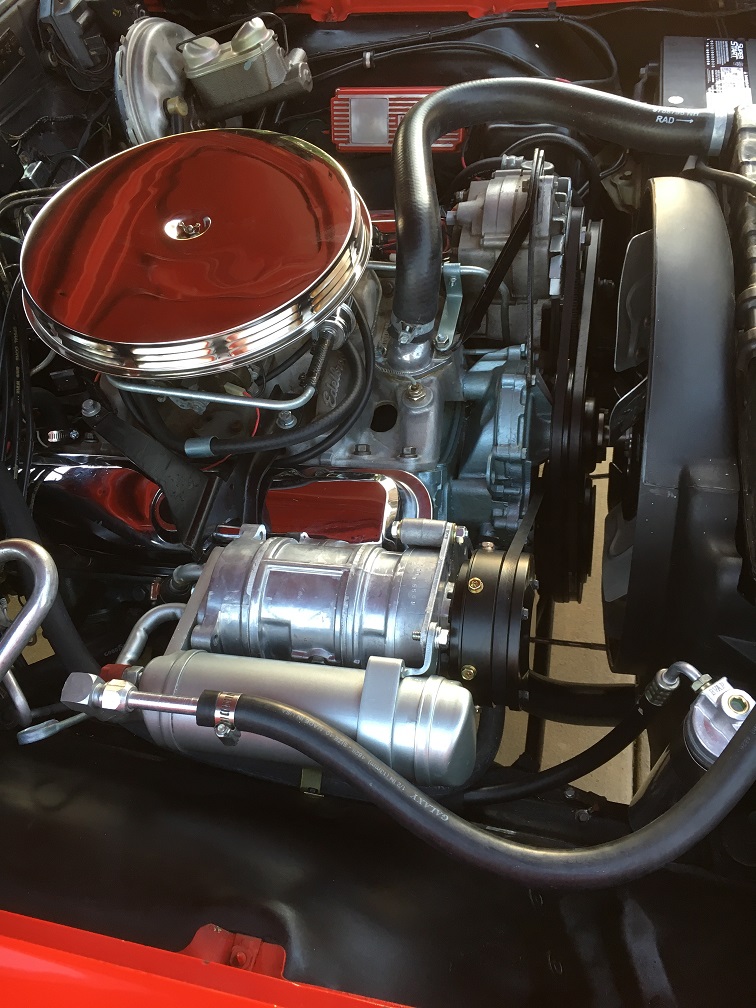

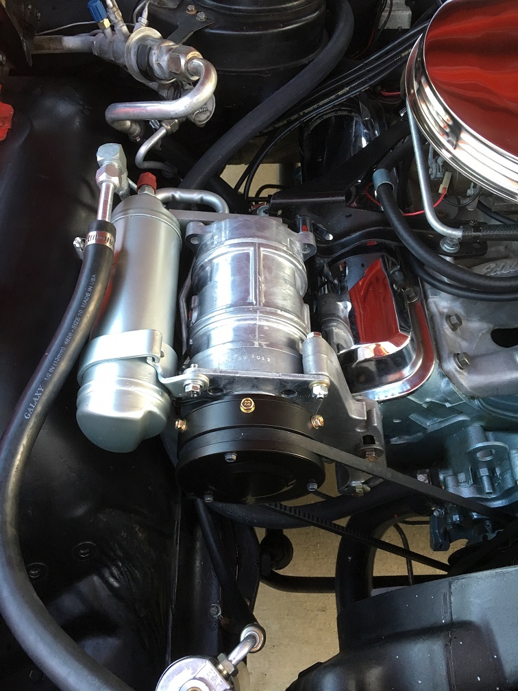

After a few weeks of ordering compressors and trying them, I finally found a true bolt on replacement. Be aware if you're interested in replacing your old GM A6 compressor with one of the modern aluminum body compressors that the Four Seasons style from Summit Racing will require modifications. The muffler mounting on the back of the Four Seasons style compressor is higher and causes issues with the rear bracket that goes between the compressor and the intake manifold. While it physically fits the aluminum bracket on the front and the lower triangle bracket, you will not be able to use the intake manifold bracket or the muffler mounting bracket.
I purchased a Pro6ten compressor from OldAir (manufactured by SunAir) , installed it over the weekend with new hoses and drier. Charged the system yesterday with R134a refrigerant and all seems to be good for now.
