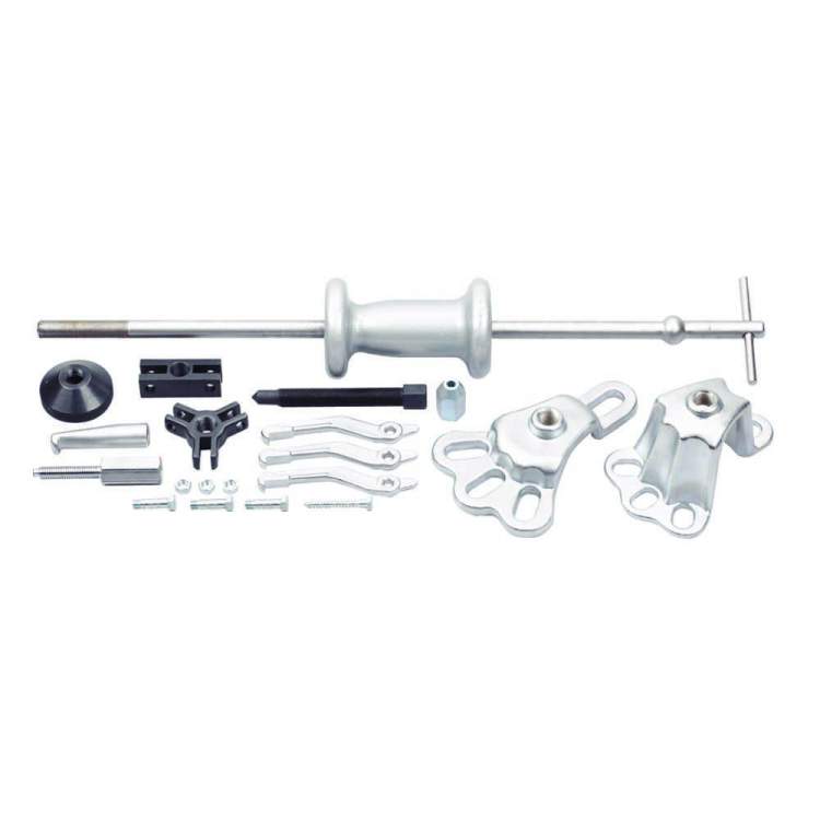

Rust is preventing it from coming off easy. You should soak the seam in rust penetrating lubricant (3-1 In One, WD 40 Rust Penetrant, etc.). I would recommend renting a slide hammer and bolting it to the hub to pull it off. Check your local auto parts store to see if they will rent you this tool. Otherwise you will have to hammer it off as best you can like they do in the video below.

Thank you all !   it's done:  i did it as the guy on the video:  WD40 and hammer.
