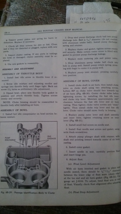

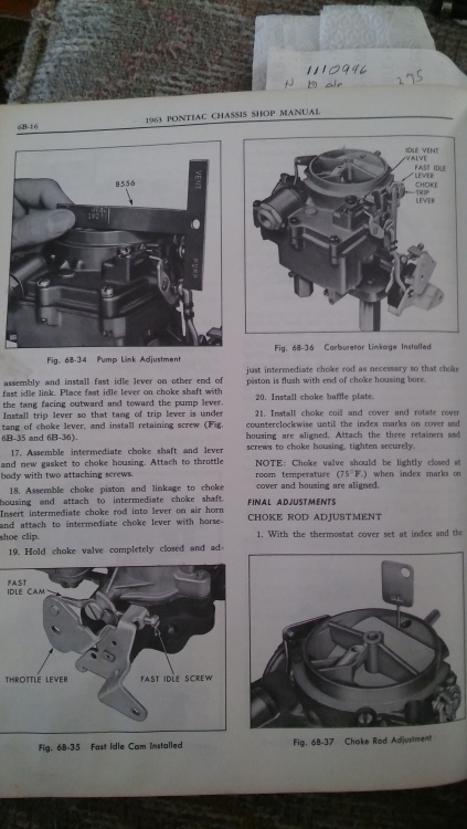

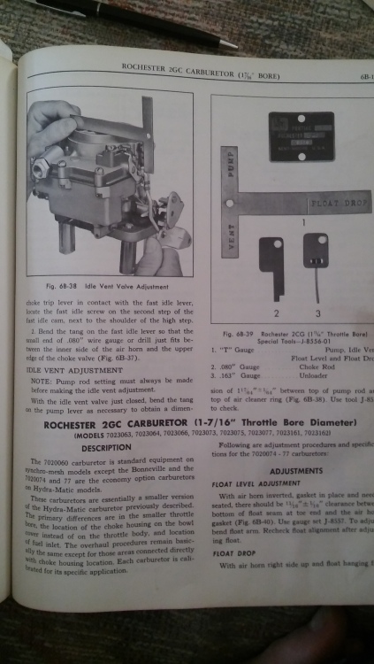

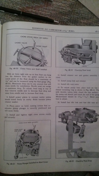

The carb is a 2GC Rochester 7023060, I will forward all the other numbers when I crawl under it some time in the not too distant future. The saga continues.
