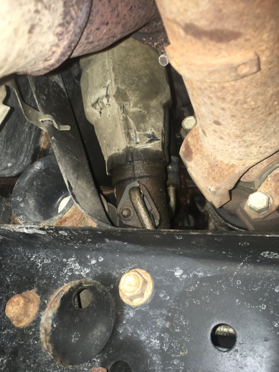

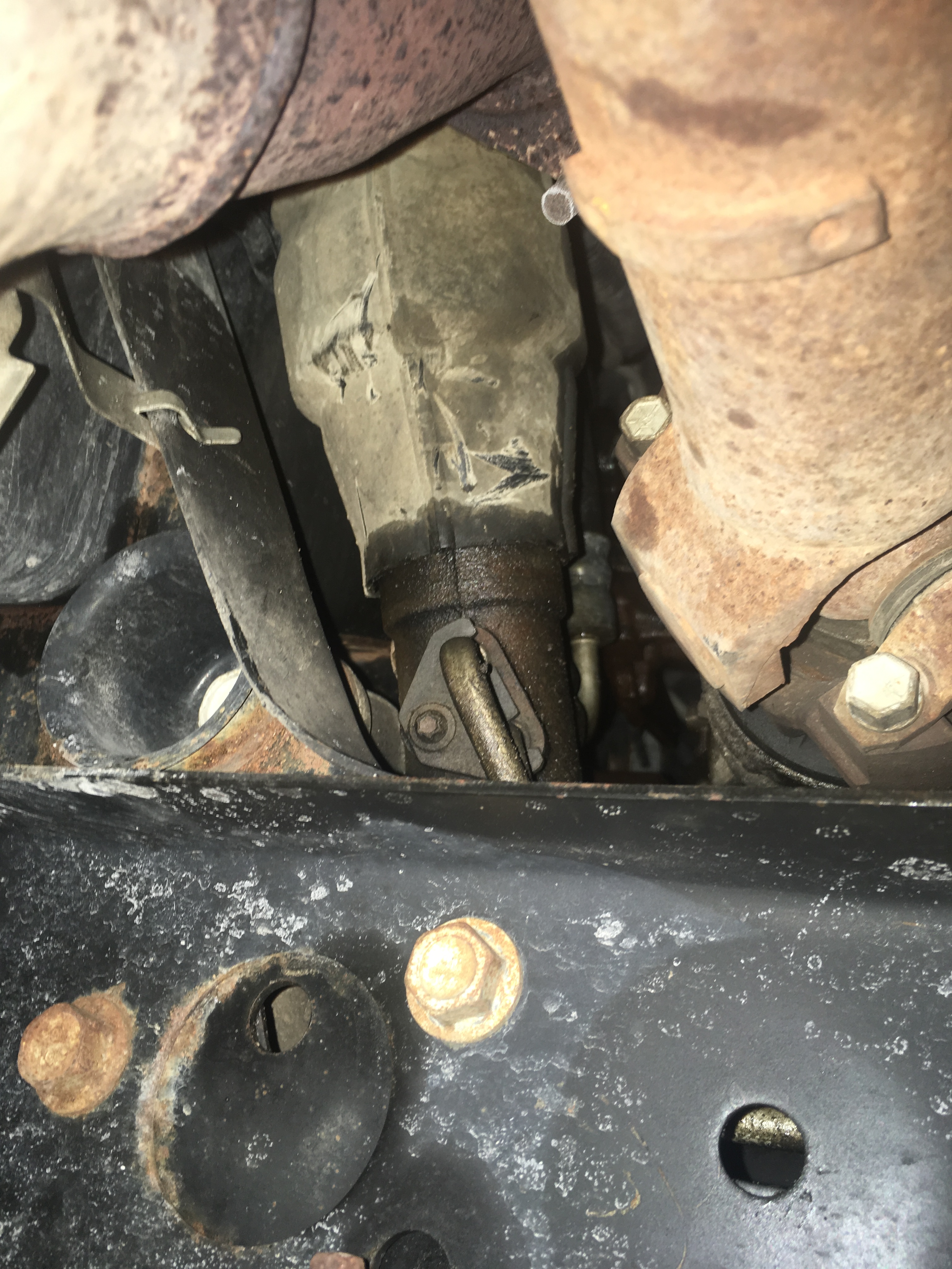

I think we've found the problem, it was not bad farting either. I will to give kudos to Havoc as he was close but it was not transmission fluid that was burning. I took the Envoy to Tuffy today. It took six guys at two different Tuffy shops to find the problem. It appears to be the front differential-to-axle seal, on the driver's side, that is leaking. When the axle spins, it is slinging the leaking diff fluid onto the bottom side of the driver's side exhaust manifold and it burns the fluid. I only smell the propane smell at idle or near stop conditions, and not at speed because the speed of the car blows the burning fluid away from the interior air pickup. The leak is not bad enough to leave puddles on the driveway either, so there was no clue that I had a leak at all until you got the car on the lift.
So now most of the front suspension has to come apart in order to pull the front diff out and replace the seals and add back the lost diff fluid. So that is a couple hours worth of work to put the diff on the bench and repair it.
Looking from the transmission back towards the front of the car, you can clearly see how wet the driver's side exhaust manifold is.

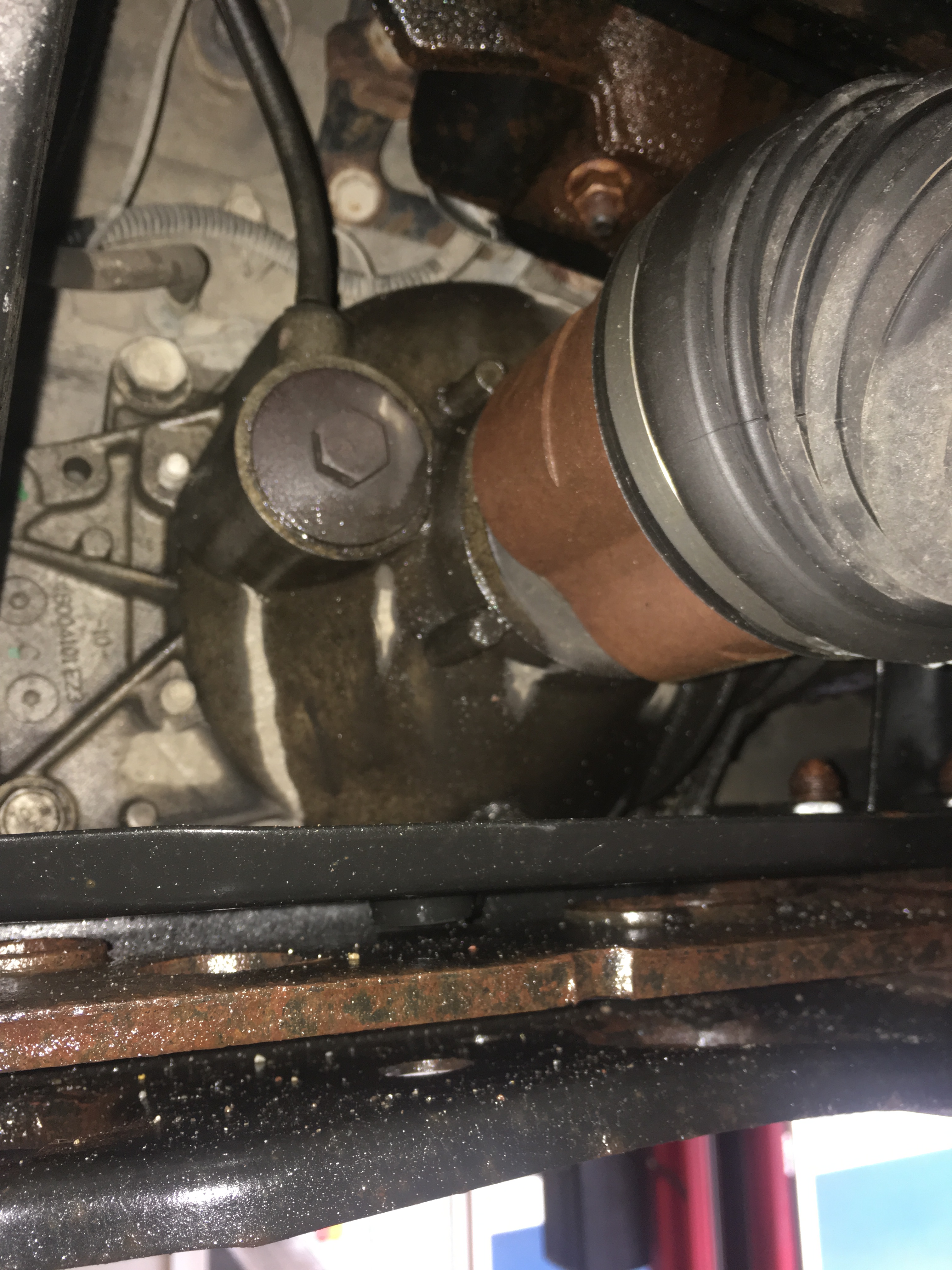

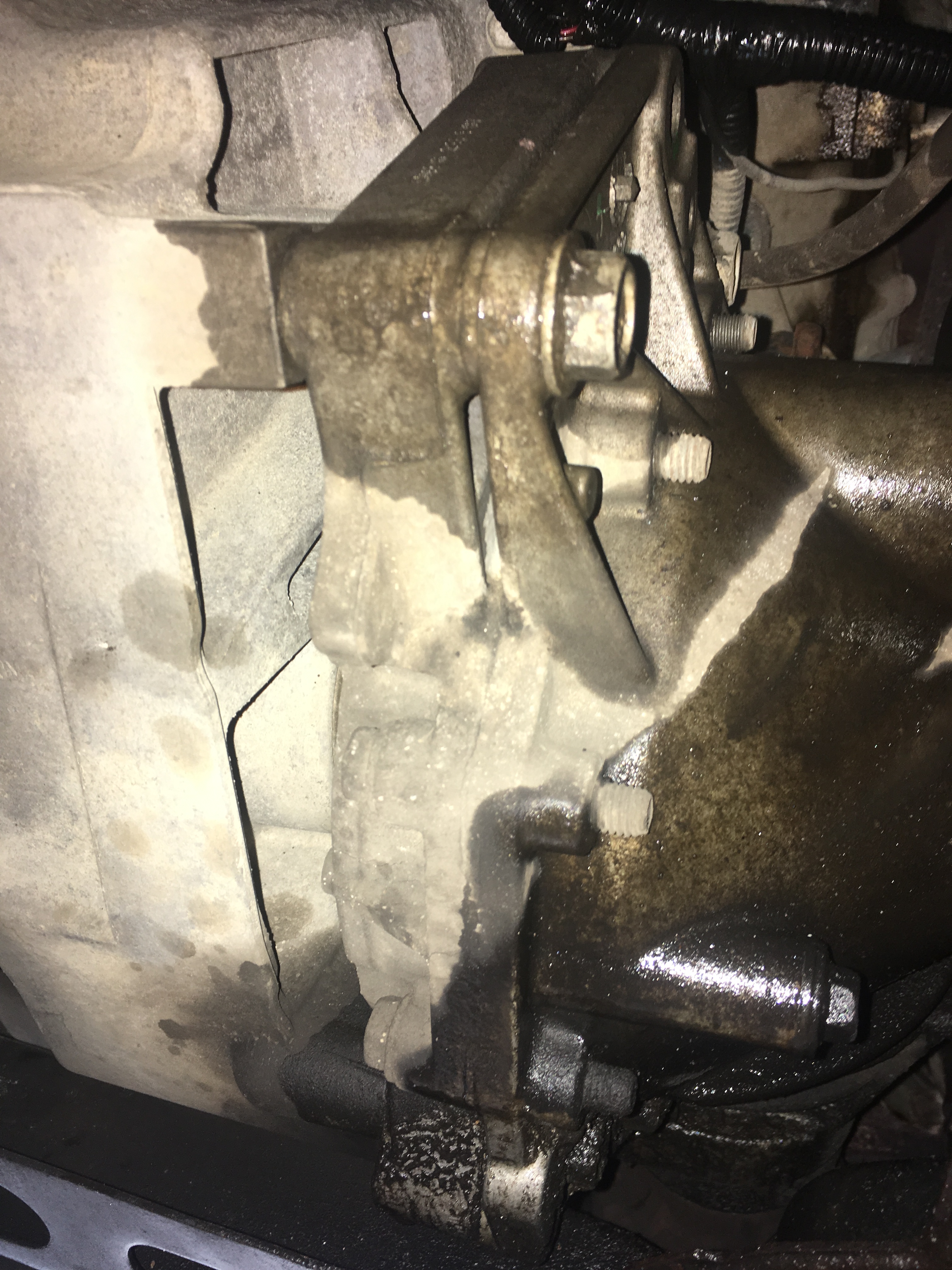

Looking at the driver's side differential / axle assembly, you can clear see it has been leaking.

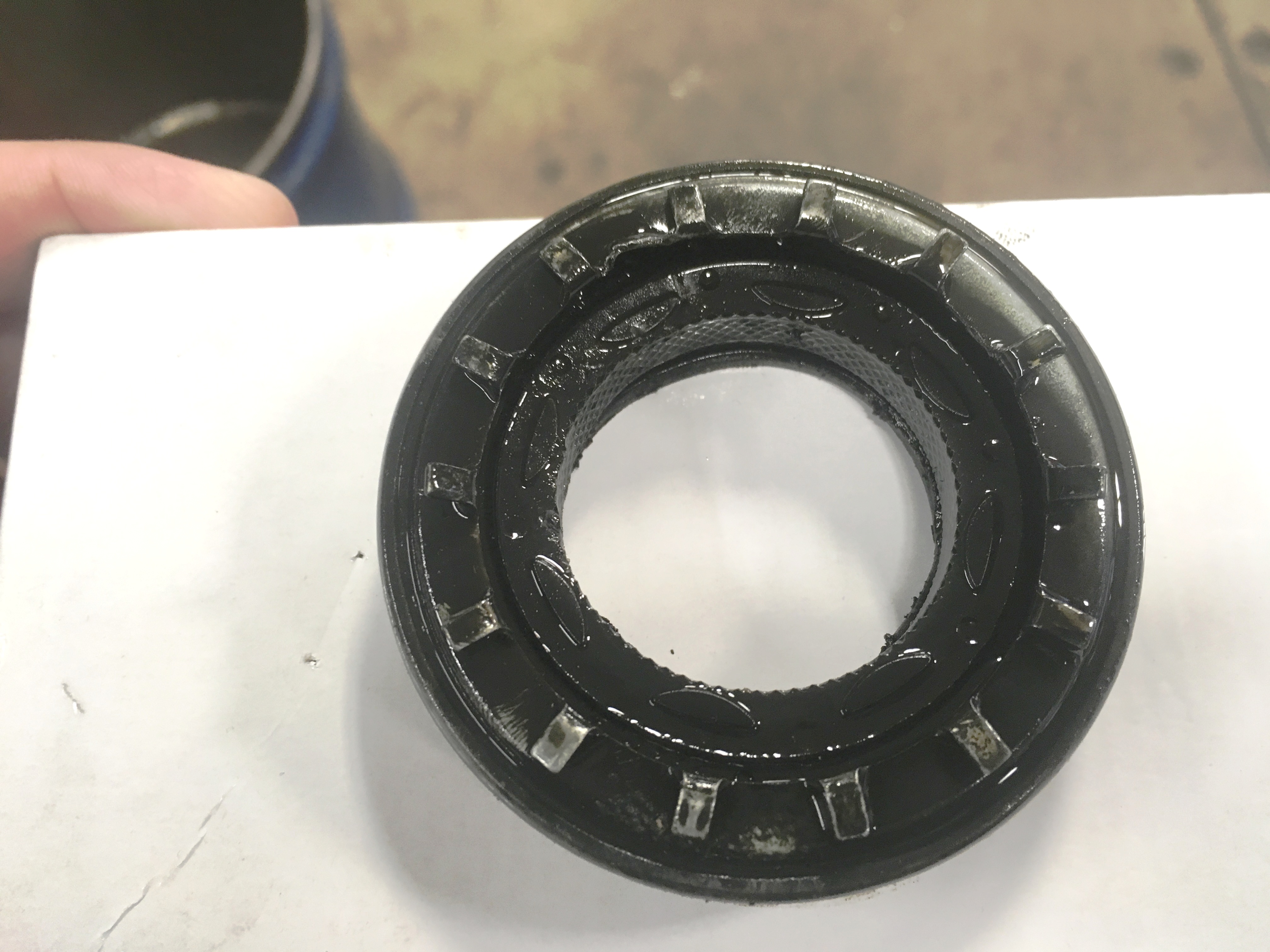

Here is the ruined differential-to-axle seal. It doesn't look like much until you are holding or you are standing next to it.  Holy Mackerel does this thing stink ! That is why I am holding it on a box. So it does not get on my skin or clothes. It is saturated with burnt synthetic diff oil. It gave me an instant headache from smelling it. It was like the smell propane, burning tires, dead fish, and poo gas all at once. Take my word for it, it was seriously nasty bad!
