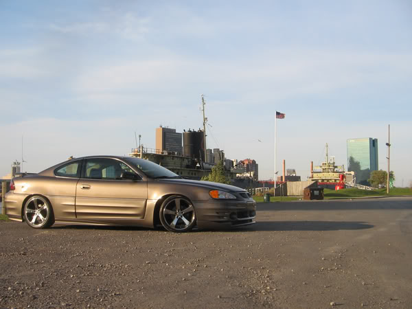

2004 Pontiac Grand Am SE
Looking to put some different things on it. Give me some suggestions!
SC/T lip kit+hood+spoiler(although the actually SC/T spoiler doesn't look like this one
AT Italia Inox's
By far the best looking rim for the grand am. Good luck finding some though. some others for ya.
Eagle alloy 077 Also good luck finding them.
These headlights
hard to find, have to buy used so new you can get these. Black housing with the amber corners
And i'm done.
More rims
Gallery of Grand Am's to get ideas of what to do
I've always wanted to go SC/T.
Wheels, you have to pay to play for nice wheels. Black housing, clear corner headlights are hard to find. Amber corner, black housings are easy to find, though.
