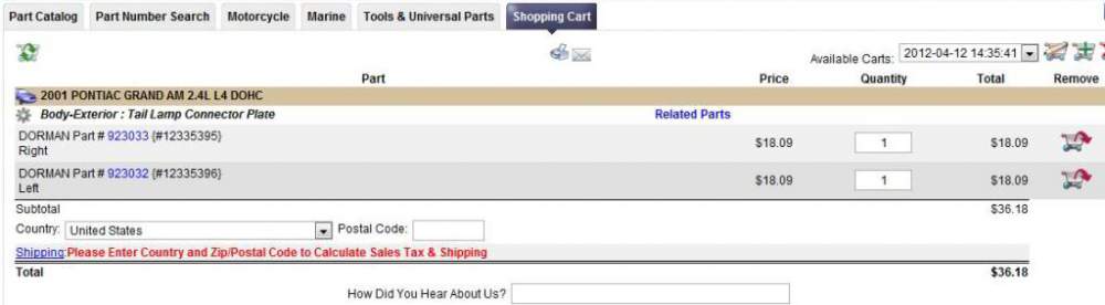

Did some quick searching on Rock Auto:
$36 for BOTH socket boards before shipping. I paid $25 each when I was still working for Autozone.
Pic references:
Get to it! Make sure you buy new bulbs as well for the new sockets, start fresh!

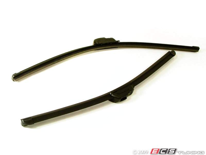

Pic:
Shown are the blades I have on both my Pontiac and Mitsubishi: Bosch Icons. Usually run $42 a pair at normal prices. If you go to an AutoZone or Advanced Auto, they have them on sale most of the time.
Sizes for the GA are:
Driver's Side: 22 inch
Passenger Side: 17 inch
